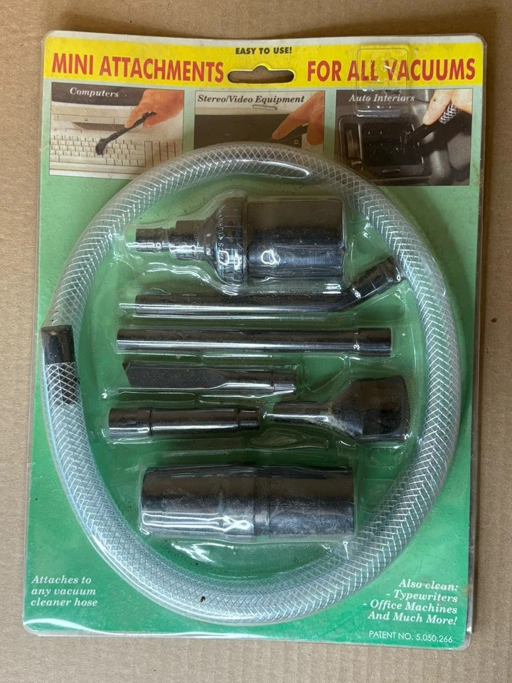

          This will do it.

            Also good for cleaning the coils under the refrigerator! (I tape it to a yardstick)

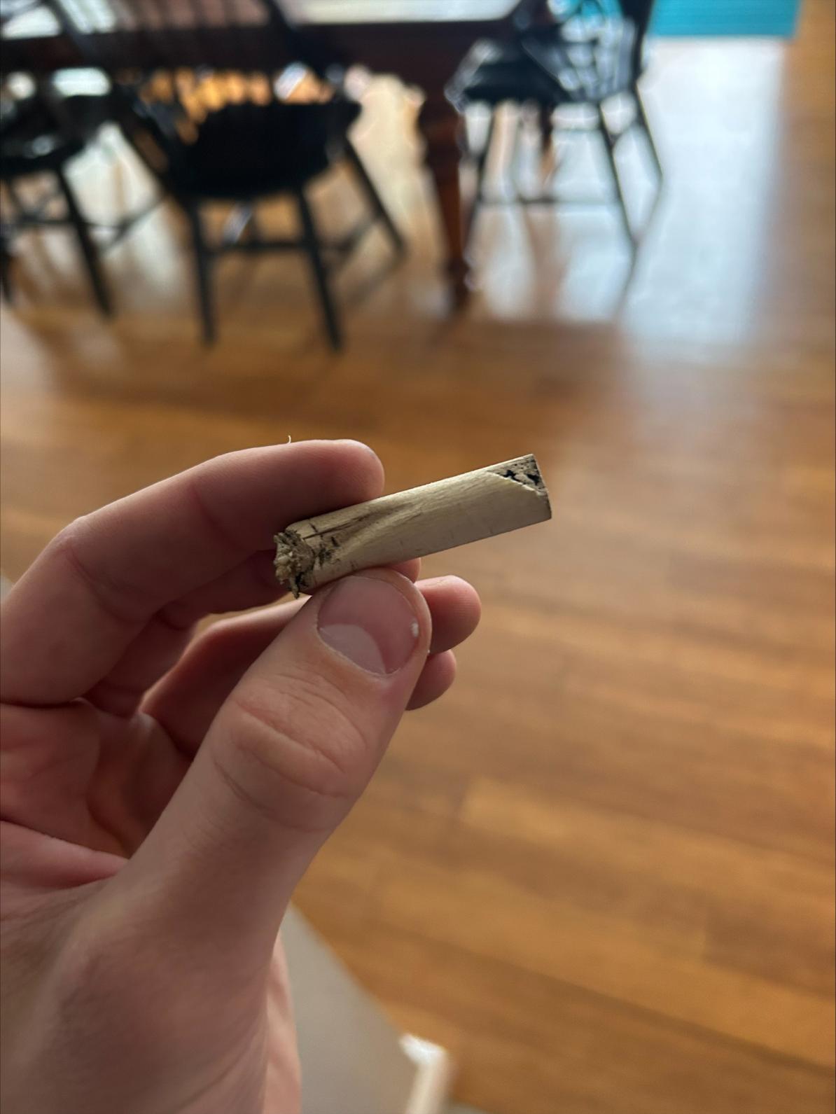

                        Update: had some time today to work on it and finally got it out. I ended up getting a borescope and using it to find where the dowel was. Turns out it was wedged between the valve and the piston head, so i took off the stator cover and turned back the pistons using a wrench on that bolt. This freed the dowel. After that, I used a shop vac with a funnel on the end which brought it vertically up to the hole. From there I tried to hook it with a small pick, but it fell back in. Luckily the piston was in just the right position, so when it fell it stayed vertical, pinned between the piston head and the pick. I was able to hook it into the wood and pull it out. It was much bigger than I thought it was so I'm glad I didn't try to wood chip it. I really appreciate all the helpful tips.
