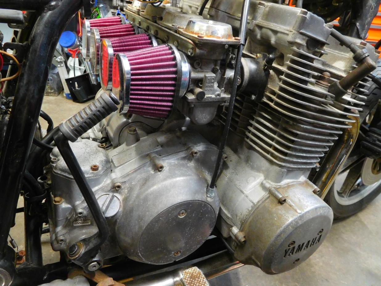

        • 1814

          Thanks for the picture

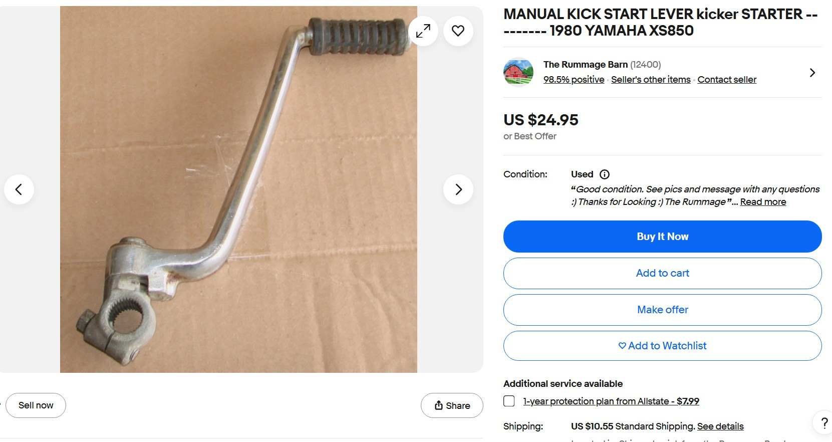

            Have been looking on eBay, they are like gold dust at the moment.
              • 1814
                • 1814
Name:	XS850 Kicker.jpg

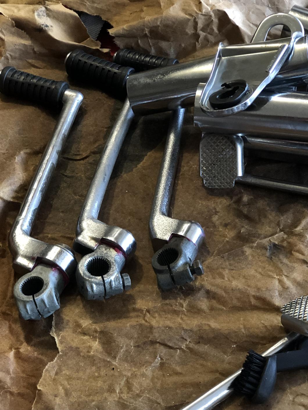

                  • 7941
                  I’m not positive the boss is the same. If it is, the XS650 kicker is a good option. XS650 had three different ones. The earlier kickers are the robust straight ones.

                    Thanks for the tip, I messaged the ebayer that DEEBS11 sent, whether they would ship to the UK and how much, but no reply. I will hunt for the XS650 kickstart. Cheers
