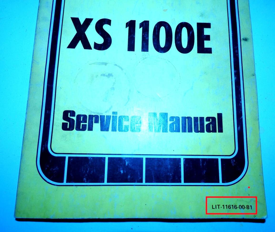

          Ray, is this the part number for the original manual?

            • 7817
            Yes, it is. Mine is the earlier version, with the LIT on the left, and 2H7-28197-10 on the right bottom.

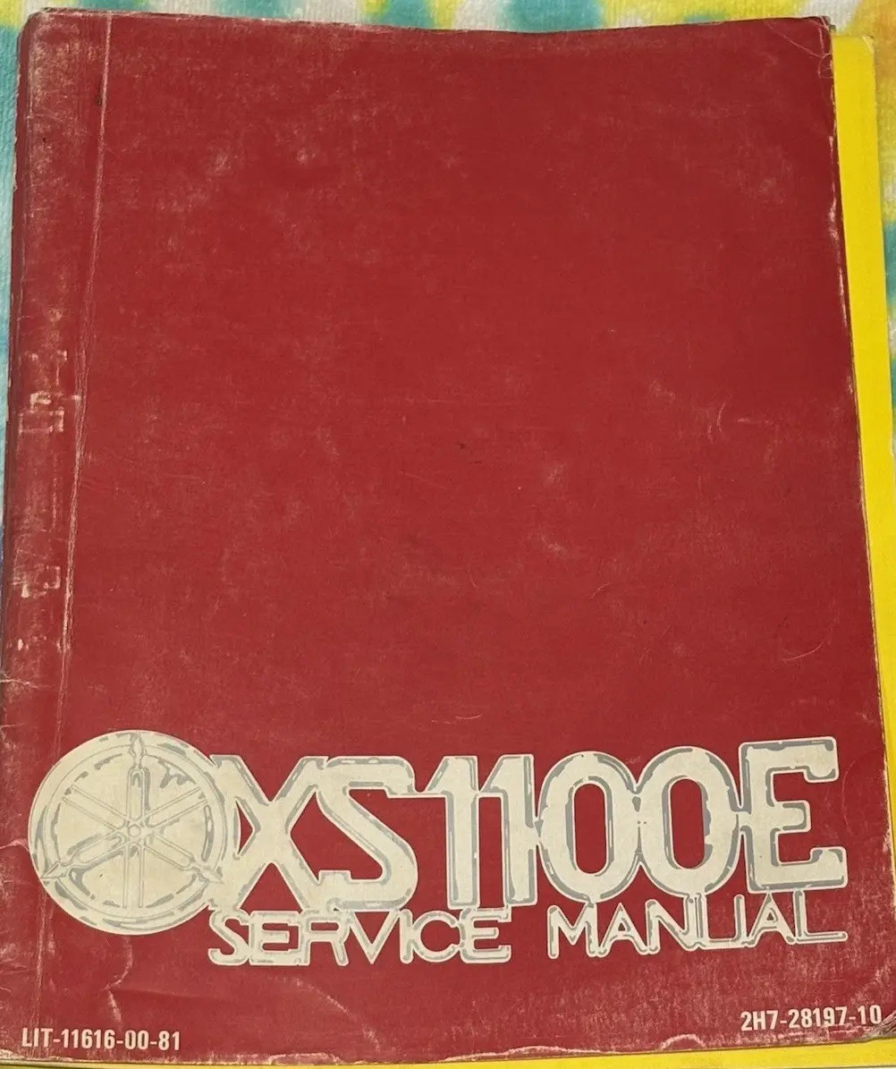

              • 2010
              Thanks Ray.
