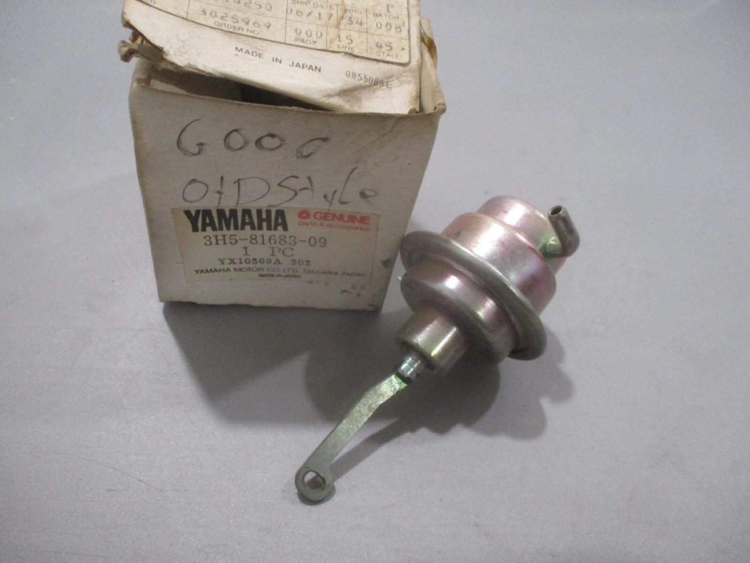

              https://www.ebay.com/itm/35712078384...Bk9SR_rLq9q7Zg
