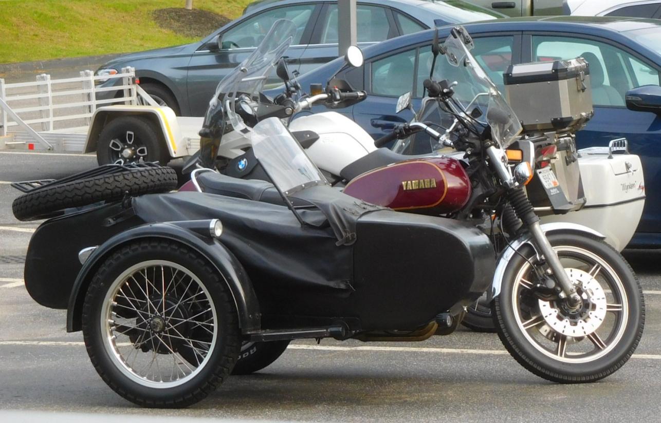

                  I have been running EBC floaters. I like them.

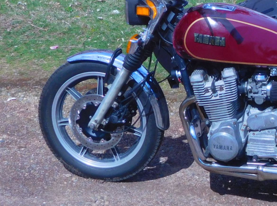

                        LAB3, I had installed the Chinese Niche rotors and they worked well for a few thousand (but under 10 thousand miles) but then became warped. I had to retrofit them with the EBC units (which may warp too, only time will tell).

                          Yeah, it was your report that steered me clear of buying them. My rear rotor was eaten up pretty bad and I took the chance on getting a used stock unit off eBay which is what I'm running now.
