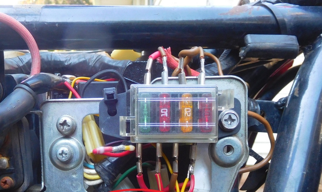

    You are going to be much better off going with the one Phil recommended. It is the mini blade version and fits in the same space as your original fuse holder. Easy fix for the fuses that are located there. I used a mini blade inline fuse holder to replace the main fuse on the right side of the bike and just used some solder joints and shrink tubing to secure it in the original holder so that it could be hooked up right back where it is now. Can just as easily be relocated to the six fuse holder that Phil posted. I also found that the small angled slip on connectors gave me more room to work with when connecting all the wires to the fuse block.

          I get those confused. Thanks for the clarification. I do know the connection box you suggested is the same one that TC bought a supplied for quite a while. It fits nicely in place of the old fuse box with just a small modification to the base to screw down to the original location of the old fuse box.

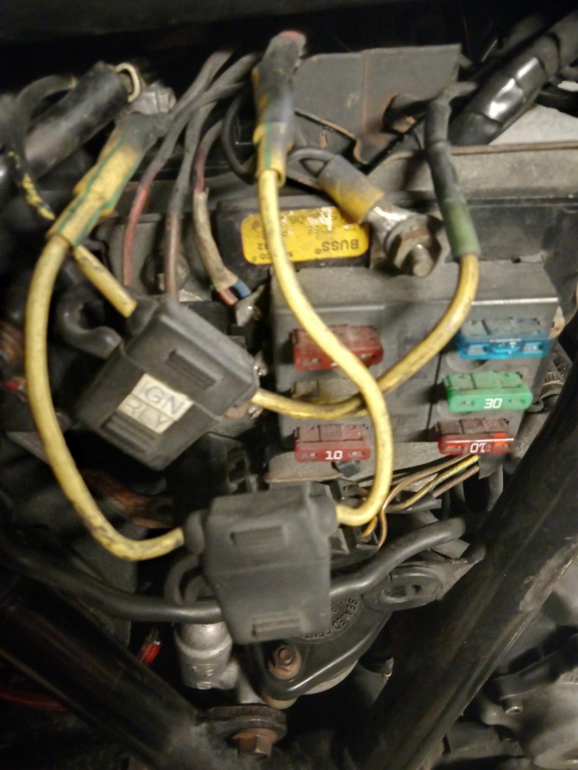

                    A gang type box can be made to work, I have my main fuse and voodoo ignition relay fuse in separate holders though...

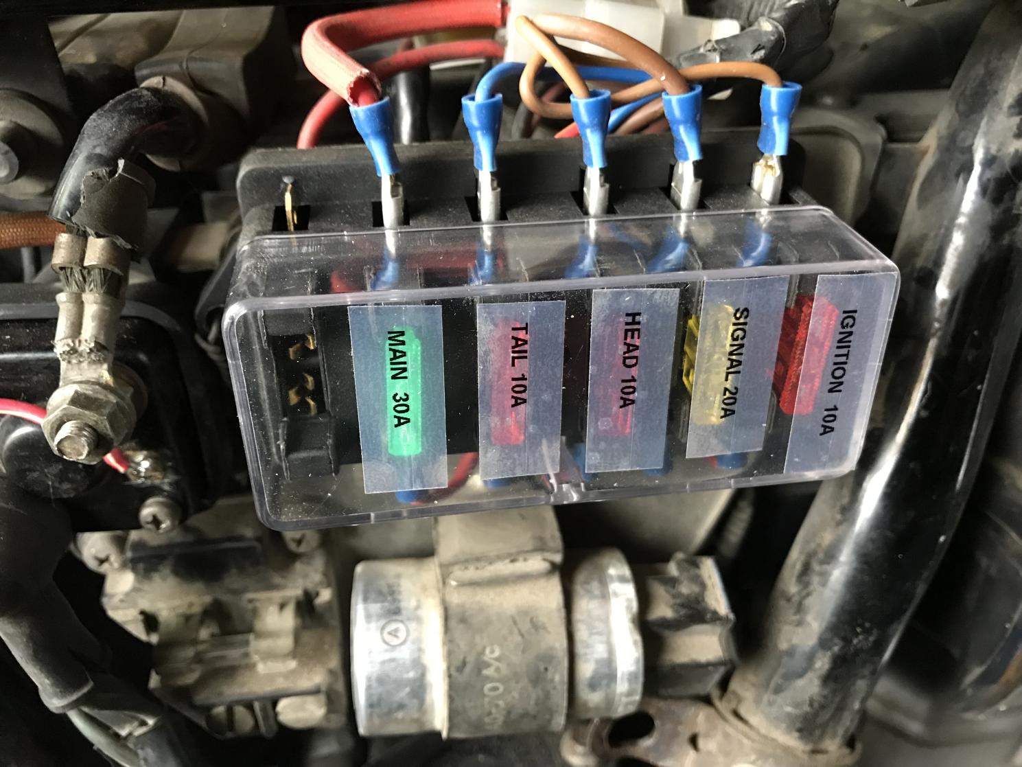

                            Got my 6 fuse block today - bought two - got a Honda that could use the same treatment; Will post a pic once installed.

                              OMG - it's a thing of beauty! I swear the oil & neutral lights are brighter when I turn the key! Got a spare slot for whatever (running lights, fairing accessories, ?) Fits under the side cover with room to spare. Now just have to remember to pack some spare fuses in the toolbox. Thanks to everyone for your input!
