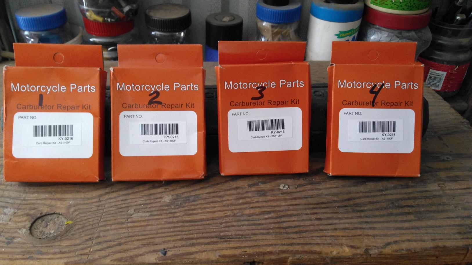

      I myself bought/installed non OEM/non Mikuni partz too!-
      I ran into the problem(s) of the float needle/seat pairs NOT actually sealing thus letting the fuel overflow WAY above the float bowls. My bike ran so poorly I considered it unusable and in an effort to troubleshoot the issue did tests of the primary/secondary ignition, ruled out vacuum leaks by "smoke testing", used a borescope camera with a light to check for mechanical problems in the cylinder/valves/timing, and the list went on and on. BUT all systems checked/tested out as OK. I swapped out the carbs with a Test Bank I keep around for such occasions and the bike ran like the superbike I had come to know fOaR over 15 years. (◕‿◕)
      I determined the float needle/seats were the problem through bench tests on the Original carbs. Fixed it with buying/installing/adjusting NEW needles/seats (K&L...), removed the Test Bank of carbs, and reinstalled the original carb bank. Without the faulty needles/seats the bike "Ran". But I had left in the jets which came in the pretty orange boxes shown above. ( •_•)
      NOT the Superbike Experience I had enjoyed fOaR years. (≖ ︿ ≖ )

      Just sayin' that yup, my bike ran wit thos jets frum the perty Orange boxes. But it was NOT a "Super Bike" and didn't perform like one. ( •́ ⍨ •̀)
      At 60 miles on the trip odometer I couldn't TAKE it anymore, yoinked the carbs, pulled the chinee jets, MIKUNI installed, bank re-installed on the bike. ( ^_^)/
      I don't doubt you when you say, "My XS 1100 with sidecar runs with this kit without any problems." \( ̄O ̄)
      But I bought/own an XS1100 and expect it to run like one. NOT an XS850. ヾ(^-^)ノ
