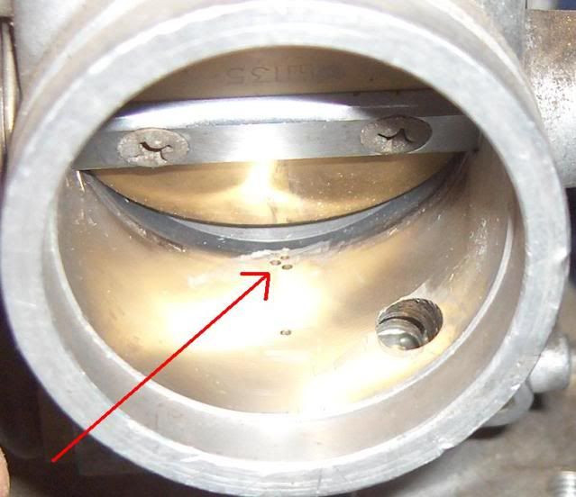

    Inside the throat of the carbs at the top, there are 3 small holes.

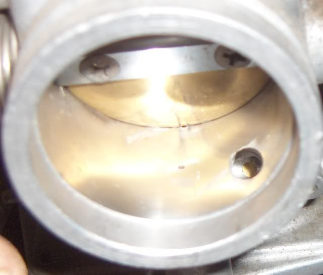

    When you go to install the carbs the first time, adjust the butterflies so that the front edge of the butterfly splits the first hole right in the middle like so...
    This gets the bike started and you can synch it from there.
    Again, credit and the big thanks goes to trbig for this!
