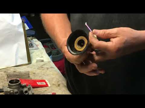

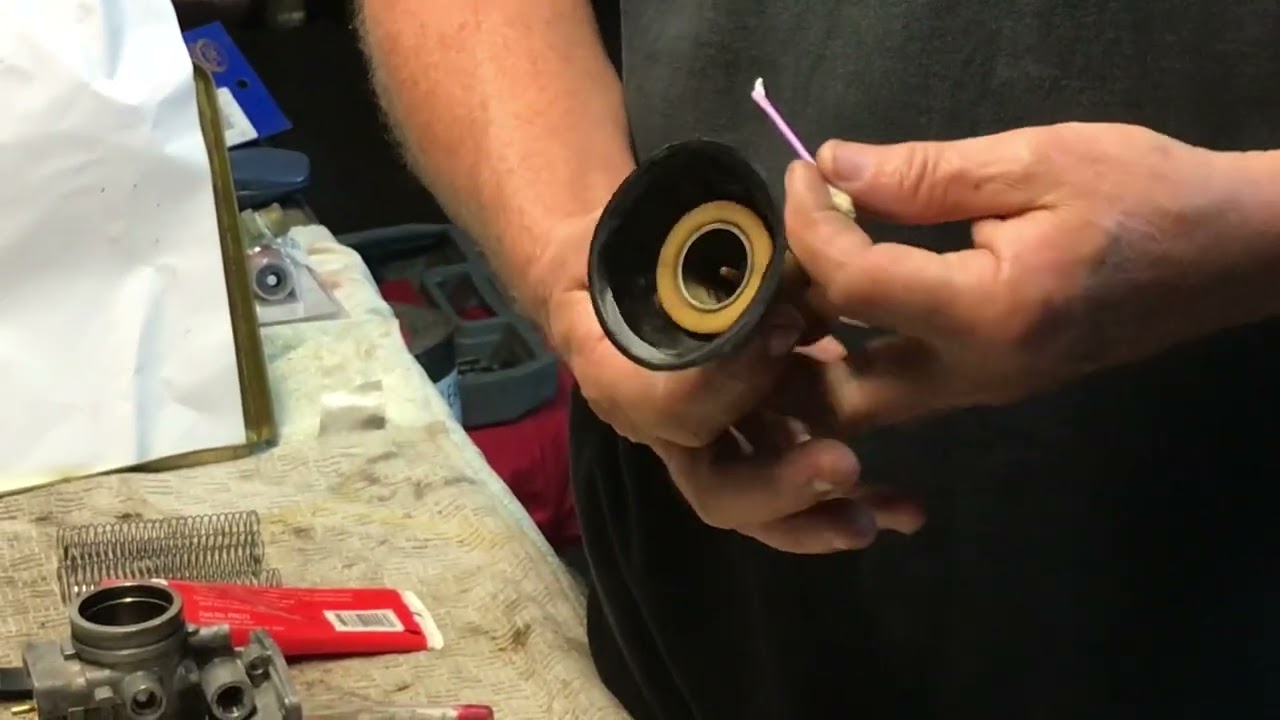

                        Originally posted by Appie
                        Much obliged Cajun! ( and others) Back to my misbehaving carbs then 🤨
                        Cajun and I concure. Slides should STAY up as long as yur certain yur thumb ain't letting air get past and into the frowny hole. ๑(◕‿◕)๑
                        "Mine lazily settle down to the bottom slowly like they couldn’t be bothered to stay up."
                        Alrighty then... we knows wut that M E A N S but wut Next??? (O_o)
                        Here's the answer-
                        Like as shown in the vidya, I used "ThreeBond 1215" a "Liquid Gasket-Gray Solventless Silicone Sag Type" on my own diaphrams with a Q-Tip as the high tech applicator. (^_^)
                        No worries here on my end as we hijack the OP's thread... I mean in his approach he's eliminated the fuel levels as the problem and is way off in the woods chasing wild geeses everywhere and anywhere on his bike so's we can safely say this "thread" will likely go W a a a a y long wit lot's mOaR pages and pages. Yur minor intrusion will be buried and long forgotten in a few months. Plus by that time I'll have prob'ly reached my 100 posts per year quota and therefOaRs no longer be available till 2026. (O_O)
                        JUST-IN-CASE? (O_o)
                        We'll add fOaR his benefit that iffin his #3 carb slide ain't playing well wit' the others in a "One of these things is not like the others... one of these things just doesn't belong" kinda way? (O_o)
                        In the Diaphram vid Steptoe shows that the slides/diaphrams need to be installed in the proper direction and HOW to tell which direction is correct. (^_^)
                        Might be wuth the effort of the OP to check-n-see iffin #3 slide got put in 180 degrees backwurds by one of the many owneres befoAr him. (_Oo)

                            Thanks Larrym! Weekend coming up so I’ll watch that for sure unless the wheels come off at work. We don’t have 3Bond here as far as I know but what I do have is (hesitant to put it on this forum in case you block me) is…..Hondabond. There I said it! Worried my Yamaha will have an allergic type reaction if I put it on though.
                              • 7818
                              Hondabond is sometimes easier to get, and a lot of us have used it. My bikes don't mind it, as it does what is needed.
                                • 2011
                                Only need a very thin film on a clean and dry surface. Let it cure before installing.
