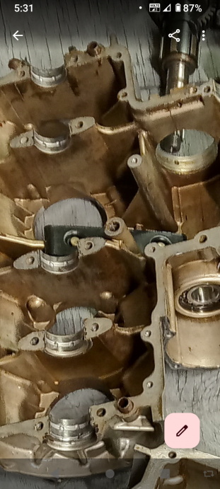

        Here's a pic that shows it. Looks like the cases must be split and the crank removed to access.
        Click image for larger version  Name:	Screenshot_20250224-173131.png Views:	0 Size:	385.0 KB ID:	883380
        • Rasputin
          • 3193
          • Lacombe, Alberta, Canada
          That picture pretty much explains that indeed the cases will need splitting Thanks very much!
