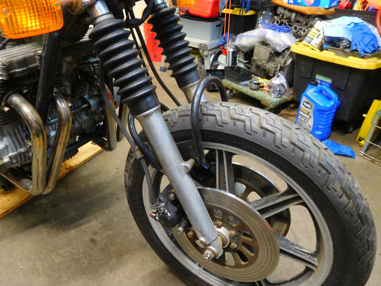

              The XS11 was over engineered (which is good). I torque the nut but never use a cotter pin. Never had an issue and I put on heavy miles. Most bikes don't have this feature anymore. Like rim locks. 70's overkill devices.
