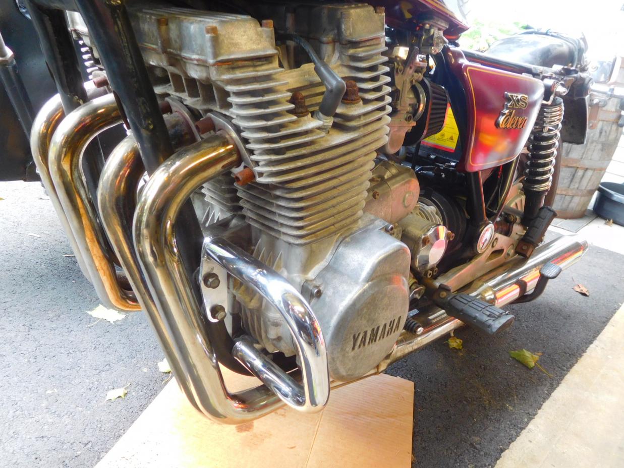

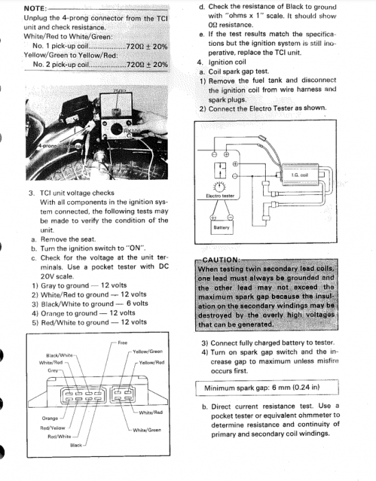

    Just getting back to the 1981 1100. Rebuilt the carbs and fired it up. Running a little rough. Pulled the 1 plug wire and had a slight change in running. pulled # 2 and it died. Tried again with 3 and also died. # 4 reacted like #1. Decided to check coils and have between 2.4 and 2.7 on coil primaries. Tried checking secondaries and nothing on both coils checking plug to plug and plug to wire.. I do have some spark on both 1 and 4. Any idea what I am missing? first tiime checking coils.

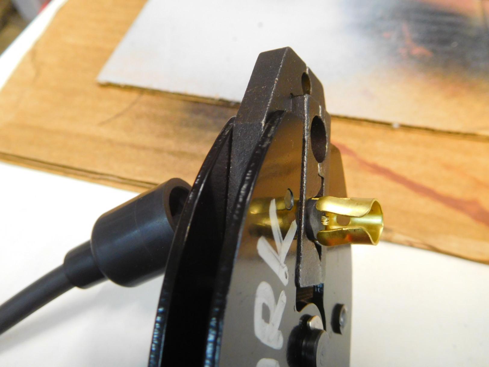

    With 40+ year old coils that may be the problem. The two things to try BEFORE going the new coil route are the plug caps and wire ends.
    You can unscrew the wire caps off the end of the plug wires. Once off, you should have about 5K Ohms resistance between the wire side and the plug side. If it's higher or just open, replace all the caps. The new caps can be the non-resistor type, as you just put in resistor plugs.
    On the coil wires, cut off about 1/4" of the end of the wire. There may be oxidation causing a resistance that will also cause problems.

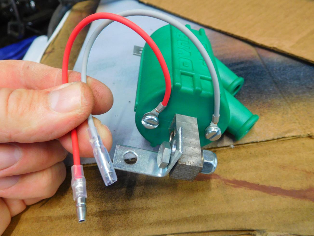

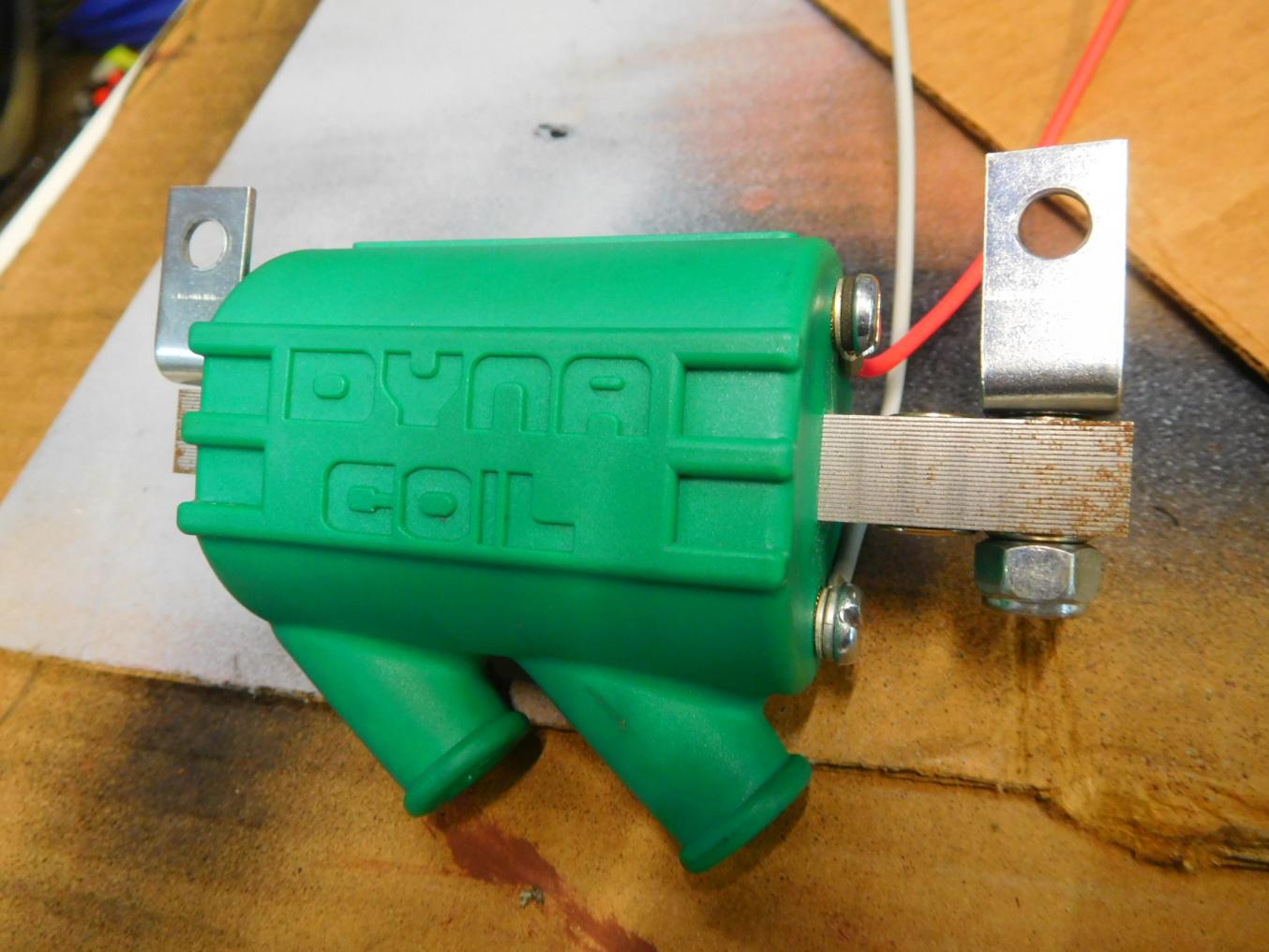

            You might want to consider replacing your coils. Check this maintenance tip out. Dyna Coil Upgrade - XS11.club Forums
            Be sure to note that the now recommended Dynatek coils are the DC1-1's. They are available on Ebay. Also, if you go this route make sure you include solid core wires. You can go with the non resistor plug caps and resistor plug combination.
            One other note: if you go this route you will need to do away with your ballast resistor. The coils in the tech tip are 1.5 ohms, The DC1-1's are 3 ohm.
            Re reading this post I noticed that you have an 81LH so you won't need to worry about a ballast resistor. Your bike has the 3 ohm coils originally.
              https://www.ebay.com/itm/38728100667...Bk9SR4rio_31ZA
Name:	Opera Snapshot_2024-12-10_041126_www.ebay.com.png

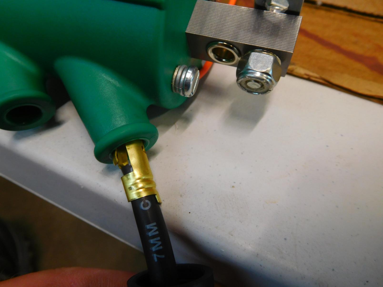

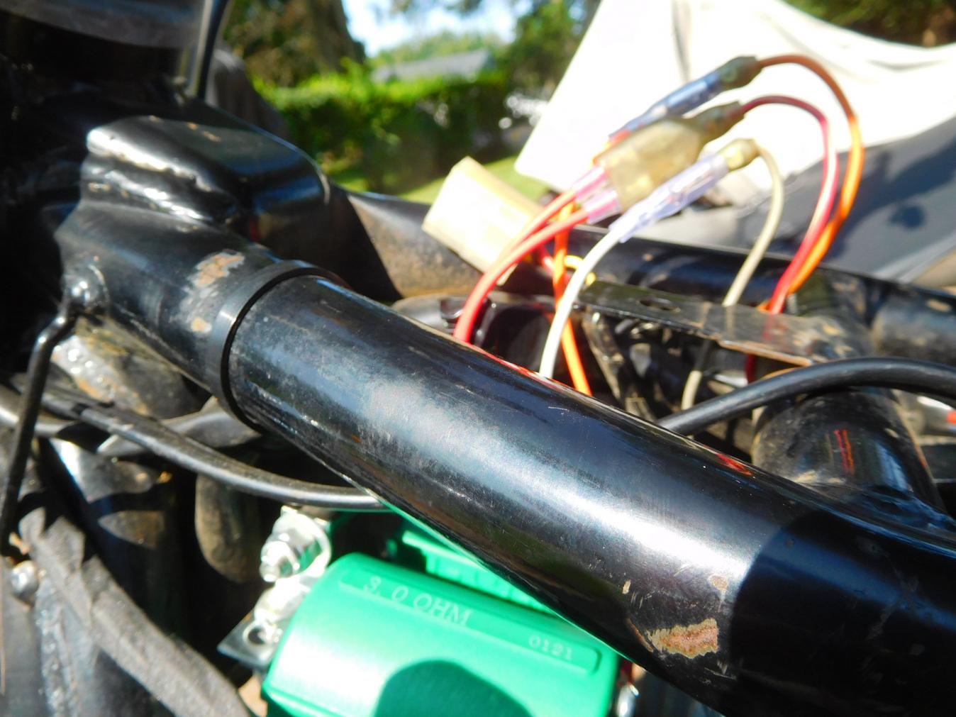

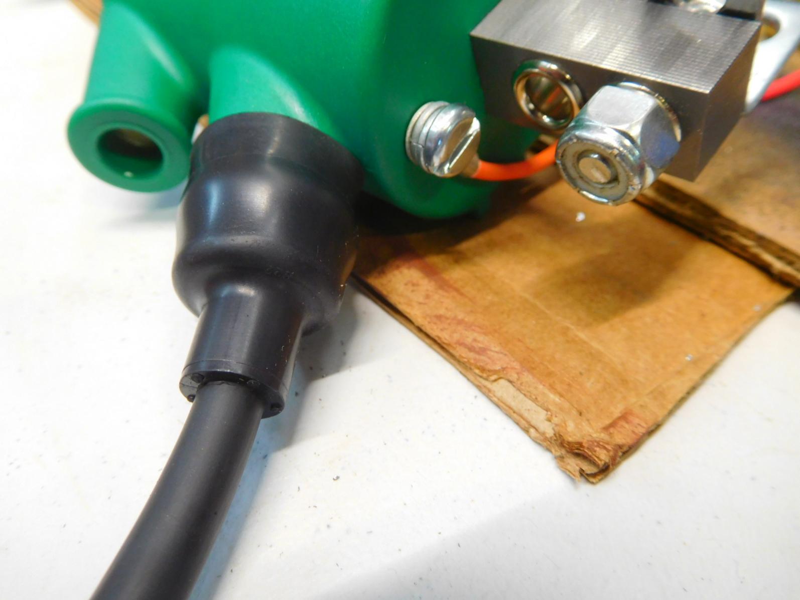

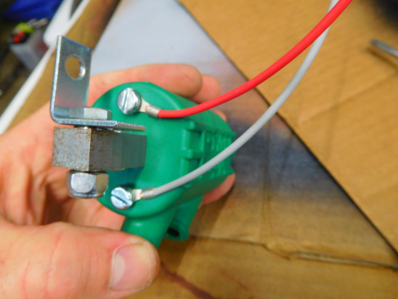

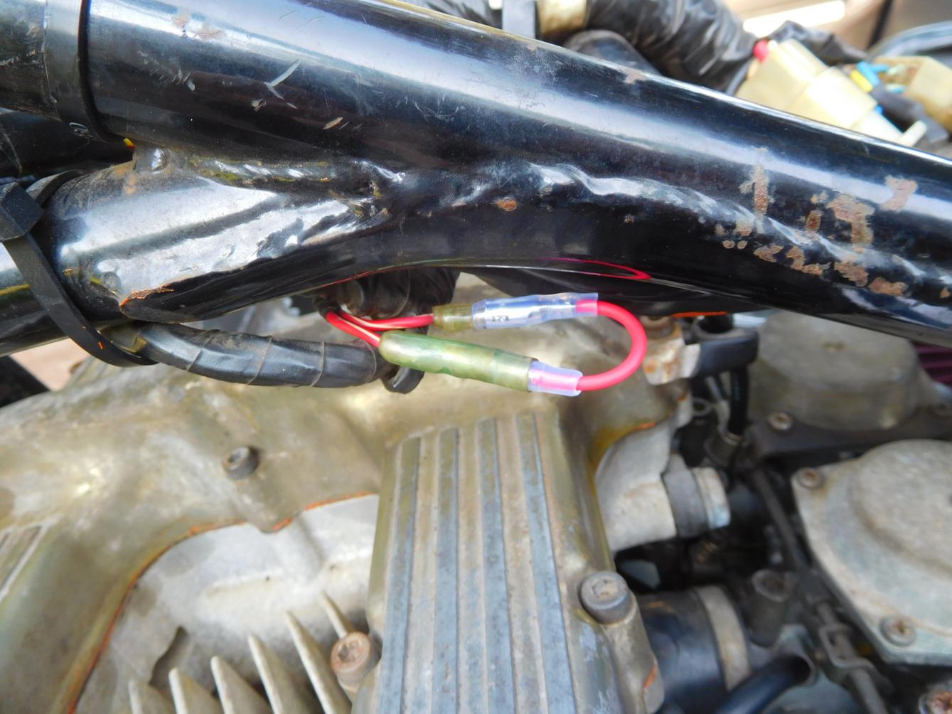

                The Dyna coils are nice. Don't buy the Chinese counterfeit units. I noticed a big difference in performance.
ID:	882434 Click image for larger version
ID:	882435 Click image for larger version
ID:	882436 Click image for larger version
ID:	882437 Click image for larger version

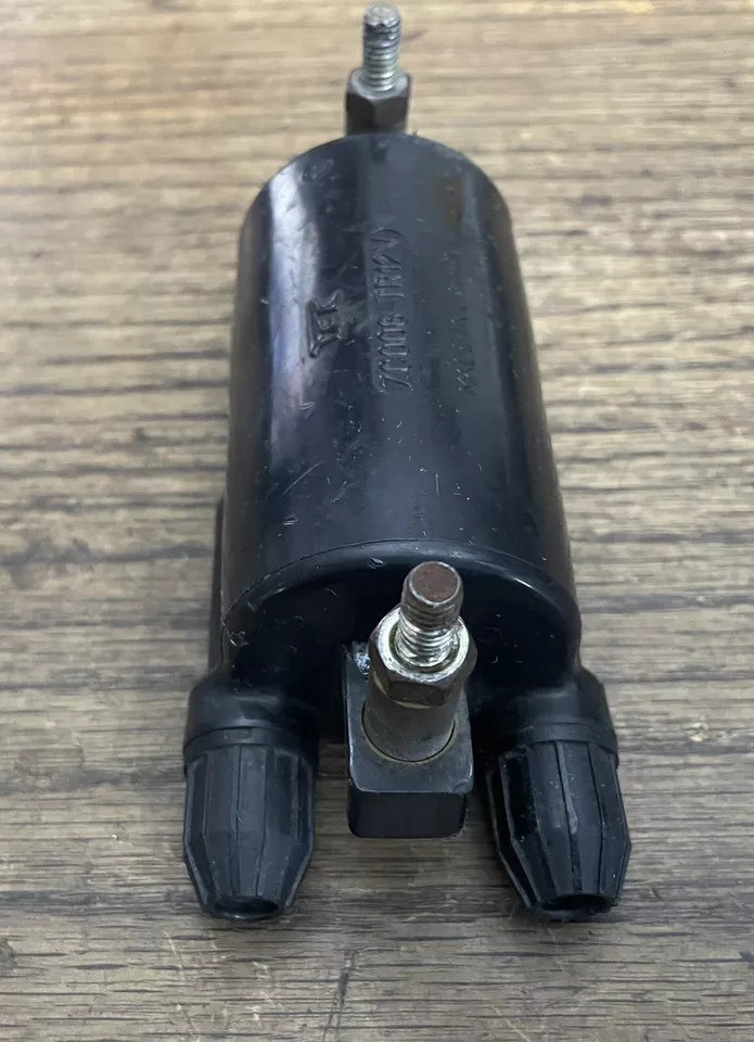

                        Thanks for the input. Was looking at Yamaha oem coil replacements. Can anyone loan me a arm and leg? Lol
                        81 LH in process
                        09 vstar 1300
                        only allowed 2

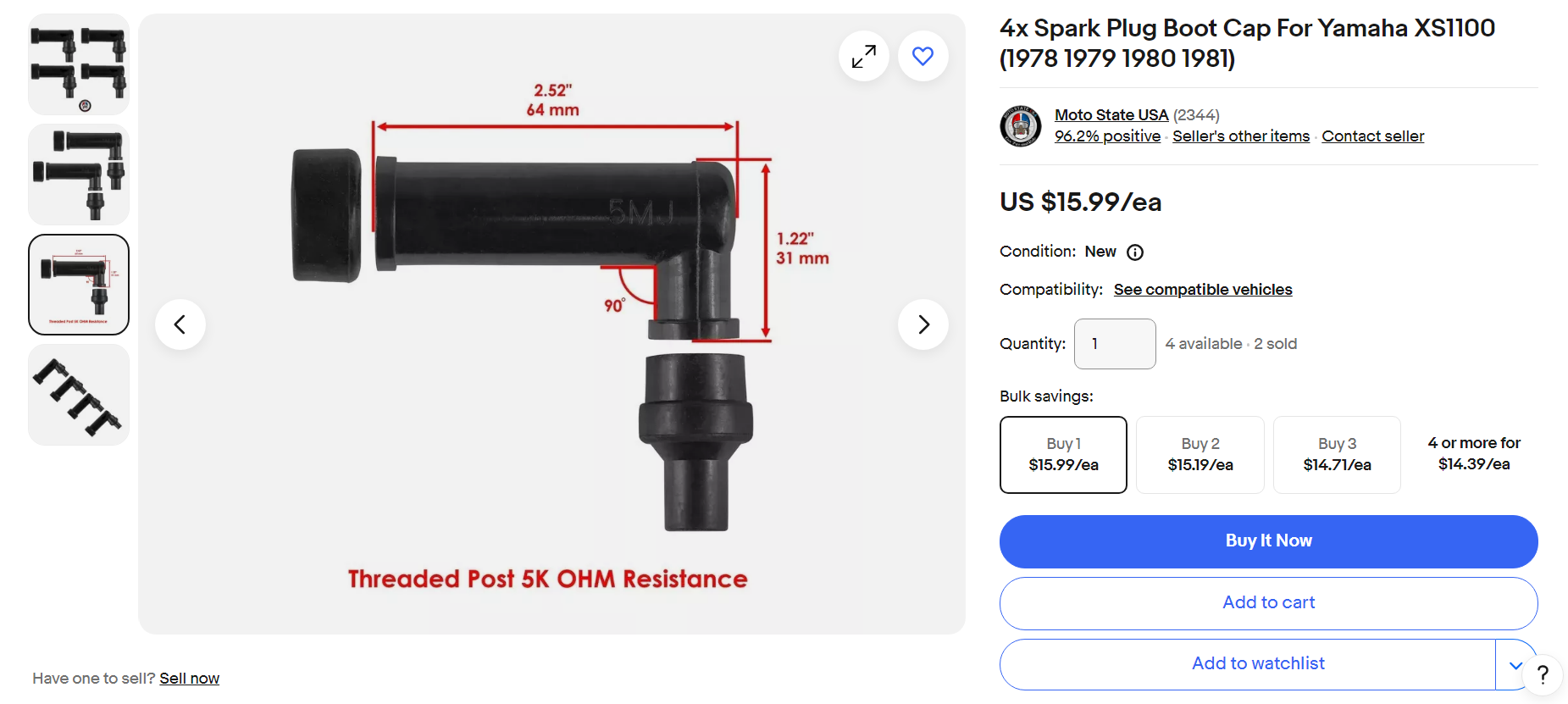

                          I'd go with NON-RESISTOR caps and resistor plugs first before deciding to start throwing money at the problem hoping it fixes it. Non-resisor plugs are getting harder to find so in this case it makes sense.
                          I'll never forget an old school mechanic telling me one time "I've only seen a bad coil ONCE in my entire career" On my bike I swapped my coils over to 3ohm Honda coils off a 88 750 Nighthawk in order to eliminate the ballast resistor and also change the wires and it works well. A lot of people like to spend big bucks on things thinking they're getting something better and if you've got $200 to spare for a set of coils then by all means go for it! Mine where $20 each.
                            Yes, I agree that a good used coil is better quality than most new coils these days (especially Chinese junk coils). Make sure its 3 Ohm like LAB3 mentioned. Another good feature to look for is wire nuts which make putting on new high tension wire easy. Non resistor ends are good also. You will get hotter spark.
                            Click image for larger version  Name:	ezgif-7-9535783e9e.jpg Views:	0 Size:	154.5 KB ID:	882491

                              Just a update. Found a bad plug which i think was grounding out 1 and 4. Replaced and bike starts and idles. 1 and 4 making required drop when cap is pulled. cap 4 lit me up so it is definitely bad. I have new caps on the way but doesn't look like i need a coil.
