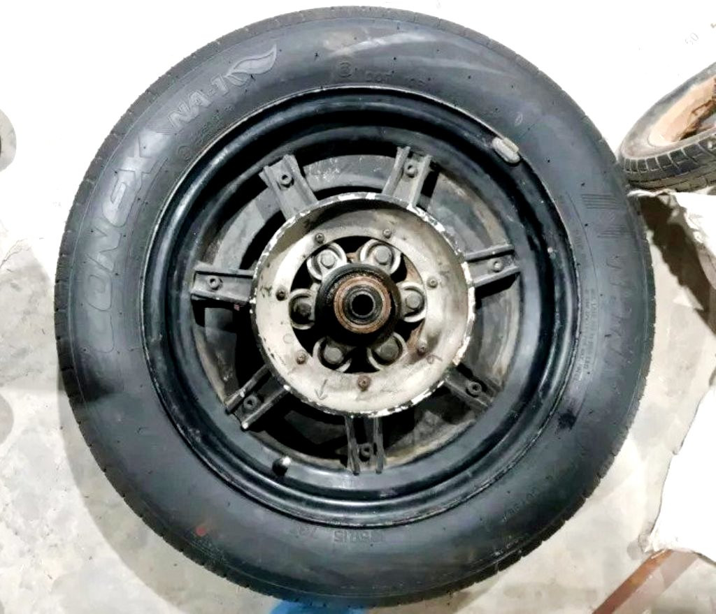

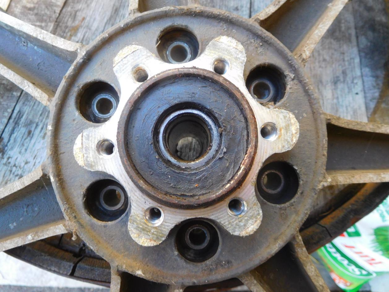

      Well, my project has kind of evolved as projects do. I am looking into having a custom 15" to fit a car tire wheel fabricated using the stock hub as shown with this BMW wheel.
      Click image for larger version  Name:	E7EDA53E-5DF1-4F4B-B9DF-775360C734FD.jpeg Views:	0 Size:	94.7 KB ID:	882224 Click image for larger version  Name:	8EEA3EBF-10B6-40A0-A7A9-AF0A121E7094.jpeg Views:	0 Size:	142.6 KB ID:	882225 Click image for larger version  Name:	EB51EDAF-3F7A-444A-980E-EEA5086BB959.jpeg Views:	0 Size:	156.3 KB ID:	882226
        • 1682

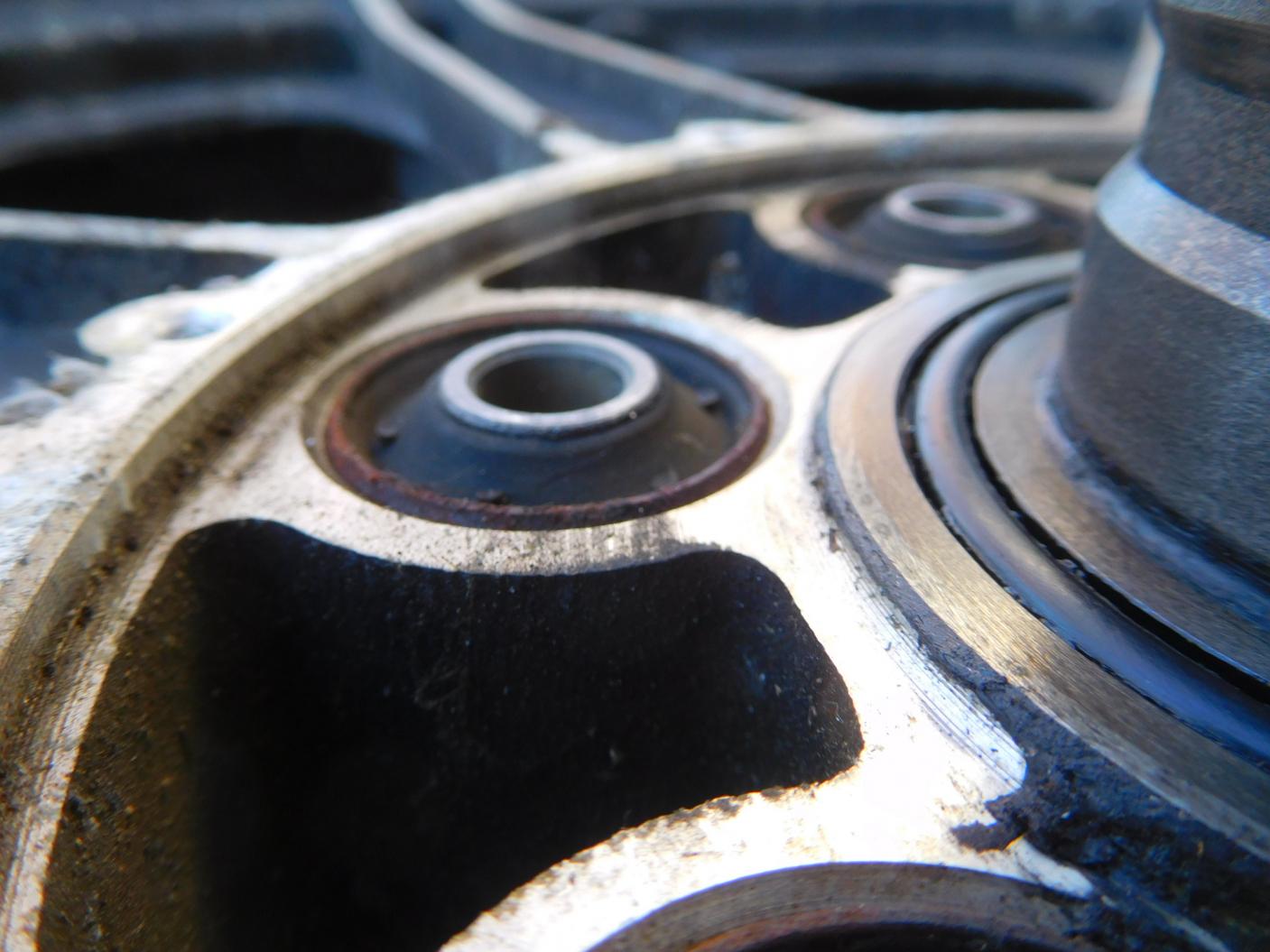

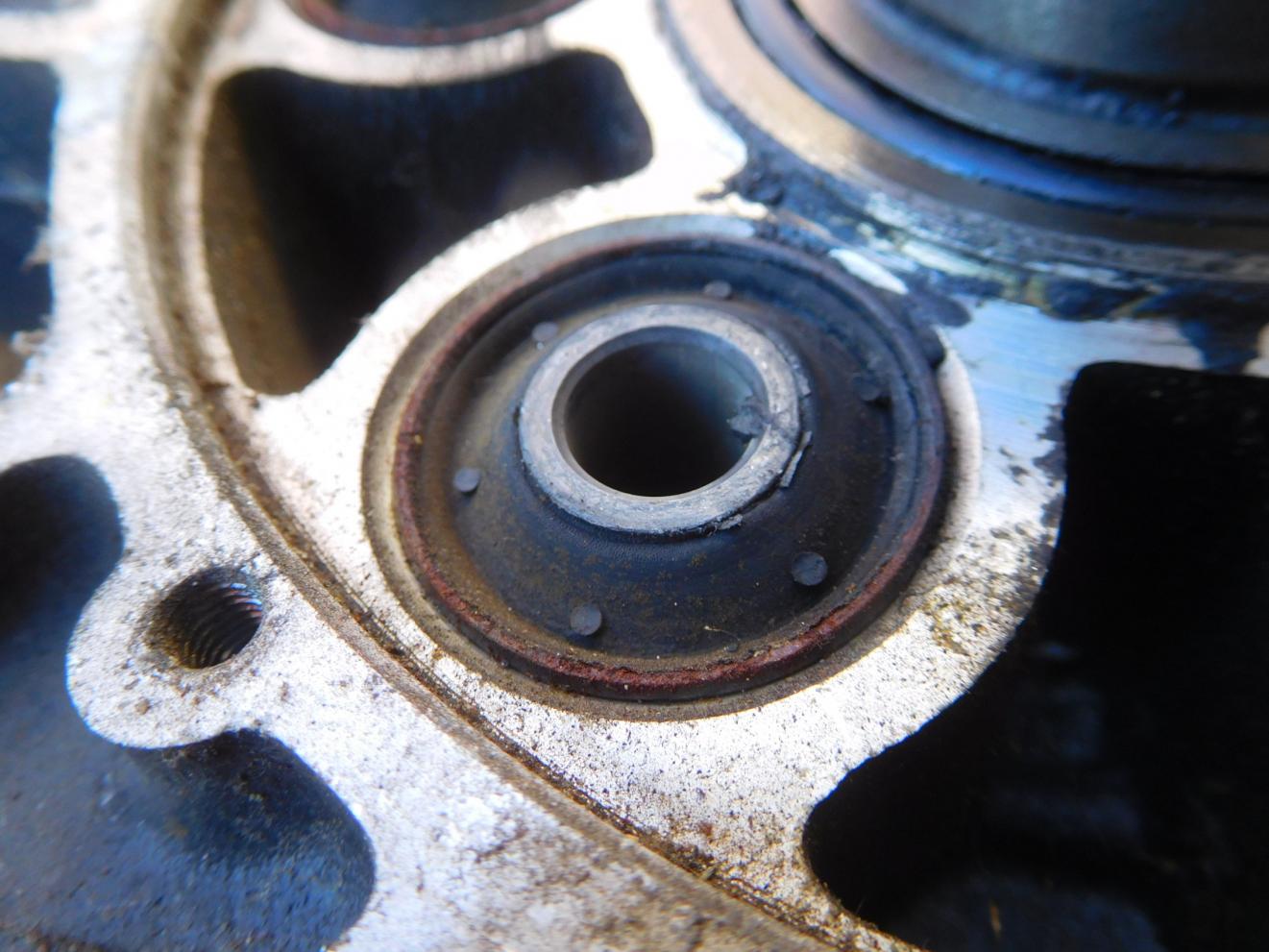

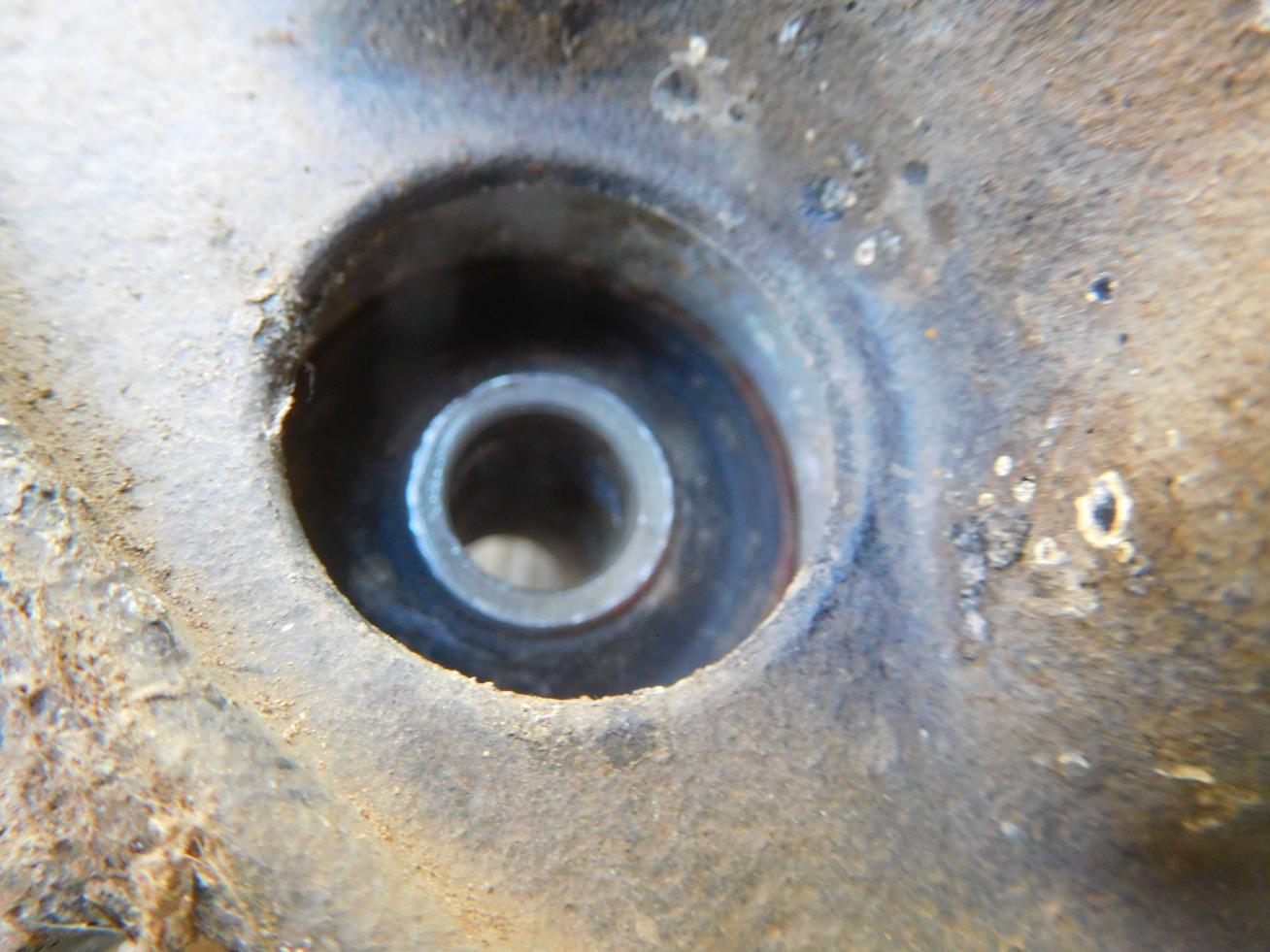

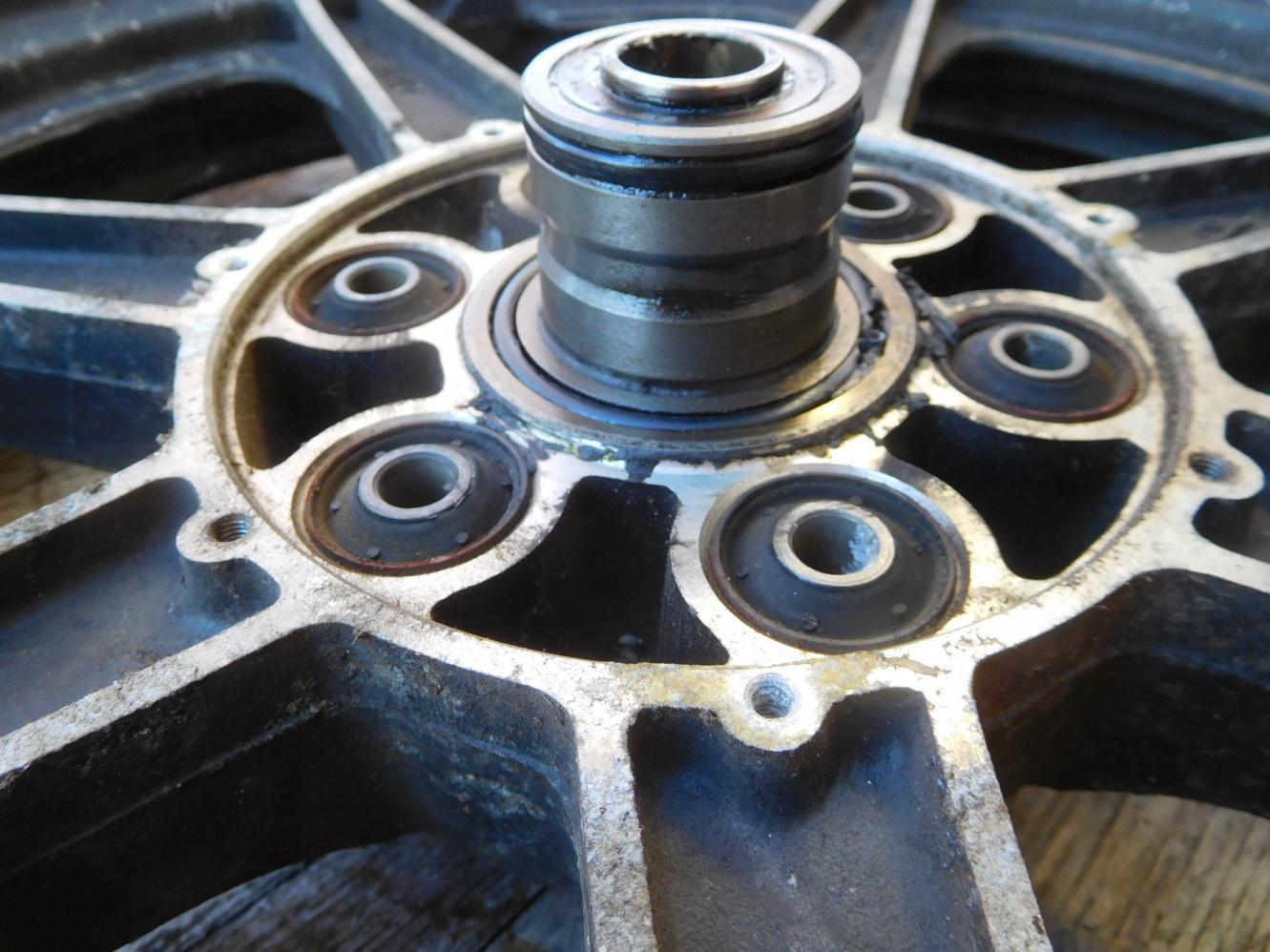

        My question is about the stock cush drive. The rubber inserts. Has anyone ever removed and replaced these? Are they vulcanized? They would need to be removed (ideally) in order to take the heat that welding will generate.
        Click image for larger version  Name:	DSCN3751.JPG Views:	0 Size:	150.1 KB ID:	882228 Click image for larger version  Name:	DSCN3754.JPG Views:	0 Size:	139.0 KB ID:	882229 Click image for larger version  Name:	DSCN3755.JPG Views:	0 Size:	127.4 KB ID:	882230 Click image for larger version  Name:	DSCN3760.JPG Views:	0 Size:	158.0 KB ID:	882231 Click image for larger version  Name:	DSCN3762.JPG Views:	0 Size:	132.6 KB ID:	882232

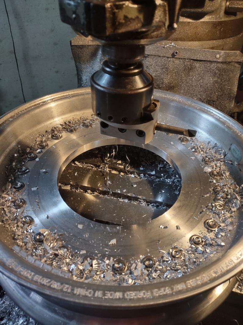

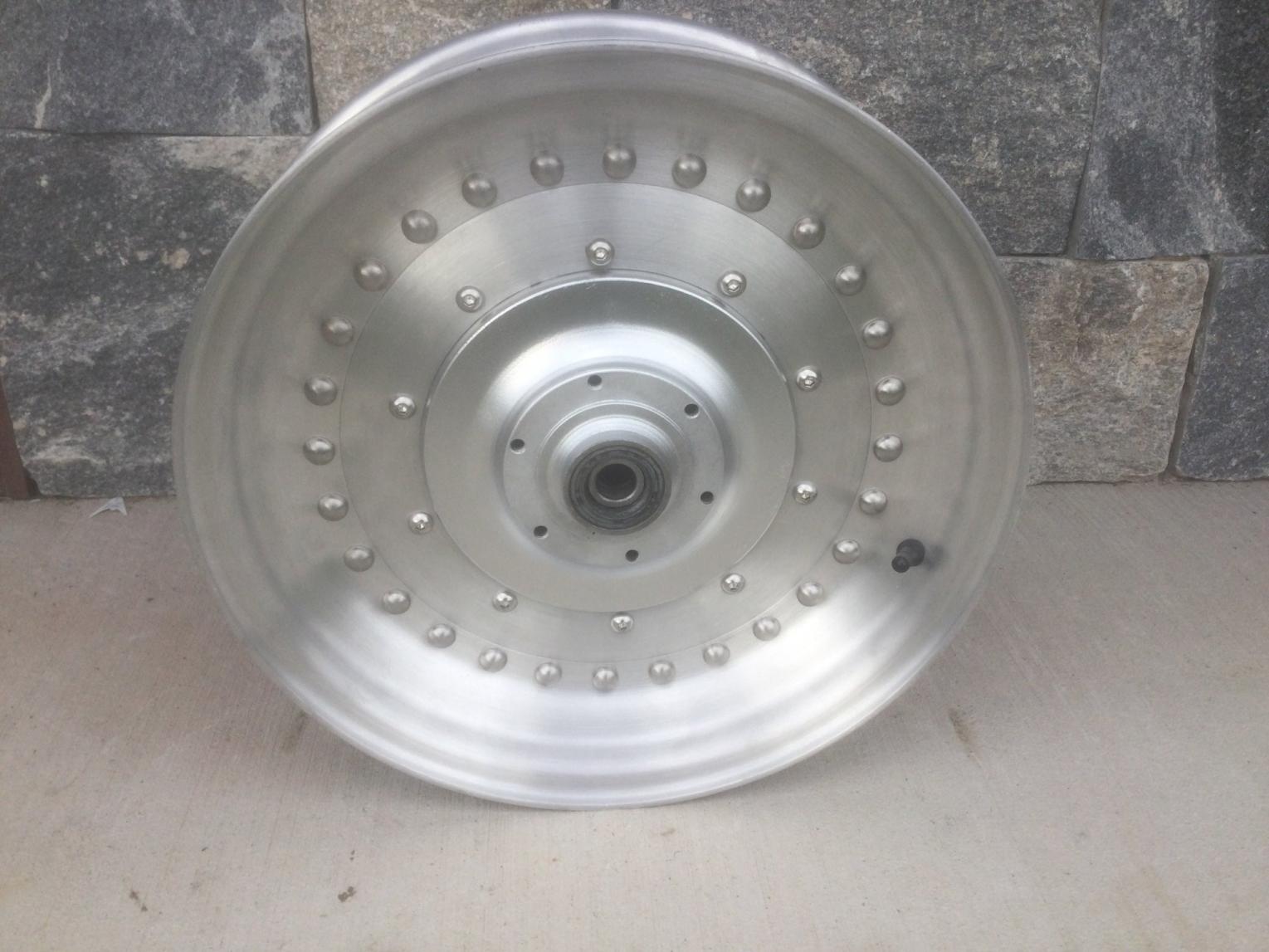

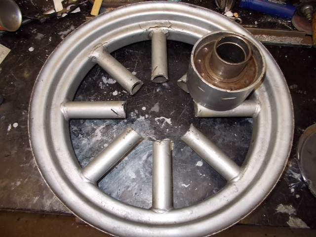

            I found this on the internet years ago from Australia if I remember correctly.
            Click image for larger version  Name:	Car Tire Rim.jpg Views:	0 Size:	178.0 KB ID:	882236 Click image for larger version  Name:	Car Tire Rim A.jpg Views:	0 Size:	157.6 KB ID:	882237 Click image for larger version  Name:	Car Tire Rim B.jpg Views:	0 Size:	127.4 KB ID:	882238

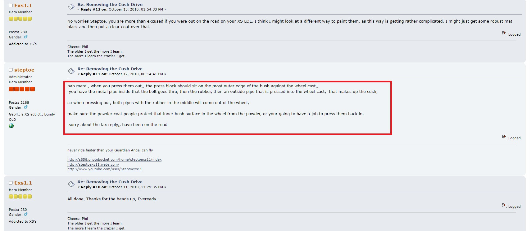

              Found it! Leave it to Step Toe.

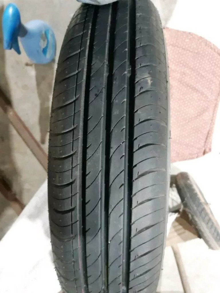

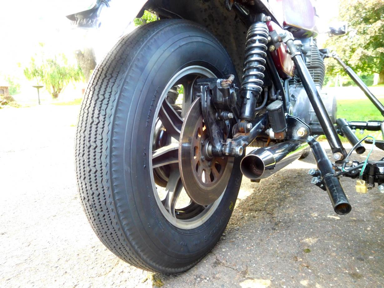

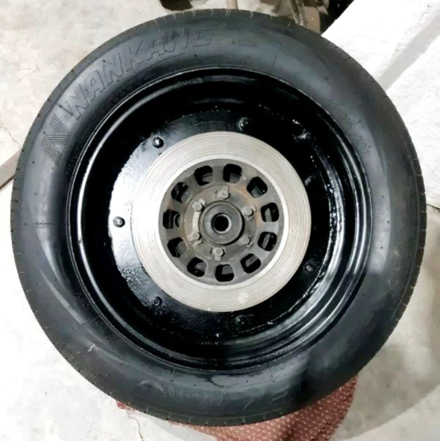

                I'm looking into running this tire.
Name:	Opera Snapshot_2024-11-21_040401_www.ebay.com.png
                  • 1682

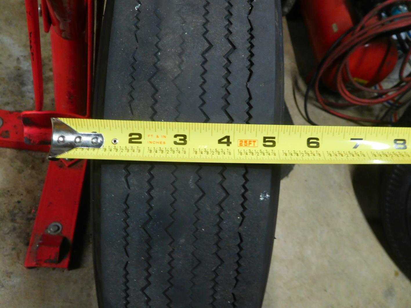

                  Looks like the tread is 6.5 inches wide. 25.4 inches tall. I wonder if that width will fit inside the swing arm.
                  Edit: My present tire is 5.6" at it's widest point on the sidewall. The 6.5" tread tire 9above) will add another inch or two sidewall which would be close to 9". A 165/80-15 is too wide.
                    • 1682

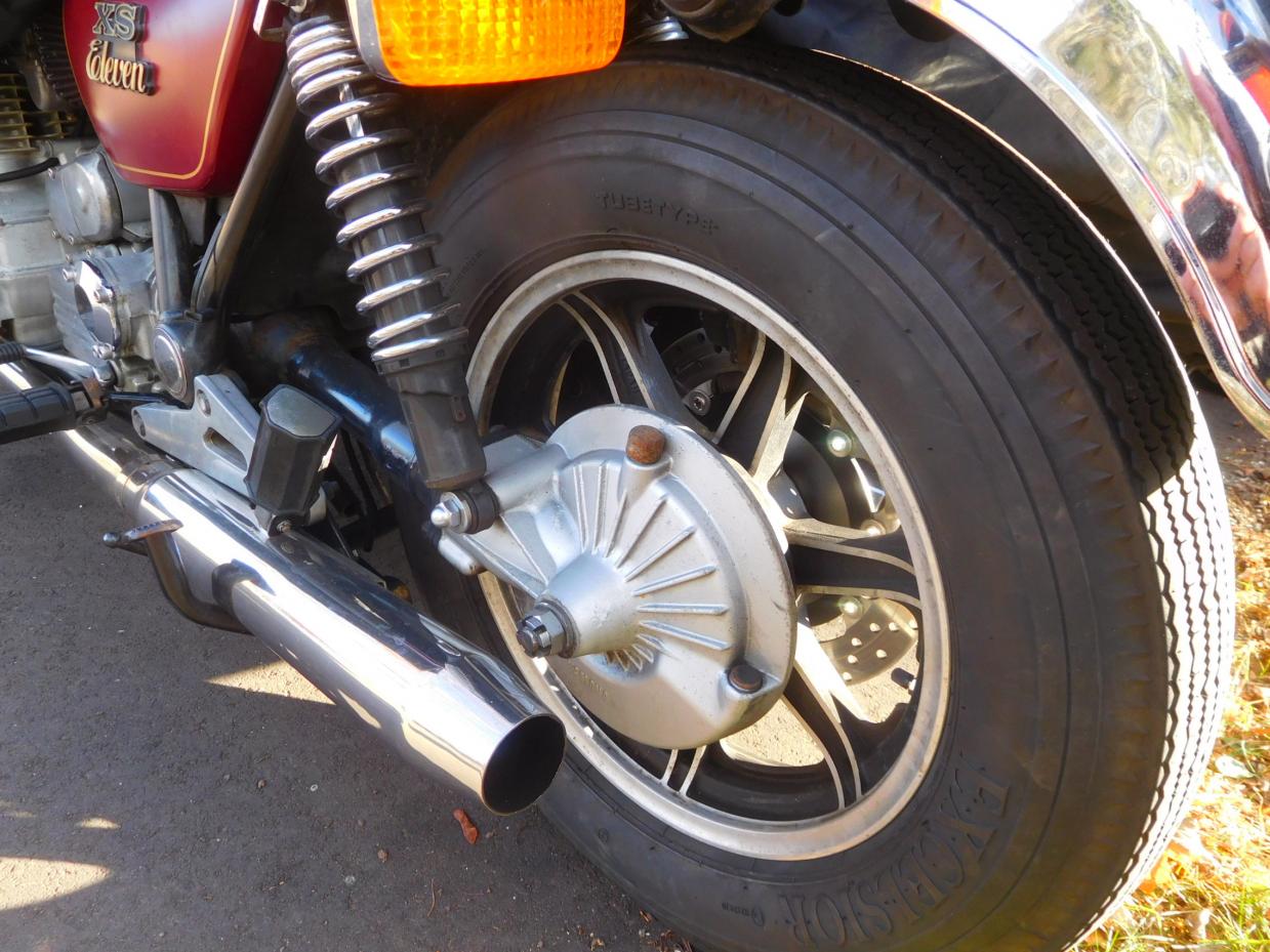

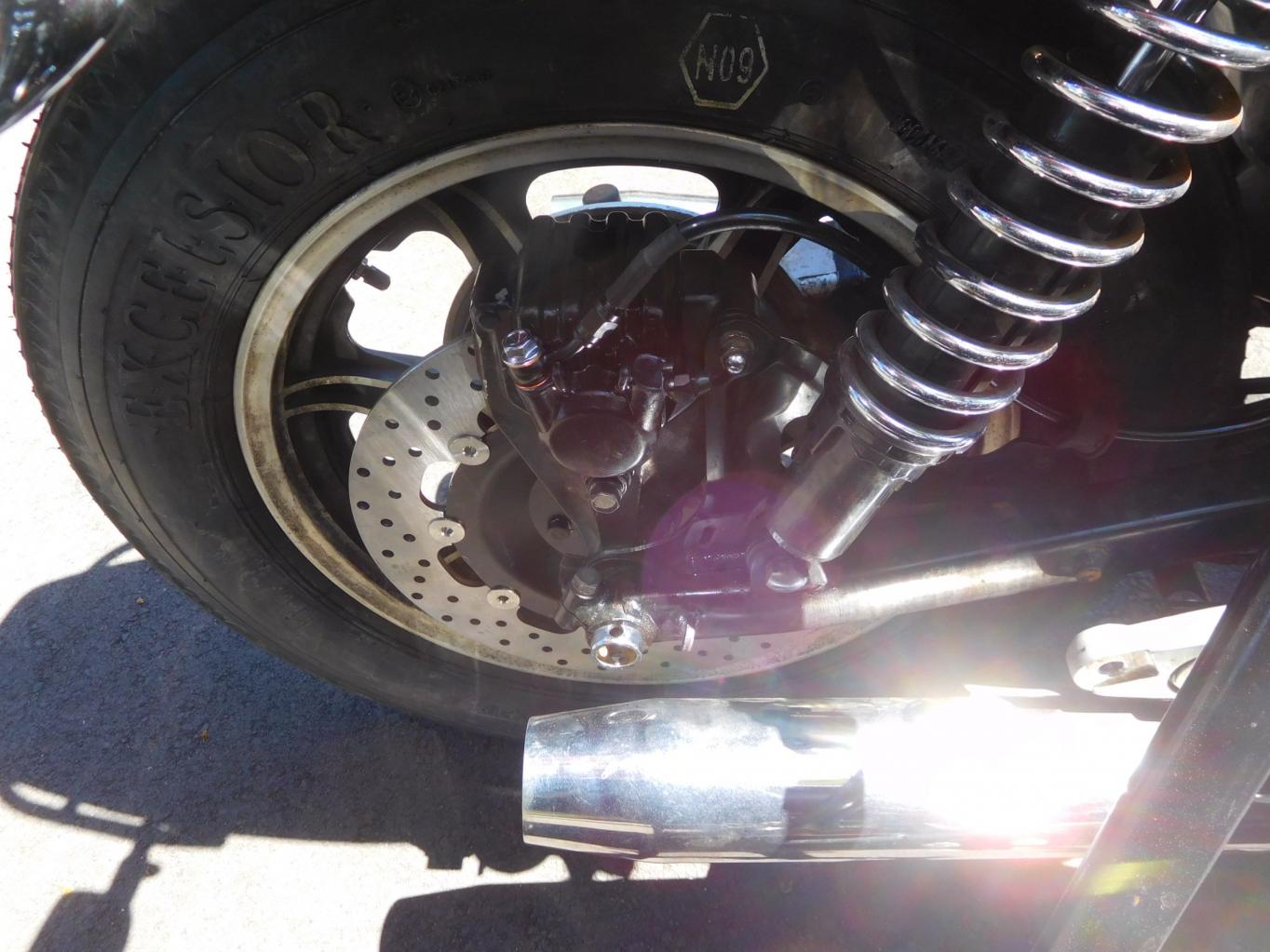

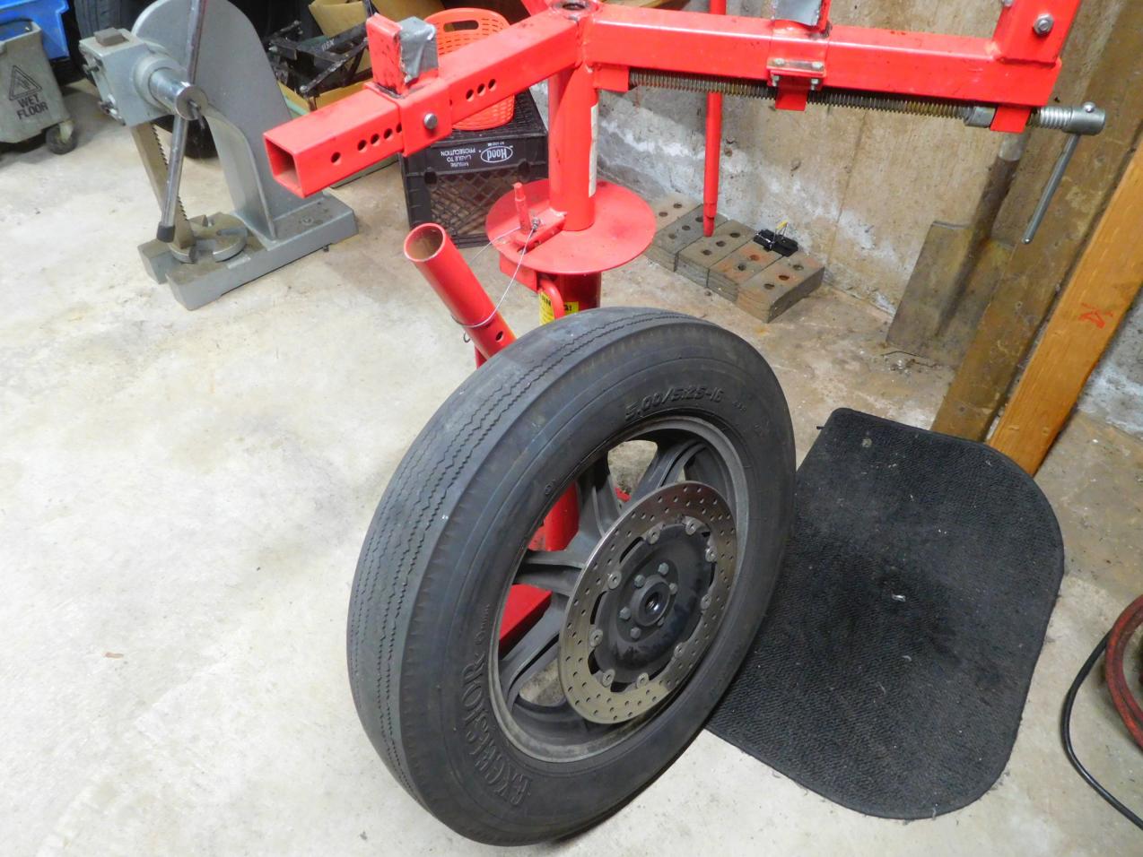

                    Boy, the Excelsior tire is pretty tight. I think the 6.5 inches might have more width at the sidewall.
ID:	882248 Click image for larger version
ID:	882249 Click image for larger version
ID:	882250 Click image for larger version

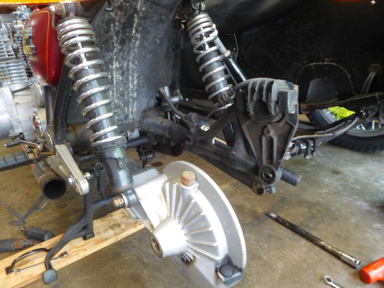

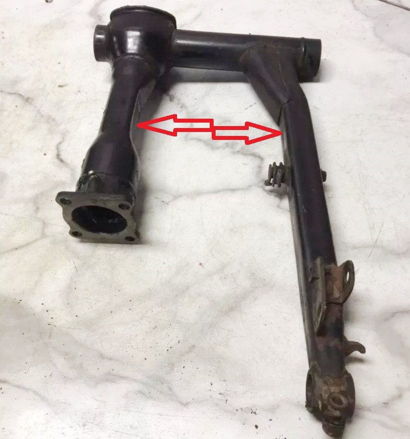

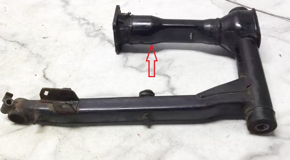

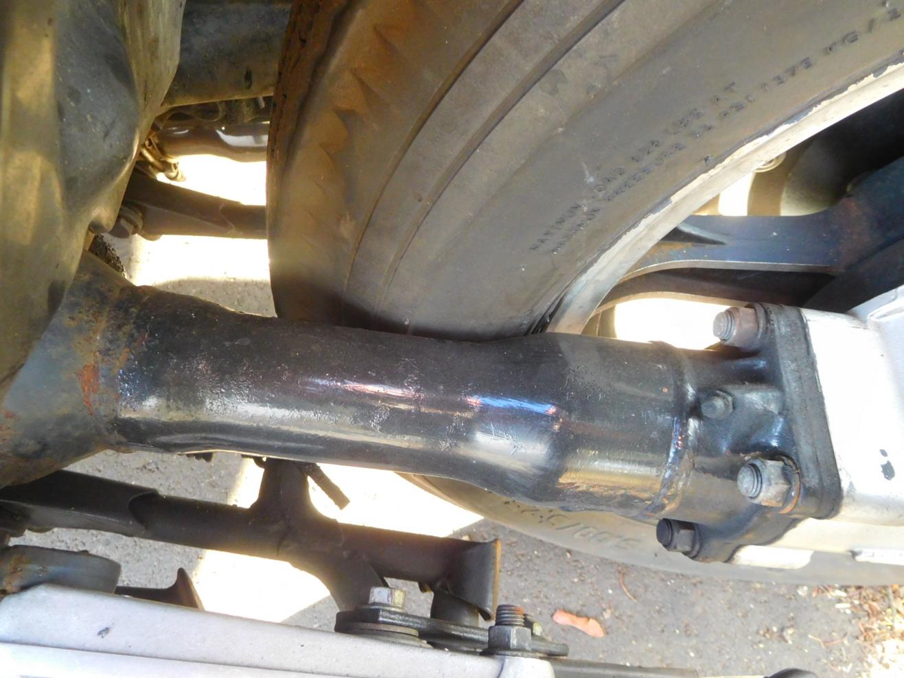

                        Does someone have the inside width of an XS11 swingarm where the top of the tire resides?

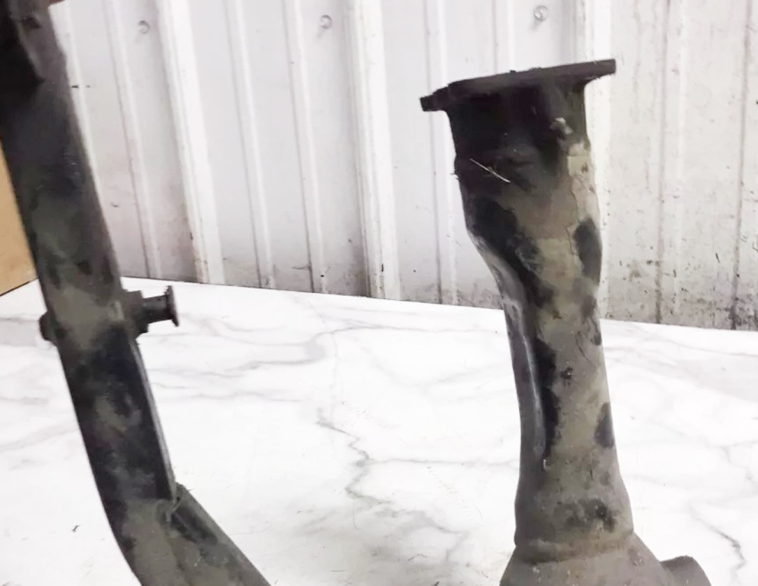

                          • 1682
                          However, this is the spot that would be the most problem. The reduced diameter of the wheel will bring the widest part of the tire right here. Wonder if I can cut and weld a small relief in that area without hitting the rotating shaft.
                            • 1682

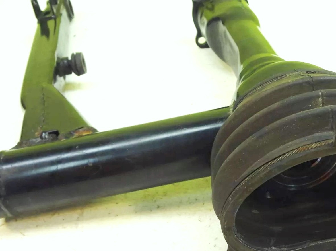

                            I am also seeing a possibility that the 81 XS and XJ1100 have a little relief cut on that spot for a wider tire. Is that possible?
