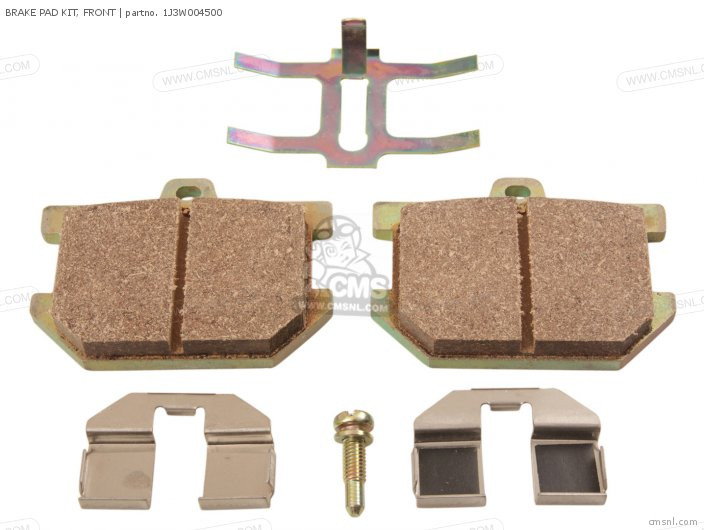

    I am confused buying brake pads... I know the special has different pads for the left and the right caliper on the front... and EBC chart says that EVEN for the Standard G that I have... can you help me out here. Are the pads different on my G?

    The G front pads should be the same on both sides. The SG, and ALL S pads are each different for the front. Yes, four different pad!

        Cool. Seat cover is immaculate, just the foam really sucks. For the pads, the rear appears to be the same too?
          Yes, both of the front calipers as well as the rear use the same pads on the G.
