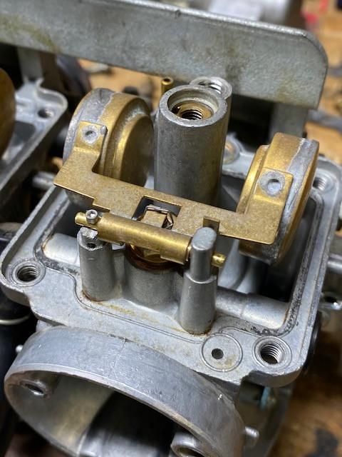

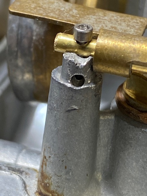

    This is what I did and the repair seems ok Click image for larger version  Name:	IMG_3970.jpg Views:	0 Size:	79.8 KB ID:	881886 Click image for larger version  Name:	IMG_3971.jpg Views:	0 Size:	104.2 KB ID:	881887

      When I purchased the bike someone had their hands in it and wired the pin. My repair is 0-80 allen bolt

        GREAT REPAIR Mjpcarbon,,,,it looks like Yamaha should have done that from the factory and it would have made it sooooo much easier when repairing the carbs and eliminate the dreaded broken post syndrome. If both ends of the post were like your repair from the factory, many a carb would still be good today. Thanks for the pics,,,,ride on, Mike in San DIego and Pa.

          I'm sure it'll outlive the bike but I'm always leery of threads in aluminum, especially when they get that small. If I was gonna do a bolt I would take the post off below where he drilled the wire hole, then do what you did with a larger bolt threadlocked in and a hole drilled perpendicularly through the bolt.
          Here's a handy chart for the curious, it mentions you should use a smaller drill in aluminum and gives ranges for the drill bits. Most drill/tap charts are for 75% threads, but you want like 85-90% in aluminum. A 0-80 thread has .006" thread height, so every little bit counts.
