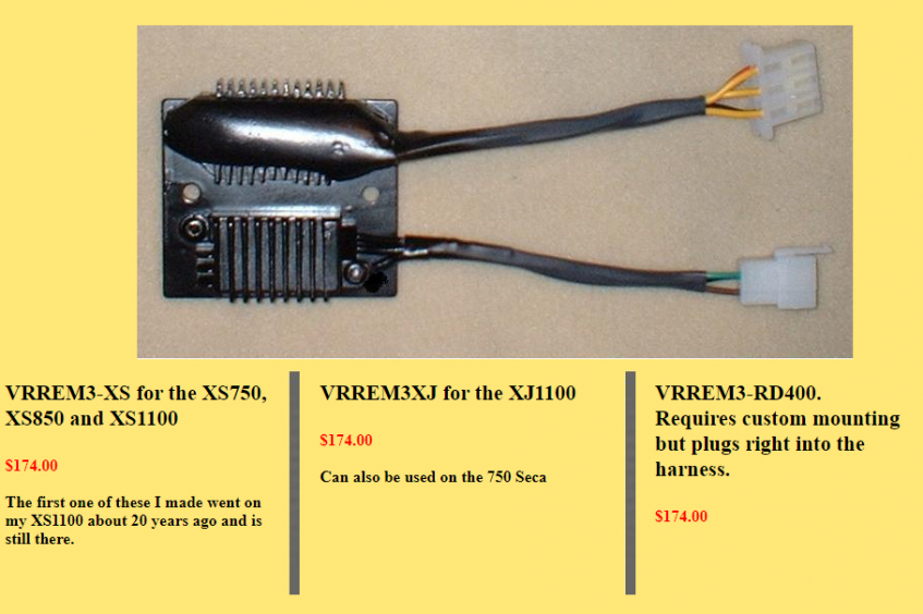

    Check ALL grounds first. If it's still not charging, check the voltage into the reg/rec. Set the DVM to AC volts, and verify about 15 to 18V AC. If that is good, you probably need a new reg/rec. I would say go to http://www.oregonmotorcycleparts.com/VRREM.html The VRREM-3 is what you need to fix it. I have one on my bike now, and had one on my standard that I sold about six years ago. They work VERY well, and are easy to install.

                  Spend the money on one from Tony, Oregon Motorcycle products. WELL worth the cost!
                    • 1820
                    I love mine!
