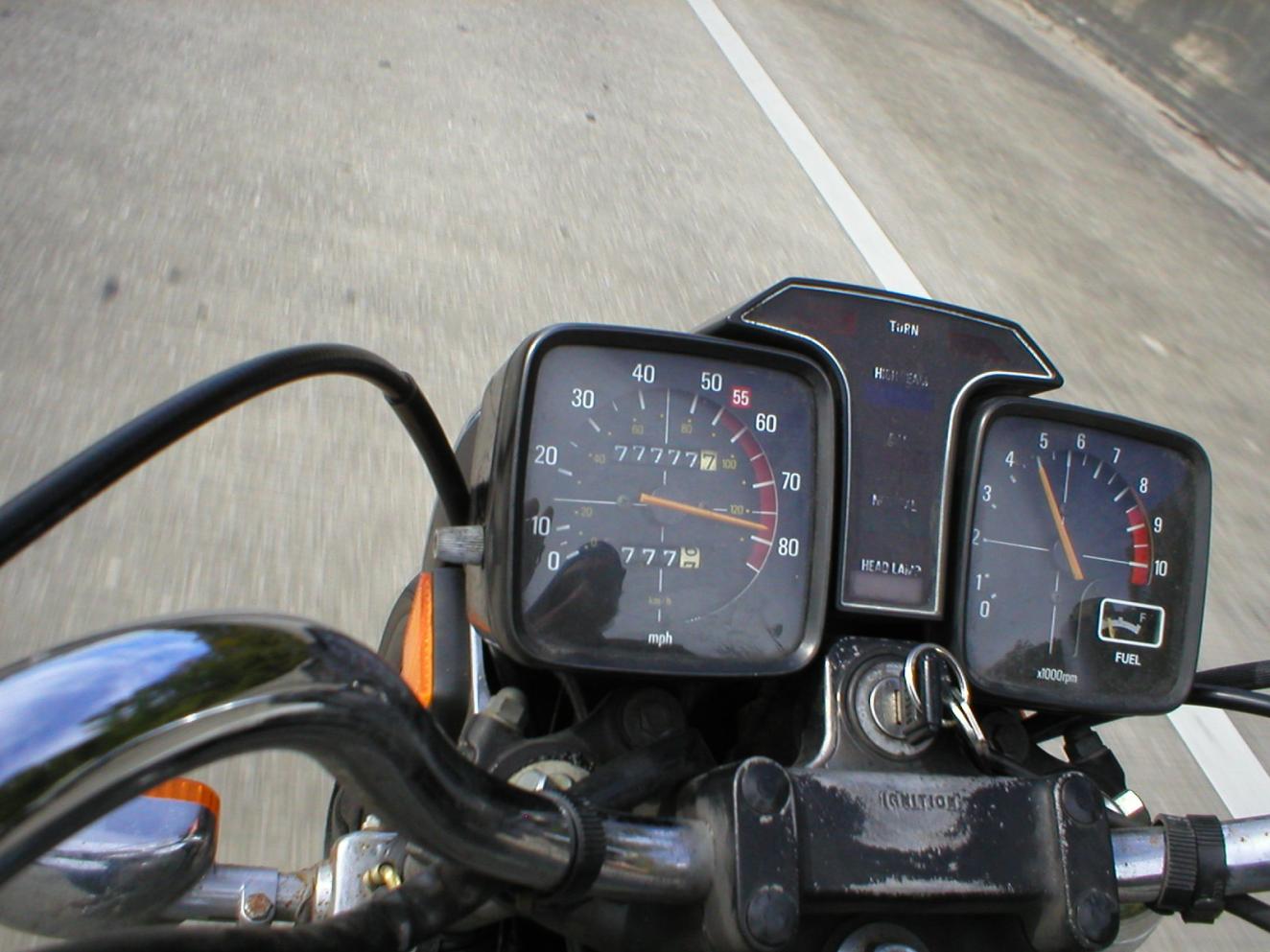

    Changed cable, was fixed for a thousand miles. Now started needle shaking again.

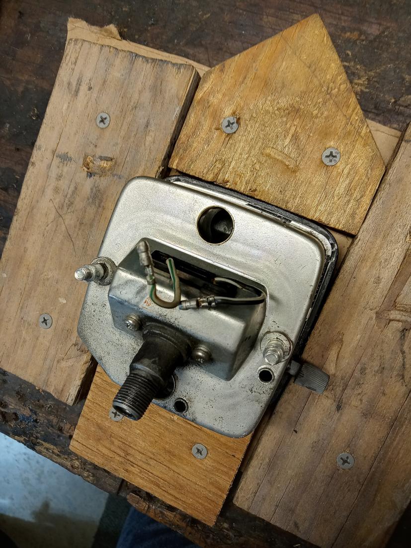

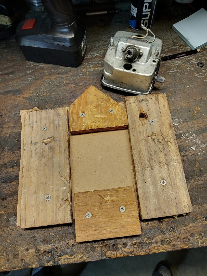

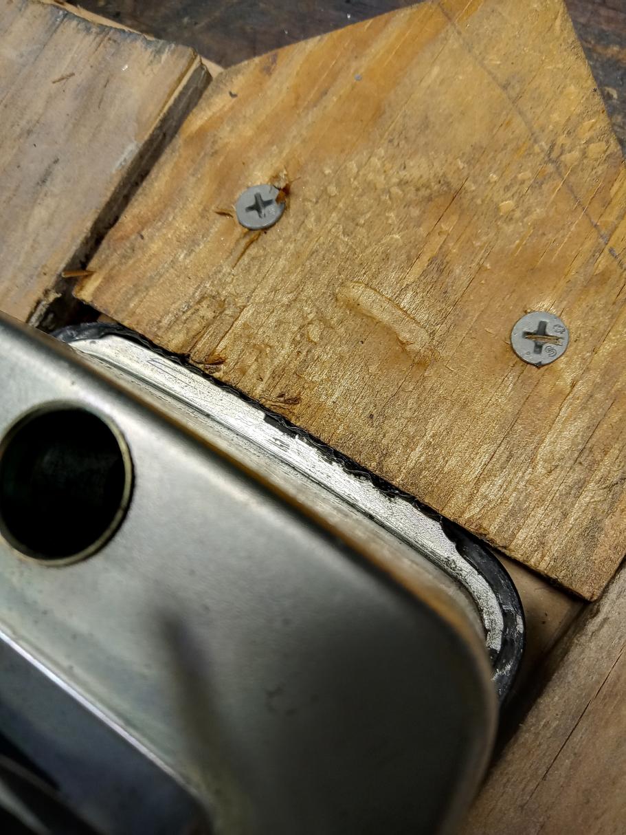

                    Here is a jig I made on the workbench to hold the speedometer housing while prying up the crimp...
                    Click image for larger version  Name:	IMG_20231015_212527.jpg Views:	0 Size:	185.6 KB ID:	883089
                    Click image for larger version  Name:	IMG_20231015_212619.jpg Views:	0 Size:	179.9 KB ID:	883090
                    Click image for larger version  Name:	IMG_20231015_213311~2.jpg Views:	0 Size:	161.8 KB ID:	883091

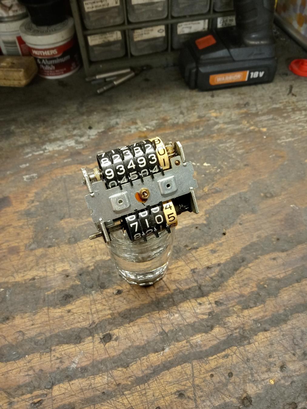

                    Once the face plate and needle are removed, then proper lubrication can be applied...

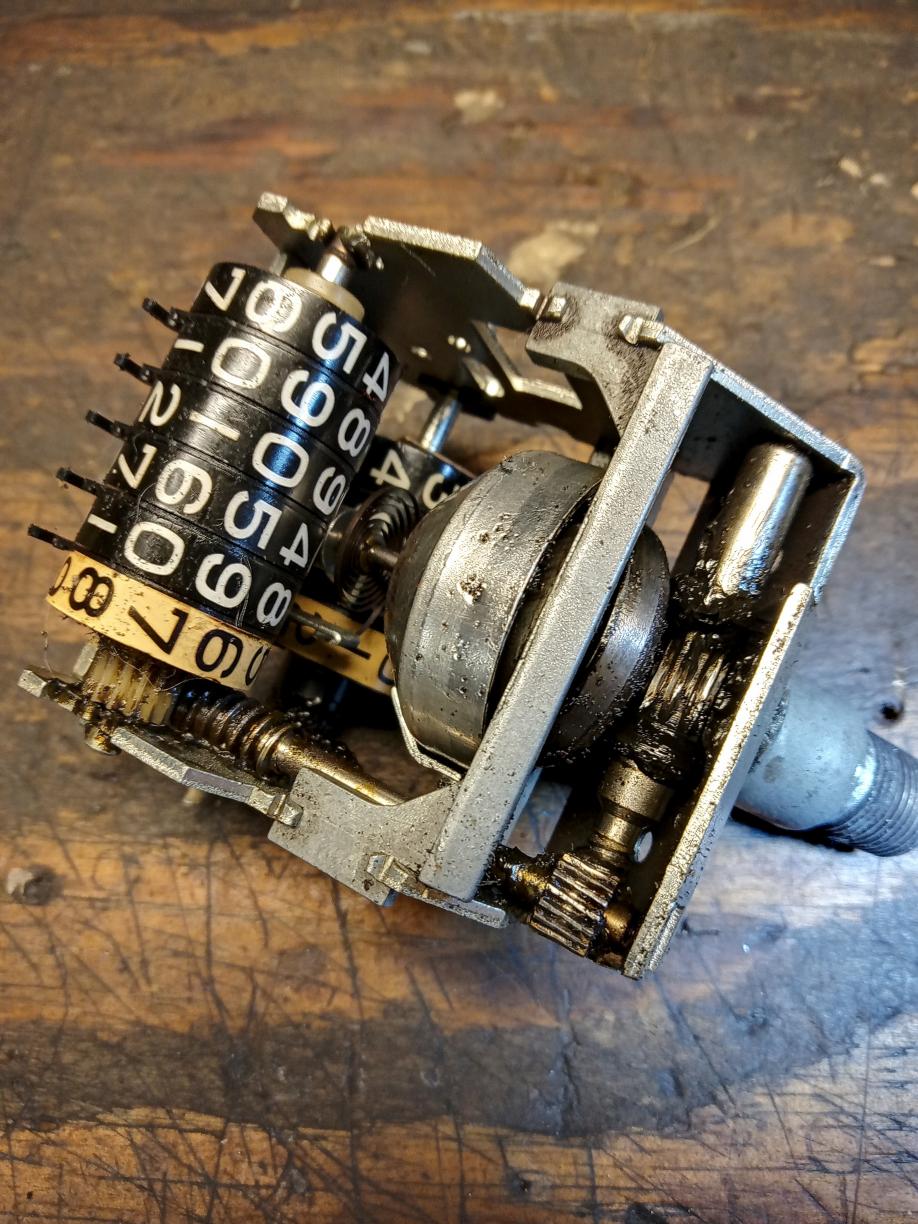

                          IIRC, the odometer is mechanically linked to the cable via the gears, but the coupling to the needle is magnetic?
                          Therefore, the odometer will be right, even if the speed might be erratic.
                            • 8833
                            Somebody correct me if I'm wrong.
                            Yes, that's correct, both the speedometer and the odometer are separate from the needle drive, you can see it here...
