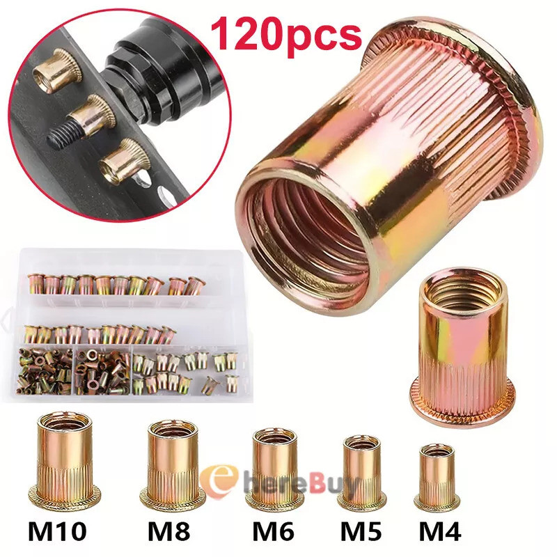

            Thanks cajun. I ordered some of these - https://www.amazon.com/gp/product/B09W61R31H/ I'll see if that works to supplement the stud and also act as the collar for the rubber damper. If it doesn't look like this will work I guess I'll try my hand at welding another bit of M6 thread on there. Getting it lined up right will be a bear, but I don't want to take the whole seat apart.

              If the stud's broken off anyway I generally just vice grip it out. I don't think there's enough meat on the seat pan to drill and tap it, it's pretty dang thin.
                Another possibility is a Nut-Sert or tack weld a nut on the pan (carefully).

                  The question is what shape is the rest of the seat in? Might be better to start with another seat unless everything else is still there. Here is a listing from Ebay 1979 YAMAHA XS1100 SADDLE SEAT | eBay. This is the seat from your model/year. If you look at the pictures in this listing you can see the rest of the hardware needed to mount the seat to the bike. The bolt you have broke off is needed to mount the actual system Yamaha came up with to mount the seat to the bike and most of that hardware is unobtanium. The listing I posted from Ebay is actually not that bad on the price for all you are getting. The cover is either original or at least original in style for your year/model. I have used nut-serts for other projects and they are very good. You would have to run the replacement bolt from the bottom up and get it locked in place in order to mount the rest of the mounting hardware you need to mount the seat. I have bought several used seats off of Ebay just for the seat pan and hardware with no regard for the actual condition of the rest of the seat. I just recovered the seat with a replacement cover. On the 79 special there was also a Yamaha emblem on the back of the seat. Do you still have that emblem? I am a purist when it comes to restoring these bikes so I like everything as it was originally. That may not be a factor for you. The reason I mention that is because the special seats on the specials were basically the same as far as putting the seat on the bike was concerned. The covers changed a bit and on the Midnights they used a stepped up version of the seat. My point is they all will mount.
