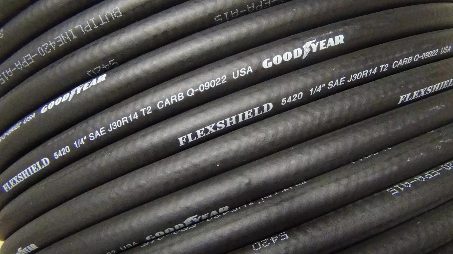

    Most Japanese bikes can use 1/4" inner diameter fuel line available at any auto parts store. Some bikes use 5/16" but pretty safe to say a 1982 bike uses 1/4". You might have to remove the carbs/airbox to get to the inlet (usually underneath in the middle of the carbs). Be careful as the inlet might not be aluminum. It might be plastic and could break if you force the old line off or the new line on.

      My 1979 Yamaha XS1100 uses a 5/16 fuel line which is also happens to be 8mm which I’m guessing was the original spec. I purchased it from Amazon.

        I buy Tygon fuel line on E bay. I also will put the ends in hot water to soften them up and then immediately put them on the petcock.

          I just replaced on my 650....T fitting is between #1 and#2 carb, it's a little easier if you remove the gas tank....dont forget petcock vacuum line
