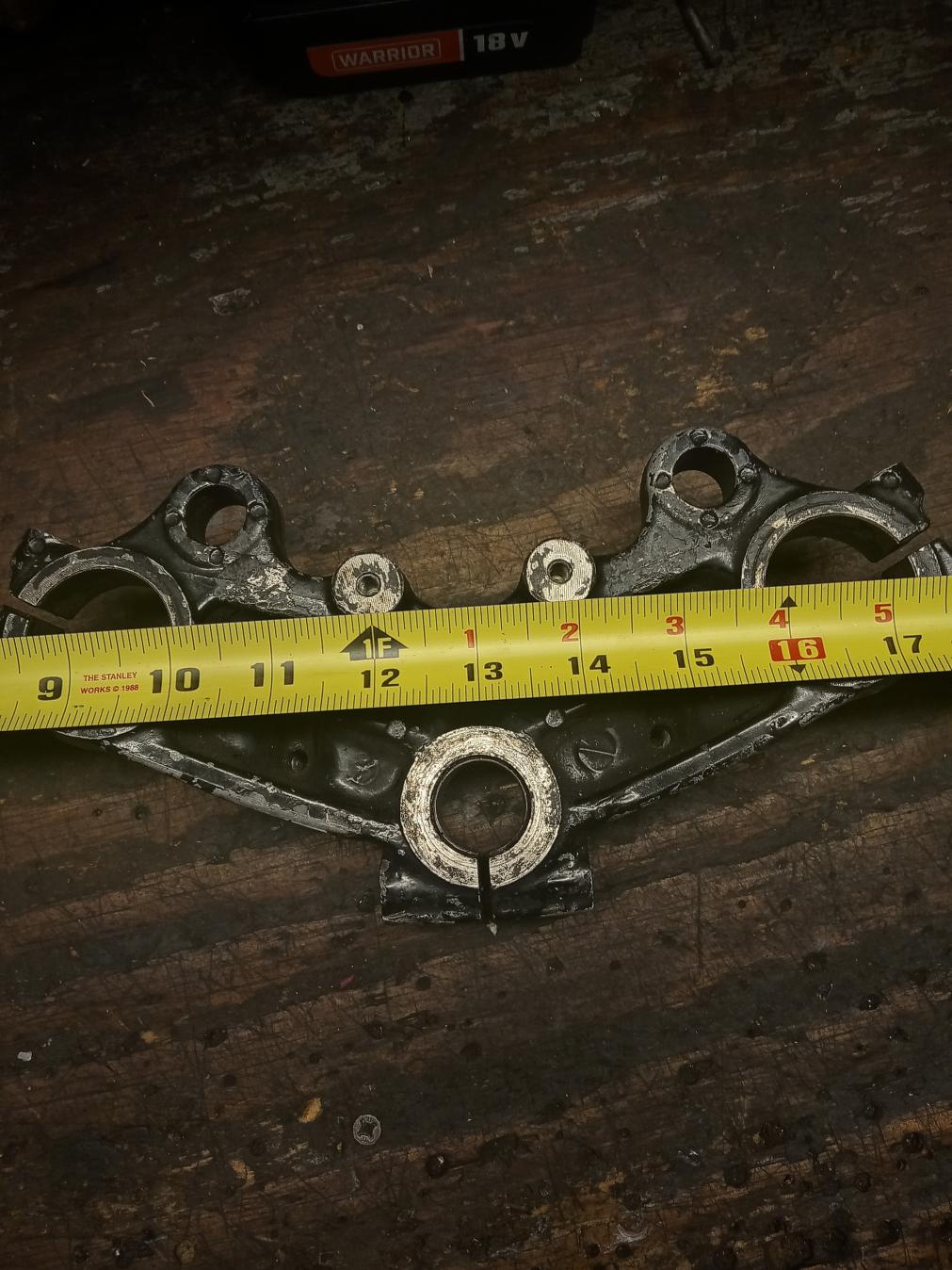

            I think this bike has the wrong triple tree or something.... Anyone else with a special mind taking a measurement of their forks like what I did in the picture below? Mine came out to right about 47.5cm.

                  I'm getting 5 13/16" between fork tubes.

                    Phil, is that triple from a special or a standard?
                      OGB, see posts 17 and 18 for special and standard triple differences. Hope that helps.

                        Thanks... there goes that theory. I just really can't see how the wheel can fit in there. The wheel is 15.3cm from the outside of the axle spacer to the outside of the speedo thingy, but there's only 14.4cm of space between the forks....
                        If the triple trees are the same width between special and standard that just leaves the wheel being wrong right?
