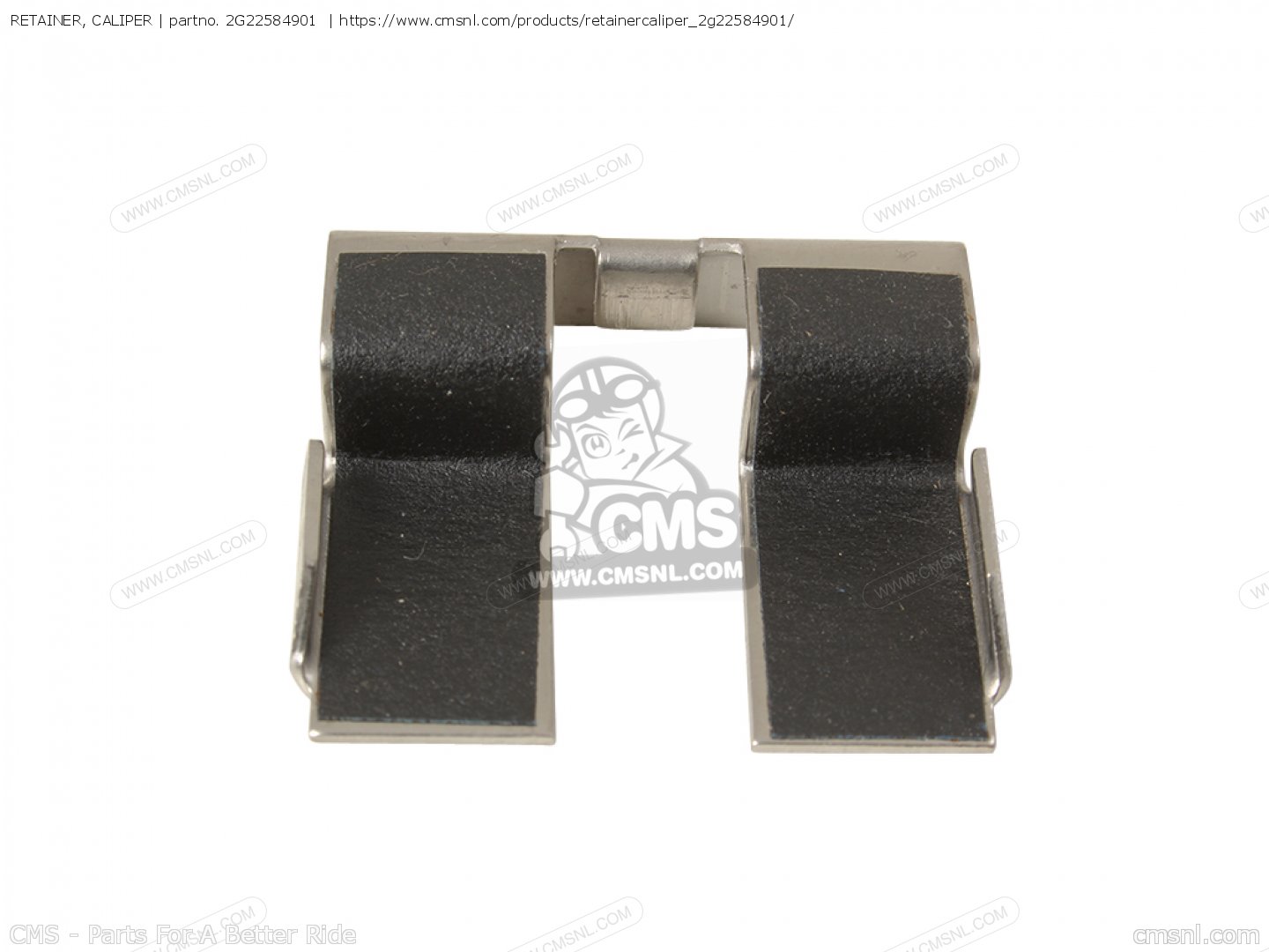

    https://www.cmsnl.com/products/retai...er_2g22584901/

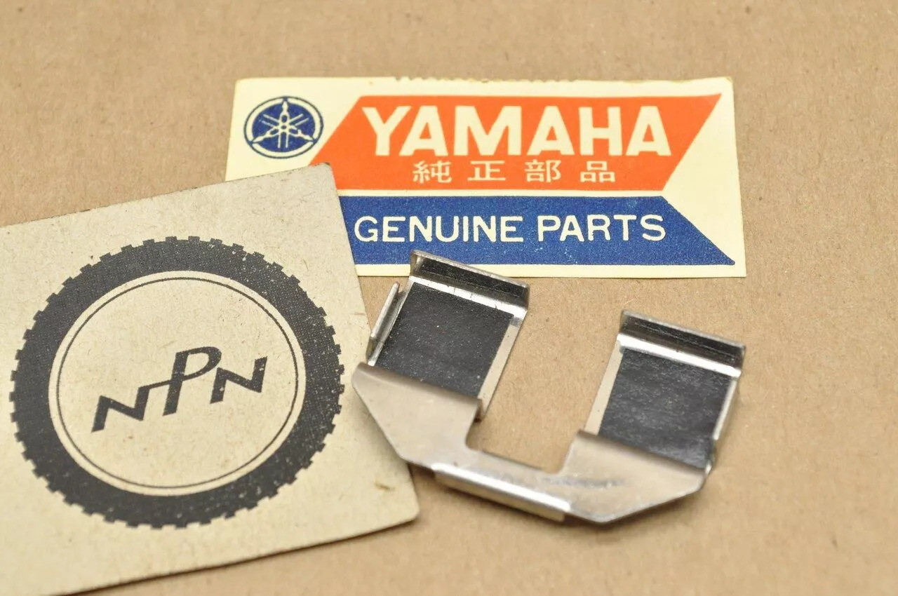

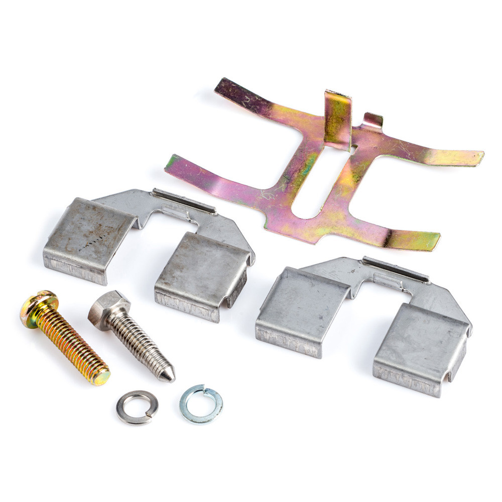

    Looking for this part, I need 2 of them. Haven't had any luck finding em
    This kit contains 3 brake pad shims and the retaining screw. Long since unavailable. The shims fit into the caliper to support the brake pads on models using the single piston calipers. Suitable for: XS1100 1978-1980

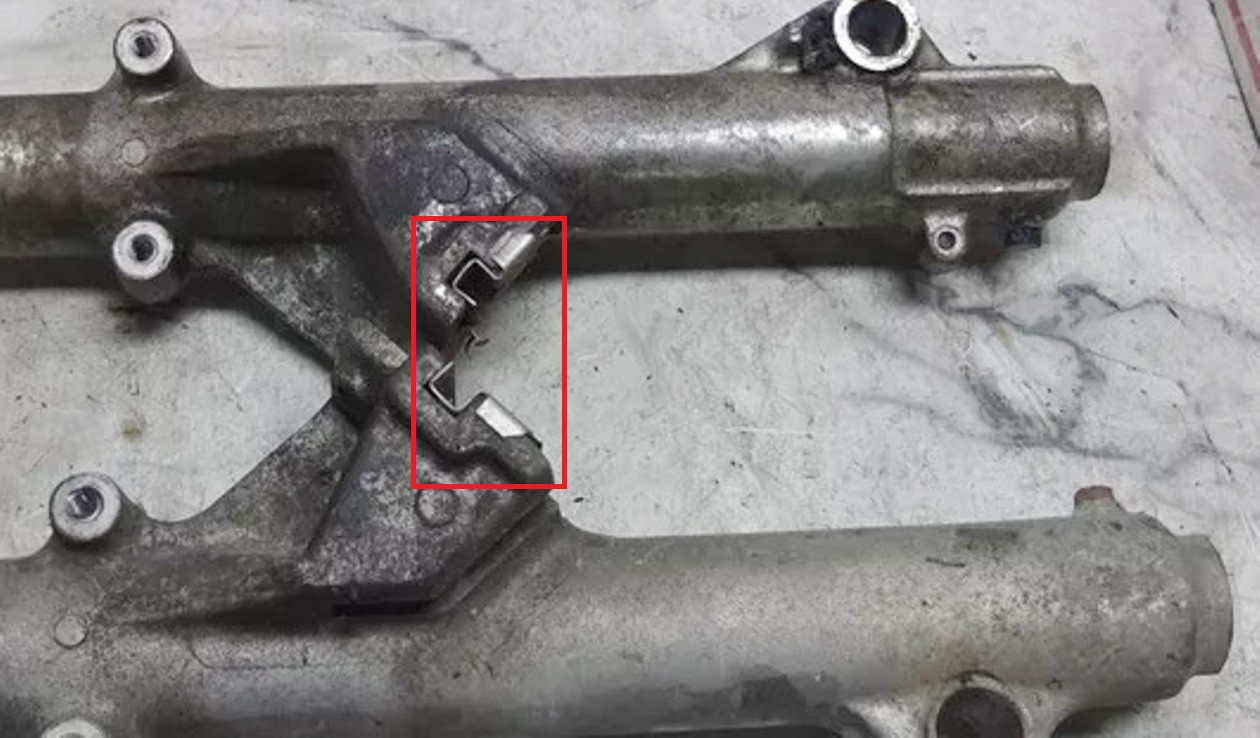

      Thanks, wish they'd put the part number in the item listing so that would show up in google searches. I didn't even think about Yambits having em. Cost me $40 which sucks but at least I'll have em.
        I believe this is correct. Same part on all Yamahas of that era.

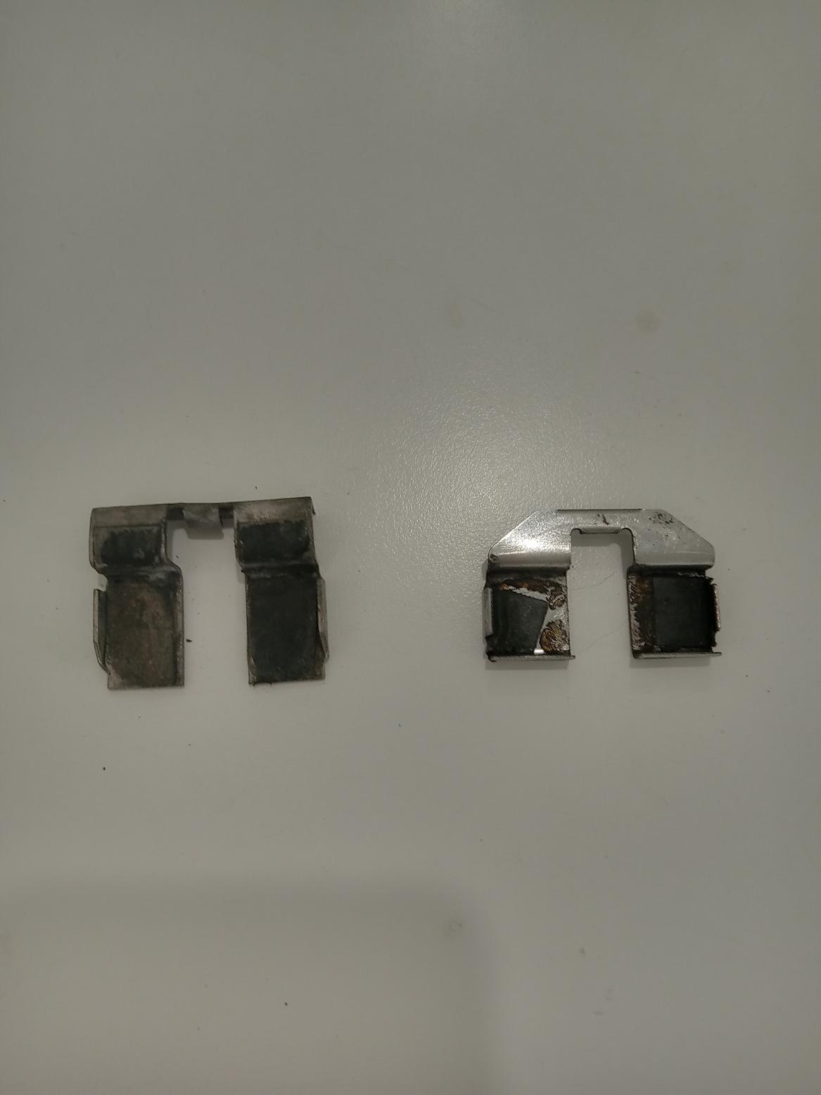

          There are 2 different types you know, one for the Special front forks, and one for the Standard fronts which also fits all the rear calipers. The one for the Specials front on the left of the pic....
          Click image for larger version  Name:	IMG_20240626_142408.jpg Views:	0 Size:	67.4 KB ID:	880450

                      This is the metal plate between the pad and the piston sometimes referred to as the shim. They came stock on early XS11's but were discontinued on the later models. My 78 still has them installed. You can see the circular impression from the caliper piston. You can also see the retainer clips on either side of the pad to aid in self alignment of the caliper as the pads decrease in thickness. The red color is an anti-squeal chemical.
                        This is the XS11 Special set up from Ray's eBay jump-off.

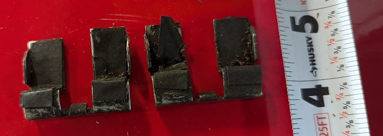

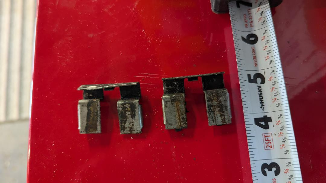

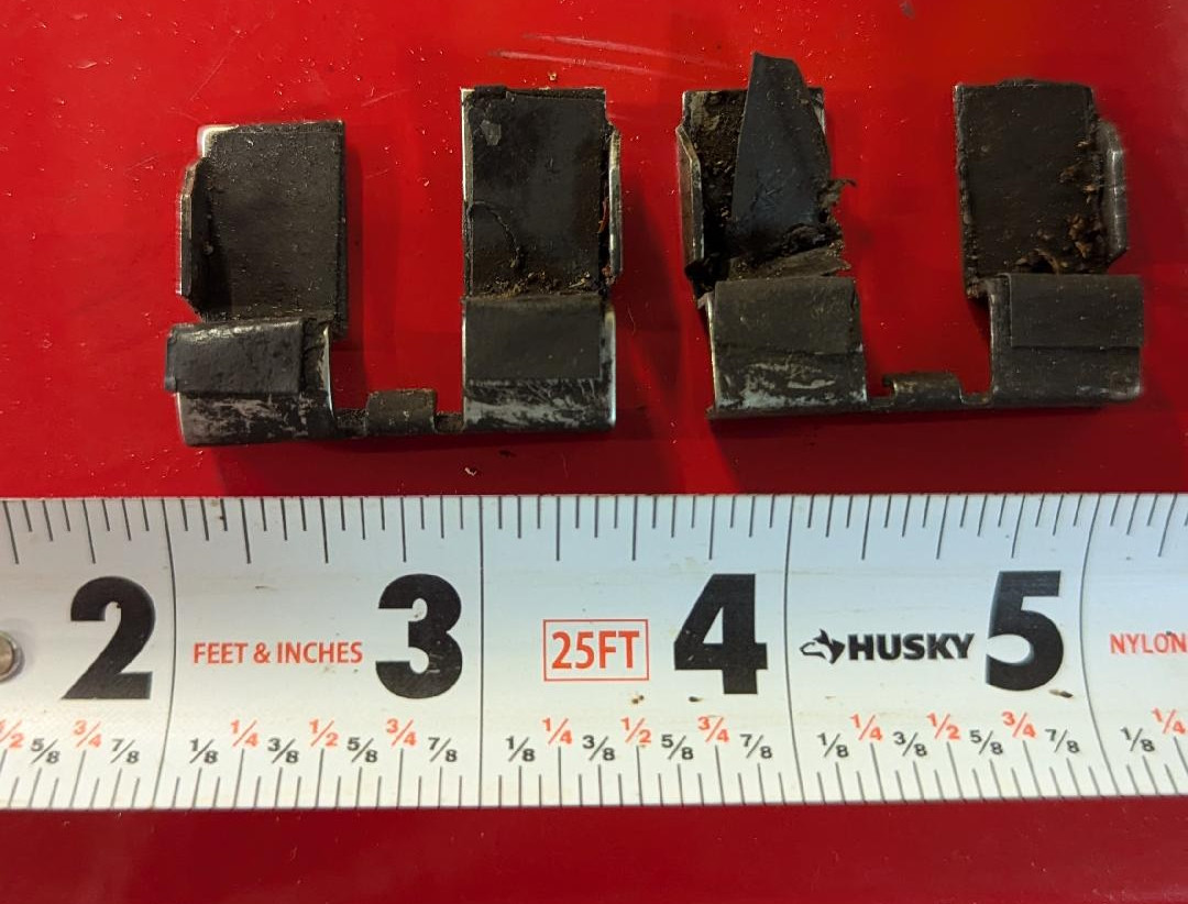

                              Hey Old Grey, Just found these today. Let me know if you still need them?
ID:	880592 Click image for larger version
ID:	880594 Click image for larger version
