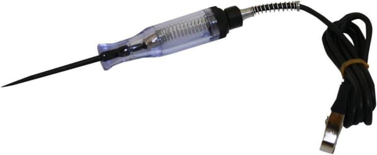

              3. gOt one of these?
              Just a DC test light to see what's HOT and what's NOT. Useful thingy to play with at this time.

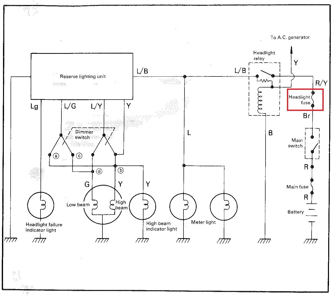

                        That points to this.

                          I traced that line the best I could I couldn’t ever find where that was though. What’s it look like?
                          edit: Nevermind I’m dumb lol I’ll try replacing it that’s the one that’s only half way Lightning up

                            Right! The OEM Fuse Box! (☞゚ヮ゚)☞

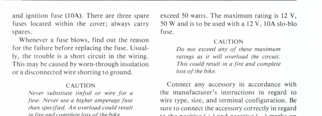

                            I gleeped this from the fOaR FREE service manual I linked to in muh very foist post in this thread....
Name:	Screenshot 2024-06-20 12.01.02 PM.png
Name:	Screenshot 2024-06-20 12.02.10 PM.png
