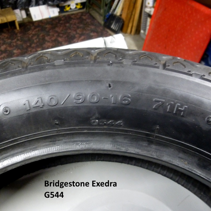

          I don't know how much difference there is between the standard and special tire clearances but If this helps:
          I had the tire pictured (140-90-16) on a midnight special which normally has the 130-90-16 on the rear.
