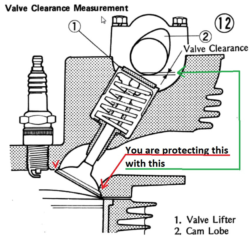

            The valve lash DECREASES as it wears. With tappet valves, they would INCREASE. You now see the difference.I always set my valves as close as possible to the high end, even over a little bit, 0.26. A little noisy at first, but they ALL wear down as the valve keeps pounding the seat. With these bikes, a little valve noise is good, and no noise can be a big problem.

              Above all else you need the valve to sit closed and tight on the valve seat when the cam lobe is faced away from the lifter. It needs the gap to compensate for heat expansion. If there is too little or no gap the valve can stay slightly open and burn the seat because of escaping combustion. Very bad. It also reduces compression for a loss in power. Use the motor long enough in this manner and even a proper valve adjustment won't bring back compression because the seat is pitted and damaged. This is when the head has to come apart for a proper valve job by a machine shop to re-grind the seat and possibly replace the valve guides depending on wear.
