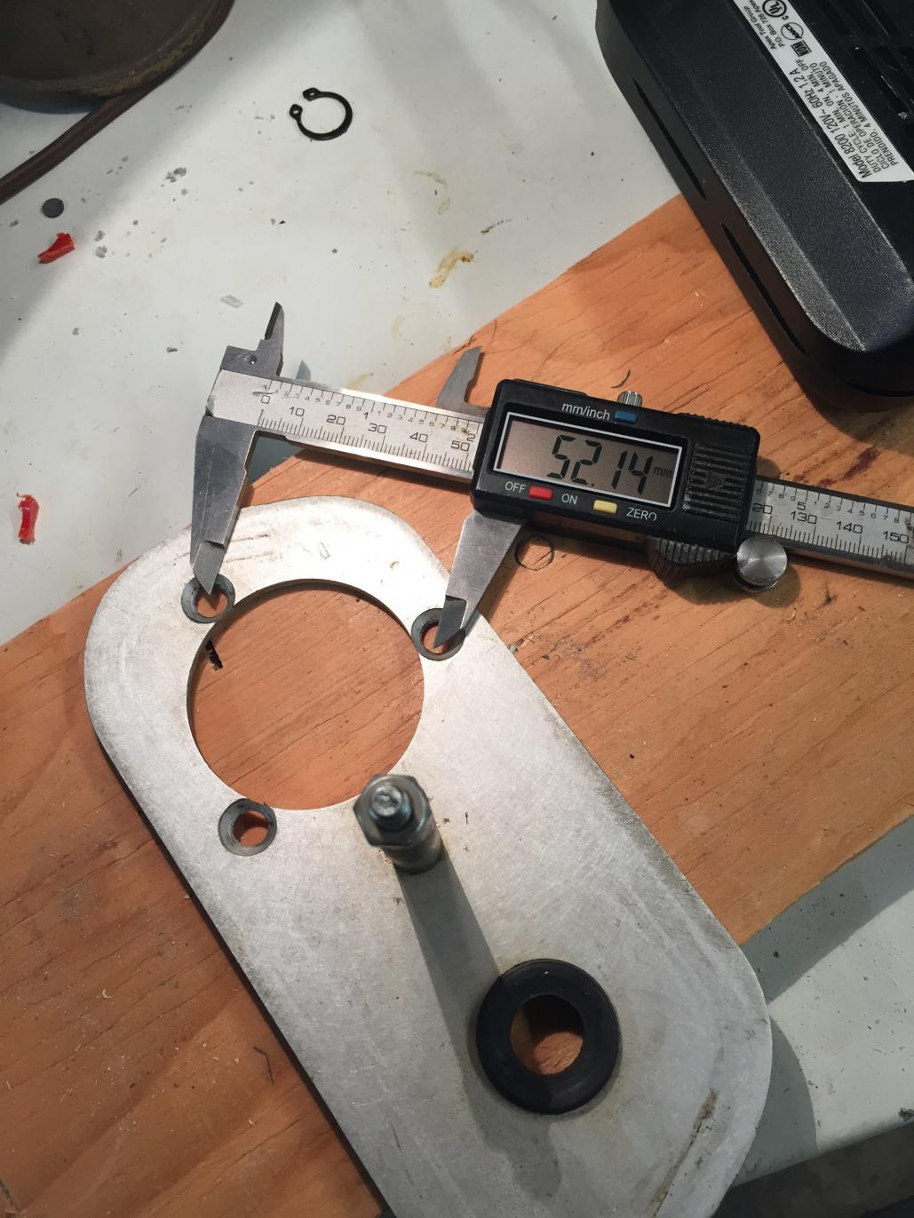

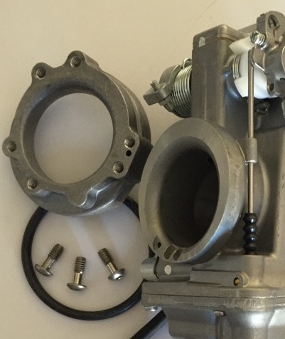

                          Originally posted by Mathh
                          Swapping to the Mikuni RS42 would be a good idea as the original ATP carb operates in a tiny window (sometimes no window). I always found it hard to adjust both adjustable jets perfectly. Most of the time it was perfect in the higher regions or in the bottom region. I think it is a plus if you can convince the owner to put it on before the bike goes on the dyno. I have a RC Engineering kit which also has a good (Keihin) carb.It has a bigger float chamber, a choke(!) and a acceleration pump and at least one fixed jet. Not sure at the moment. Sadly they are hard to find.
                          done! Have an hrs42 on the way with a handful of main jets and pilots.
                          Carb hasn't shown up yet. Then the fun begins. The rubber mounting flange might work, the studs on the turbo inlet are 65 mm centers, hopefully I can wallow out the rubber flange without affecting the port.
                          It’s a Harley hsr kit that comes with the air cleaner adapter hopefully the plate I have mounts to it with little or no modification. Figure it should fit since the zenith was on Harley’s as well.

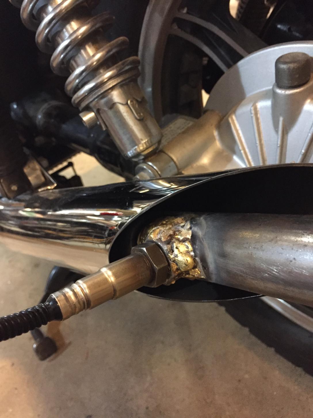

                          I just guessed on the jets based on what a couple of Kawasaki guys with similar cc'd / year engines are running on their turbo set ups. I’ll road dyno before going to the experts Click image for larger version

                              Good to hear you found that 42mm carb. It should not be too hard to make (or have them made) a new air filter to carb and carb to turbo adapter plate / flange. Always better to get a perfect fit. That lambda sensor position is questionable. If that pipe is shoved into the mufflers and not sealed or welded it will give false readings as it will suck in fresh air when off throttle (or idling). On my Mr.Turbo kit it even sucked in fresh air through the worn threads of the two holes that hold the heat shields. Great to see at night however when it spewed long light blue flames out of the exhaust when closing the throttle.
