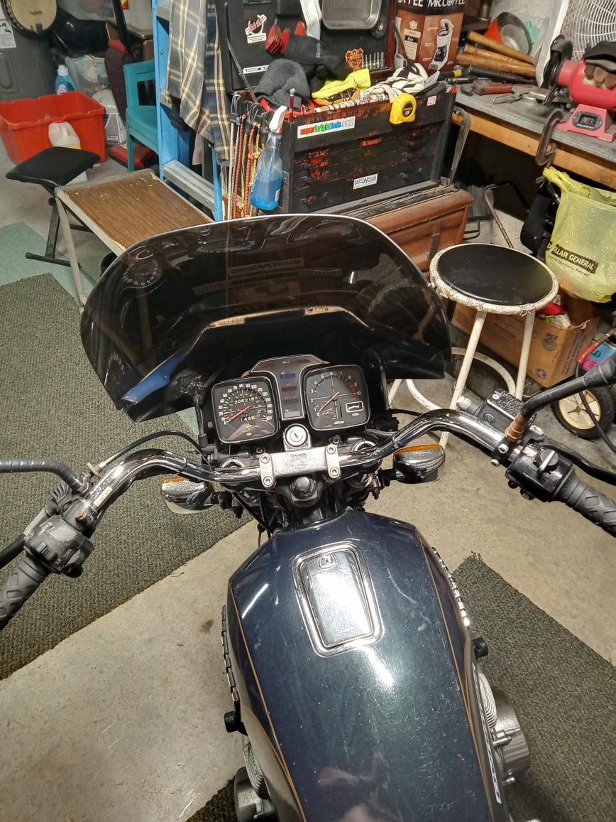

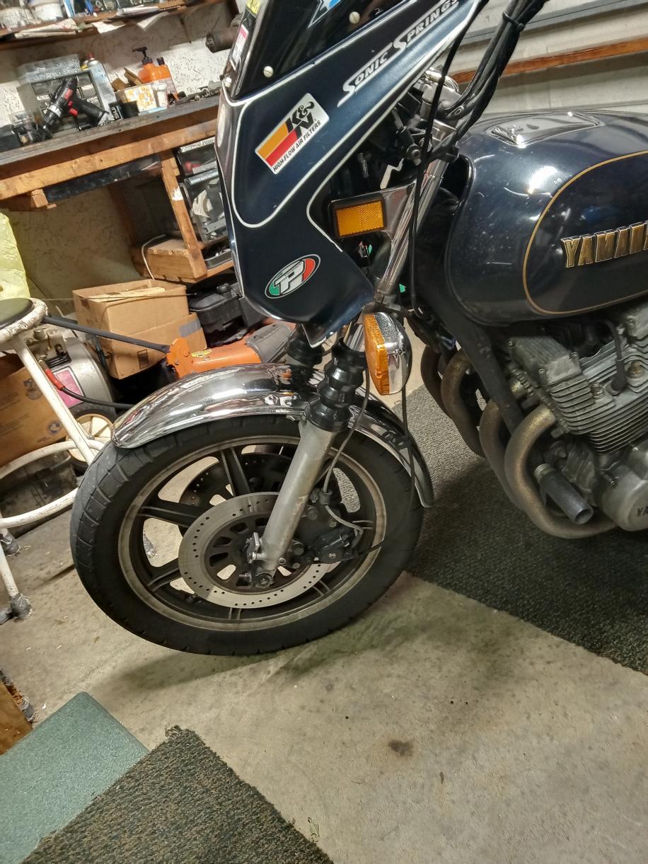

          This is what the bike looks like now with the FJ forks and normal tubular handlebars...
          Click image for larger version  Name:	IMG_20240110_174534.jpg Views:	0 Size:	207.0 KB ID:	877025
          Click image for larger version  Name:	IMG_20240110_174507.jpg Views:	0 Size:	197.5 KB ID:	877026
          I have easily ridden over 100K miles on these, rebuilt them a couple times over the years.
