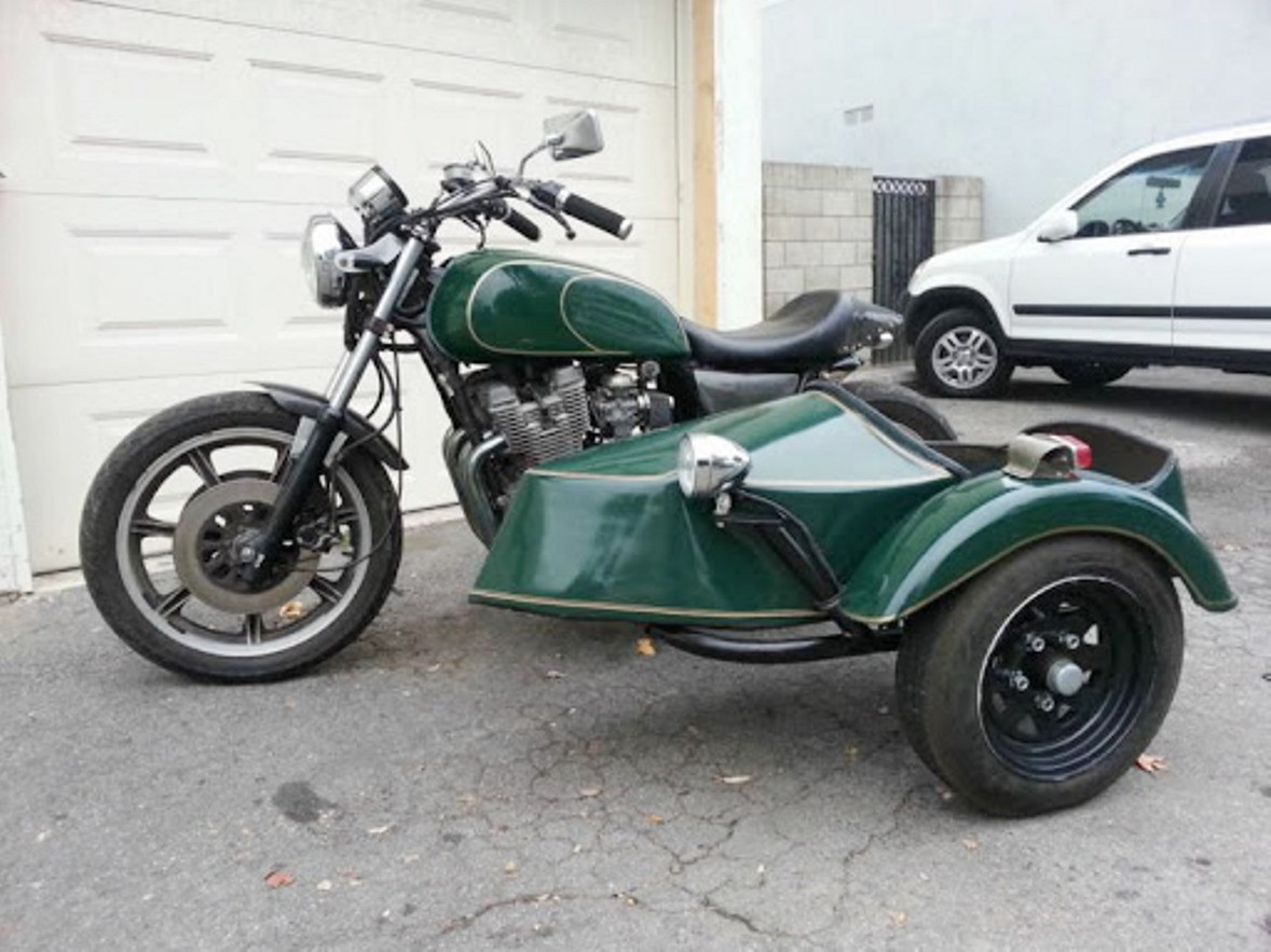

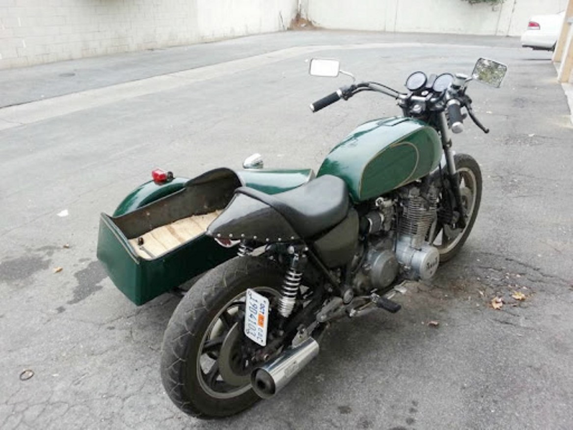

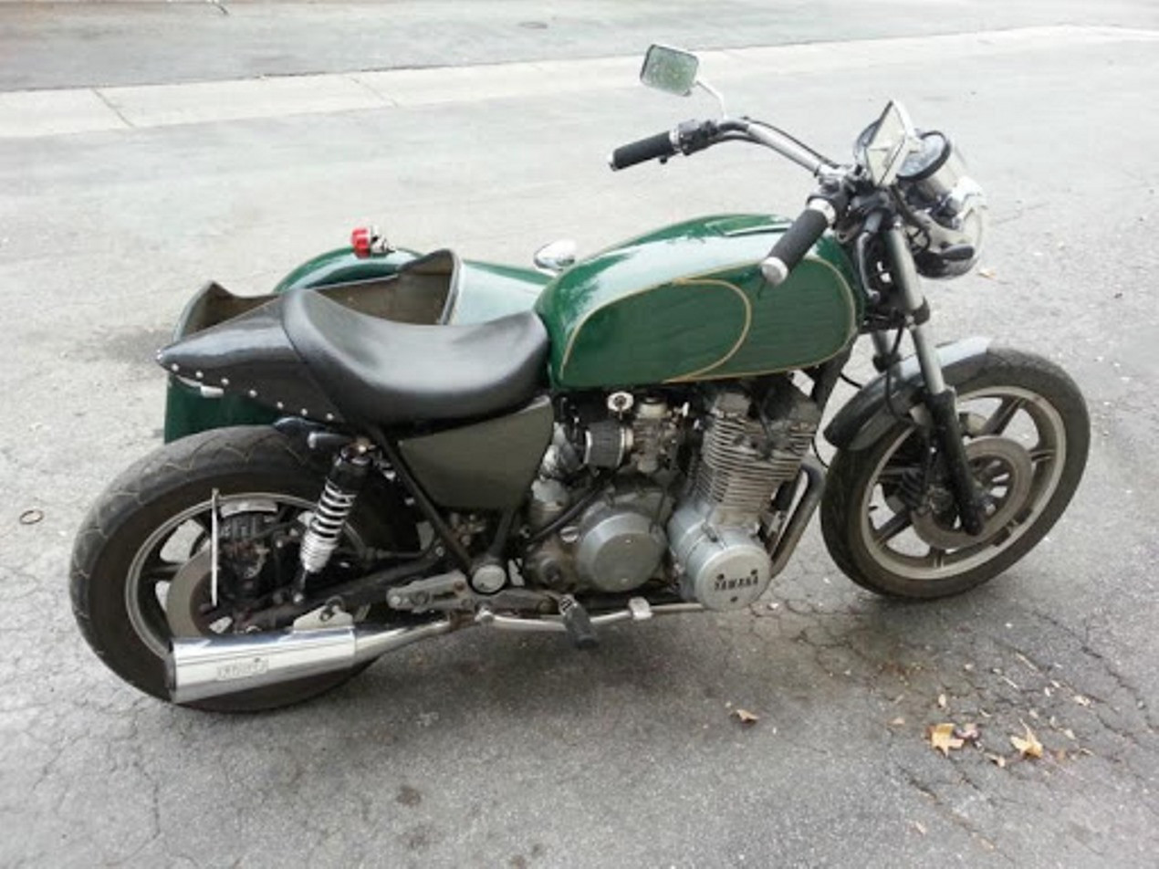

      Another one...
ID:	876857 Click image for larger version
ID:	876858 Click image for larger version
