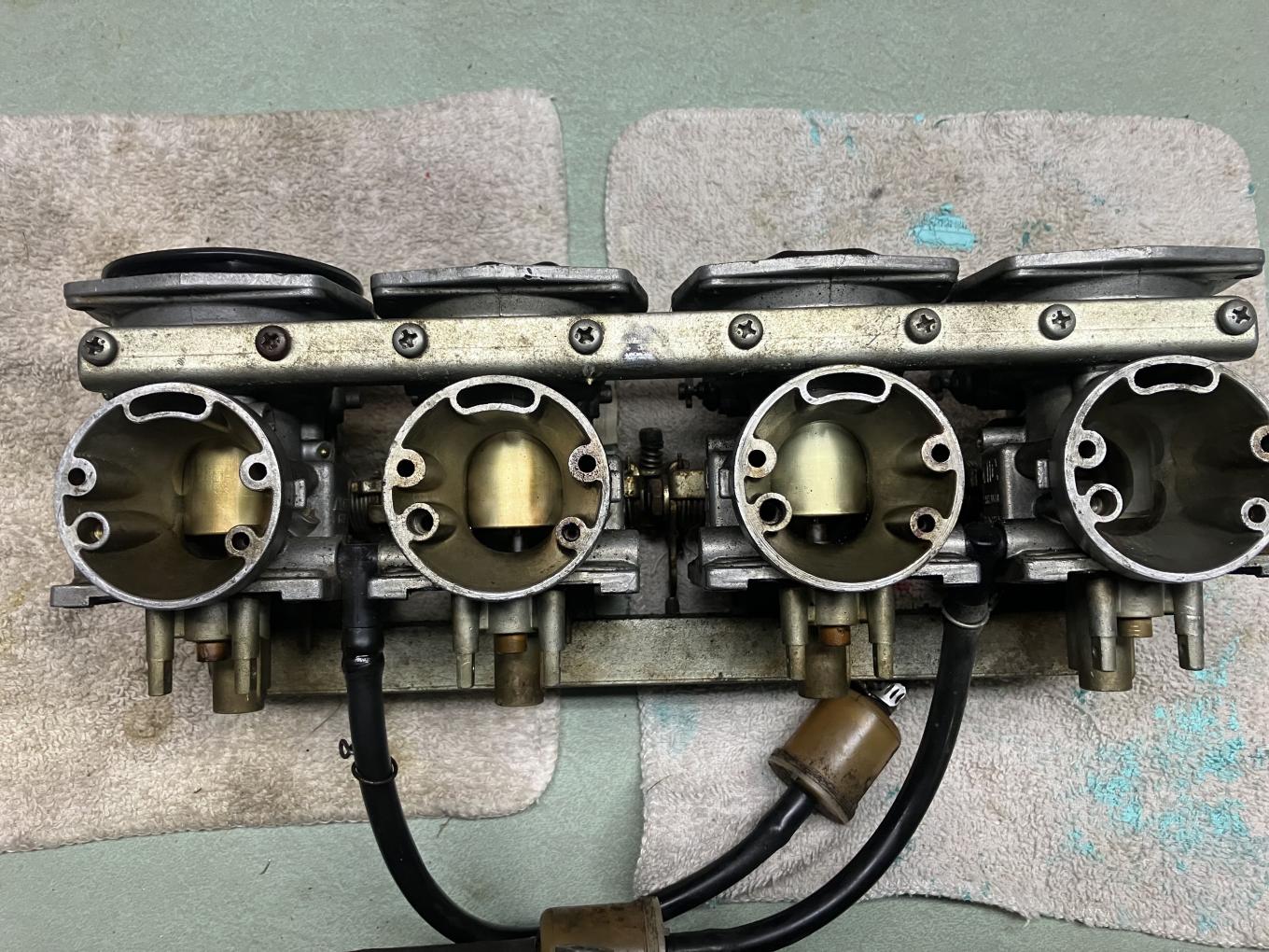

          I'm puzzled.
          The slide on #4 came out easily enough, but nos. 1-3 won't budge. They WILL rotate, though: when I pull up the diaphragms, I can turn them, and the slides turn with them. But they will not go up or down. Wiggle a tiny tiny bit, maybe, no more than that. I tried very gently prying them up, but figured any real force would be an excellent way to damage the carbs.
          Thoughts?

            The needles are probably stuck in the emulsion tubes. With the carbs upside down, I would soak penetrating oil down the main jet towers, let it sit overnight.

              A good soaking with carb cleaner finally freed up two of them, and I'm hopeful the last one will pop free in the morning. Thanks, all.

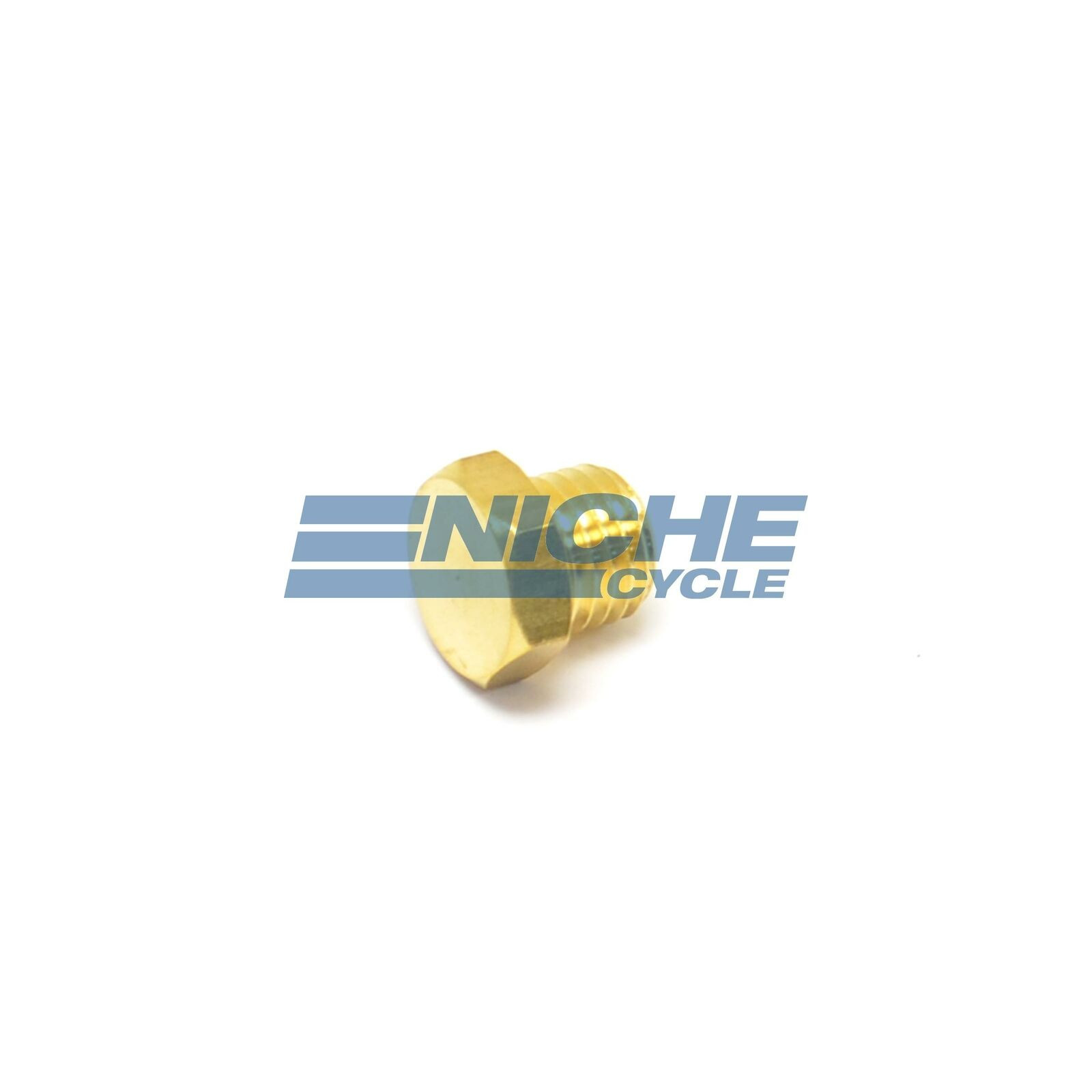

                  And speaking of those drain plugs, can anyone give me some guidance on how to source the right ones? I've looked at a lot of sites, and nowhere do I see an image that resembles my poorly-designed hex head brass plugs. Picture below. (And while we're on the subject, what were they thinking? How can I do a float level test with such drain plugs??)

                    Search Ebay for 1A8-14991-00. You will see screws which are wrong and you will see bolts. You will not like the prices. You should take one of the ones you have that are in good shape and go to a Lowe's, Home Depot, or Ace hardware and match it up to a bolt. The biggest problem might be the bolt will be too long and you will have to trim it. I would suggest stainless if you can find them in the right size but, a bolt that size will be tough to cut down, however will be more resistant to rusting.
                      These are a bit better price:
                      https://www.ebay.com/itm/172916041539
