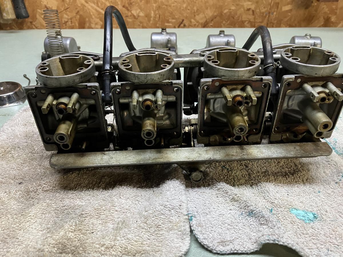

                  As before, I'm grateful for the suggestions and offers of help. Here is the pic of my carb bank at the moment.
                  I should also mention that about half of the sixteen bolts holding on the float bowls are boogered, and same with the bolts for the diaphragm covers. I'm assuming that these can be had easily enough at a good hardware store. The slides are frozen solid on three out of four, and are currently soaking in PB Blaster.

                    The carbs you have are the later 1980 carbs. When you source parts make sure you are getting parts for that year model. You can do your searches for the 1980 SG model. The reason those screws are probably messed up is because someone probably tried to remove them using regular Phillips head screwdrivers. If you are going to work on the bike you should go ahead and invest in a set of JIS (Japanese Industrial Standard) screwdrivers. They fit those screws perfectly. Another good tool to have handy is an impact driver. Again get one with the correct size bits. The replacement screws can be found at ACE hardware or Lowes. If Lowes has them in stock they are stainless. You can also go with stainless allen head screws but you have to be very careful about over torquing those and stripping out the carbs. Very easily done so be careful if you elect to go that route. Where are you located?

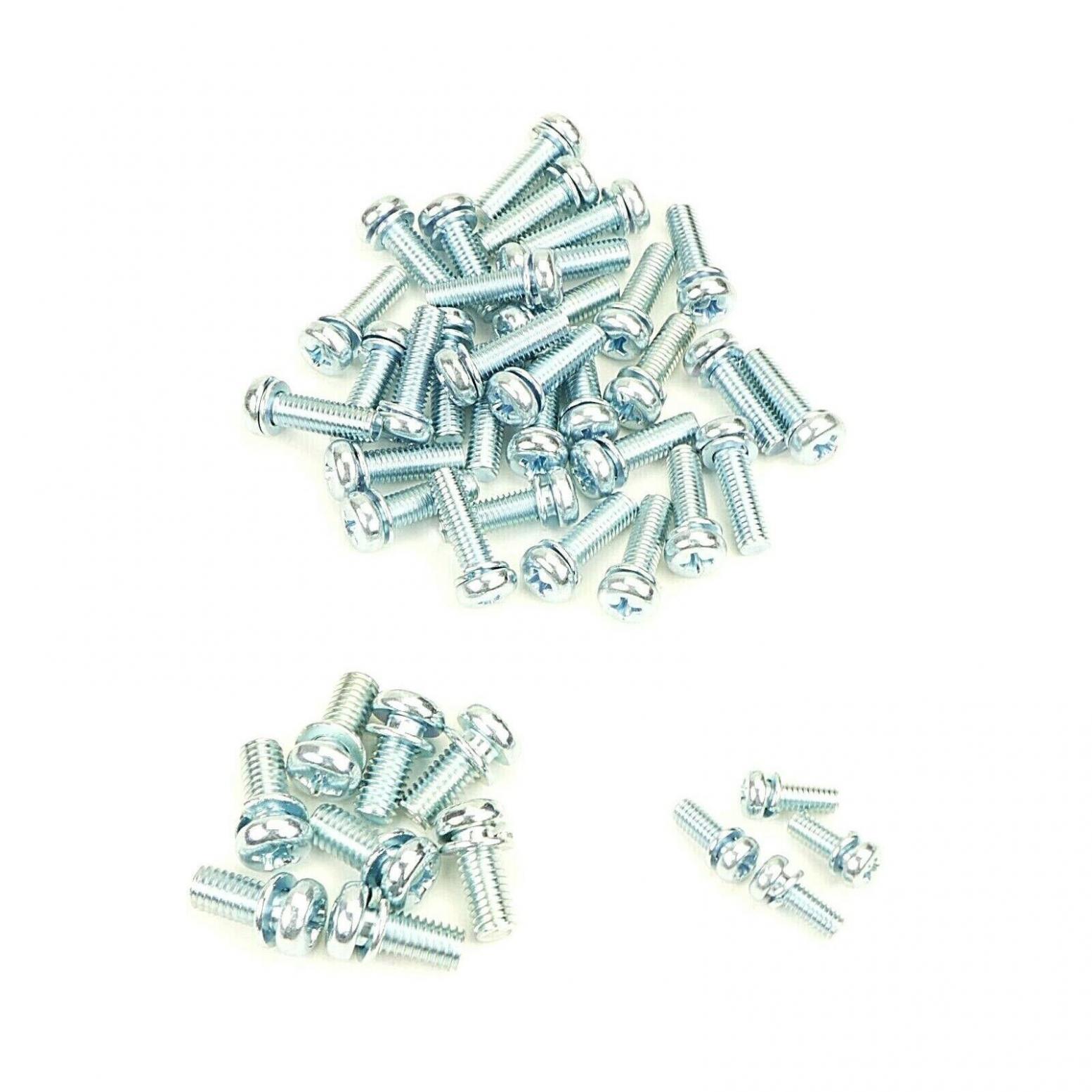

                      The screws for your carbs.
                      https://www.ebay.com/itm/19536215292...3ABFBMnMXq3pJj

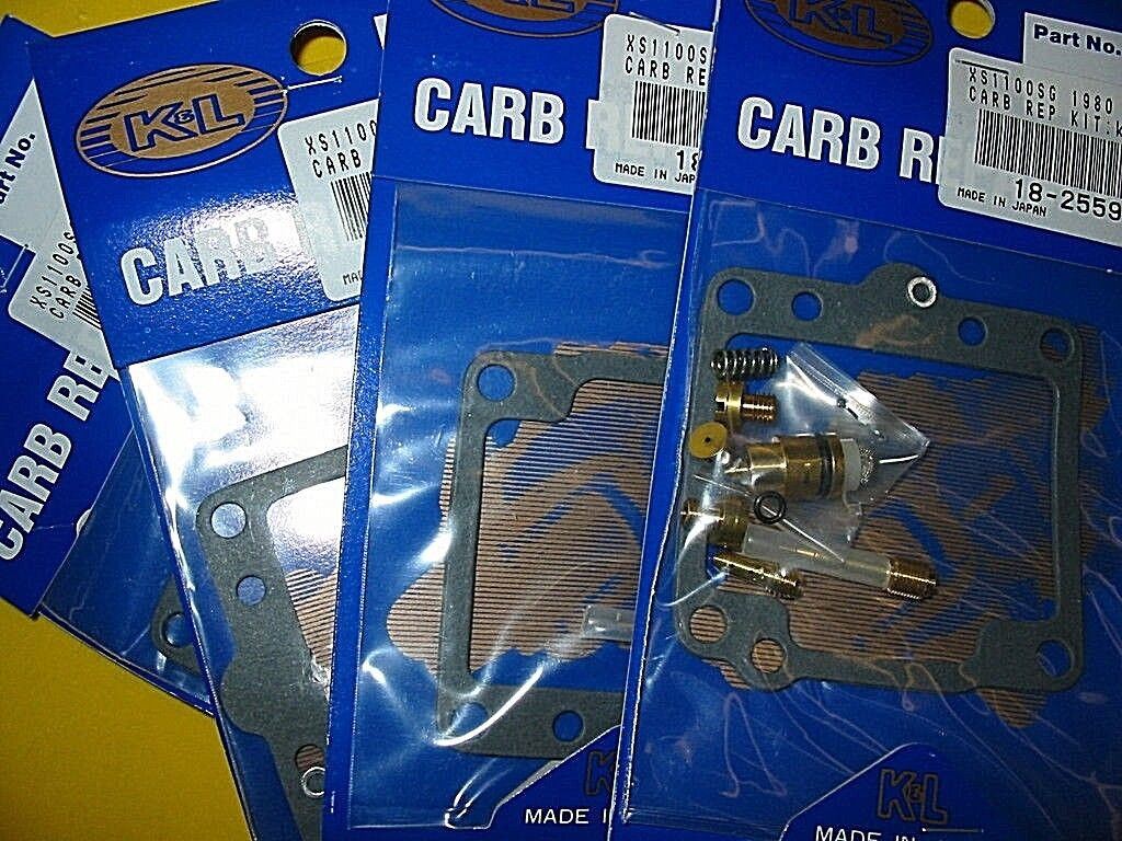

                        I have good luck with the gaskets in these kits. They are Japanese made.
