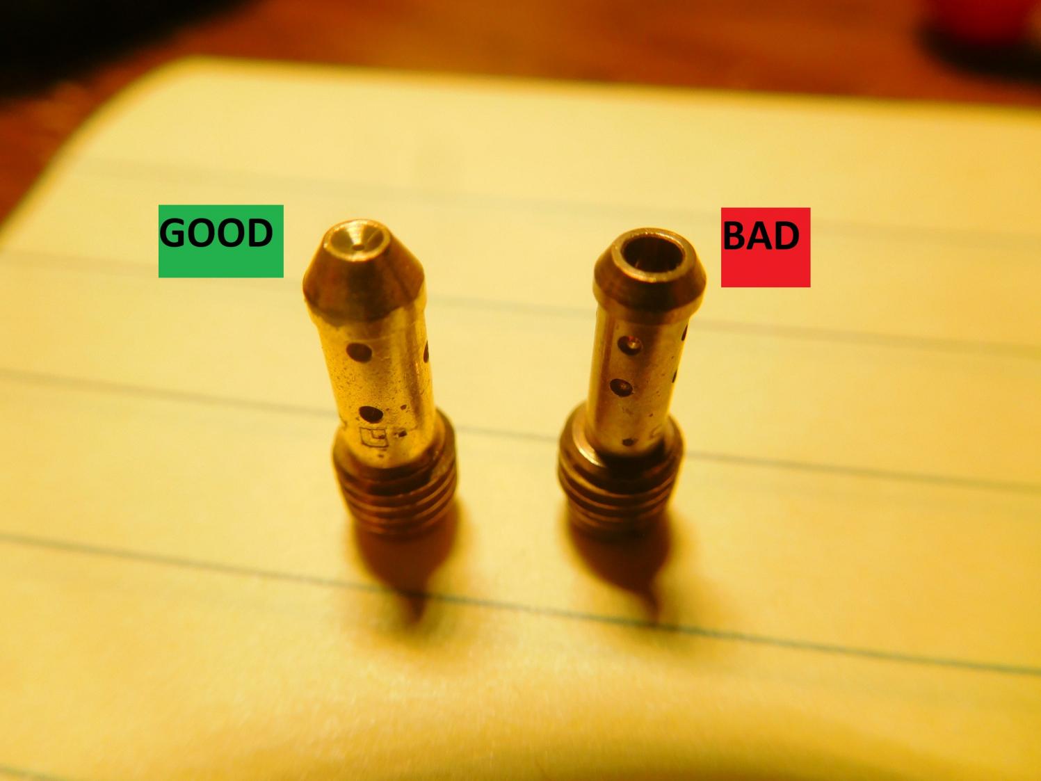

      Good tip vs. bad tip (ignore the side holes).

        Correct pilot jet specs.

          Thanks Deebs. Yep I learned a while ago on my XS500 about those VM style pilot jets where the metering orifice is down at the thread end of the jets, totally wrong for the BS carbs! All of mine both hole and no-hole have the metering hole at the tapered end.
