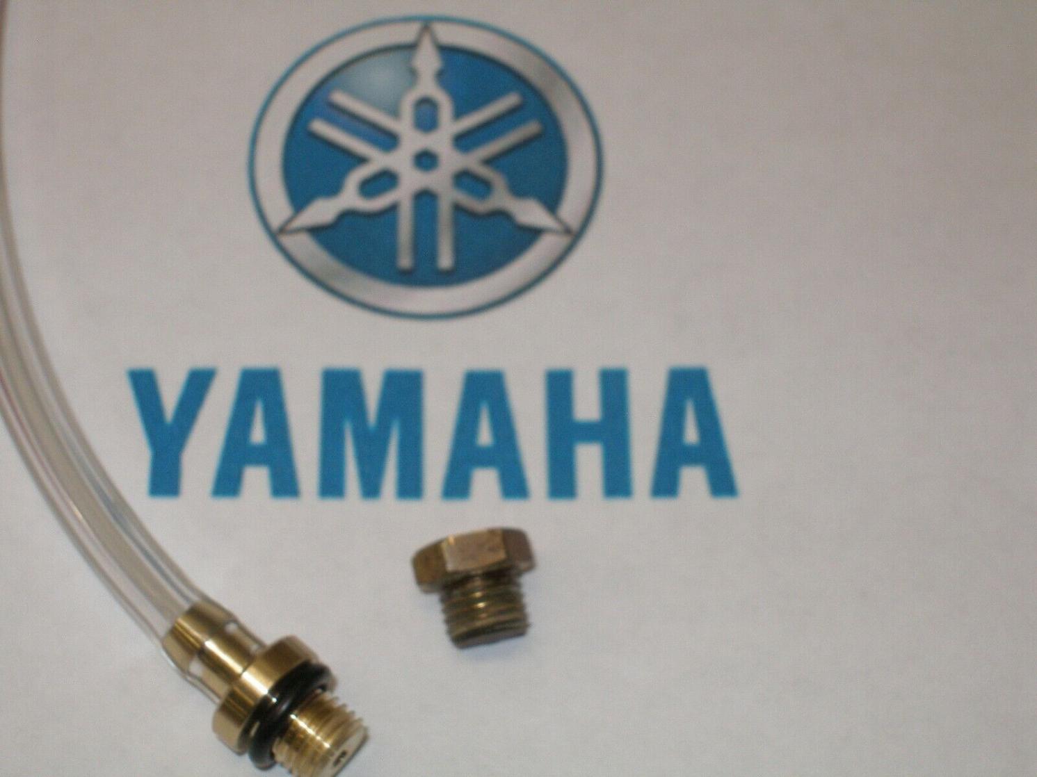

            My '80 carbs have the press in style float seats but yes I put new viton o-rings in. I'd love to do that level check from the float drain, where did you get that handy fitting for the drain screw?

              eBay.

                As an alternative to purchasing drain plug fittings, I bought clear tubing at home depot that was about the same size OD as the drain plug threads (maybe just slightly bigger. You can then thread the clear tubing directly into the carb bowl’s drain plug opening. I like to do all four carbs at once, with four pieces of tubing. The soft tubing becomes self threading as the threads cut into the plastic.. I’ve done this several times, but only with the carbs off of the bike and filled with water rather than gasoline, in case of a leak. It worked well for me.
