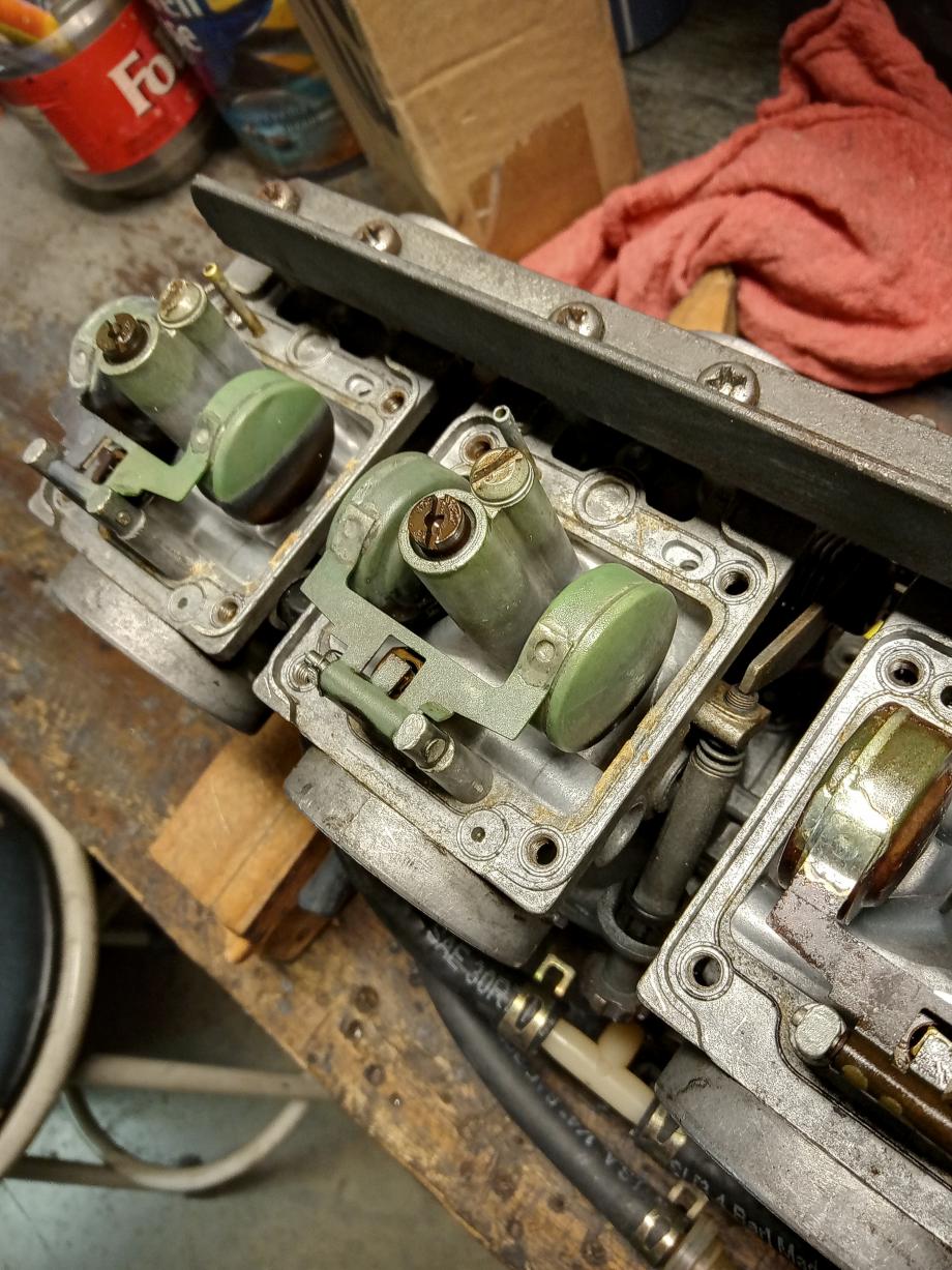

                          Here's what ethanol can do to your carbs in just 3 months. This is in the very high humidity of a Florida summer, probably not as bad anywhere else. Of course the pilot jets were plugged.
