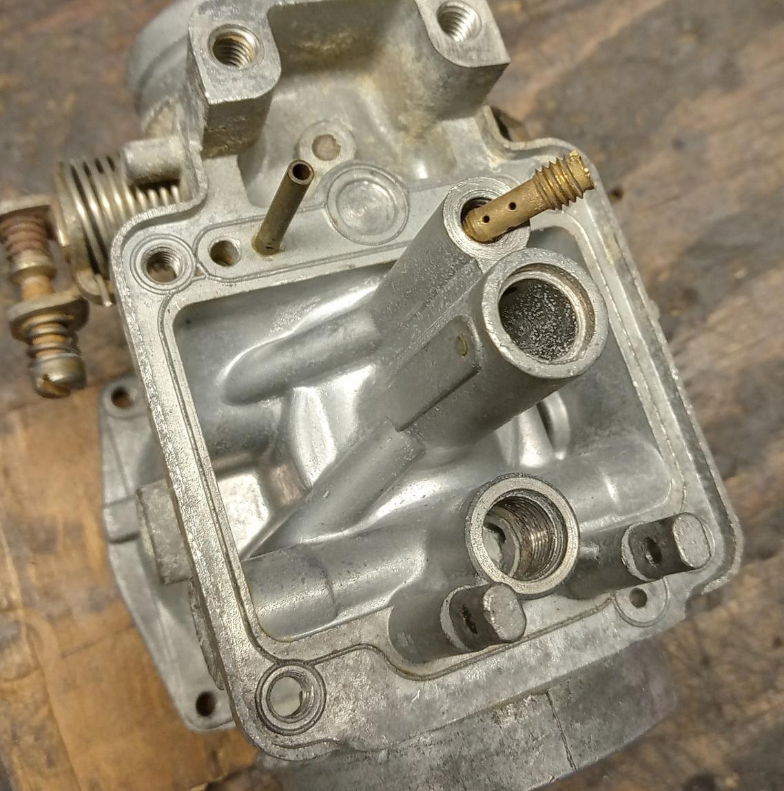

    When cleaning the carbs, did you remove the pilot jet (one down in the tunnel) to clean it and verify, holding up to the light, making sure the nozzle is clear? How about over 4K RPM, does it heat up then?

        Not the emulsion tube, the low speed pilot jet, as shown...

          Oops, yes that is the part, I removed it, and it was clean. I blasted cleaner through all openings. I considered it could be a faulty diaphragm on top of the slide that's causing the weak vacuum- but held it up to the light showed no holes. I have considered a stuck or cartooned up intake valve, too, but with the good compression, I am doubting that now.

                    I believe Phil is on the right track. That pilot jet can look clean and still not be. I had this same problem on a set of carbs I was working on and until I actually replaced that carb's pilot jet it would not fire. Something you might want to try is to simply swap the pilot jet from another carb to it and vice versa and see if the problem persists on the same carb. By the way no one has asked. Are all your jets oem mikuni brand or aftermarket?
