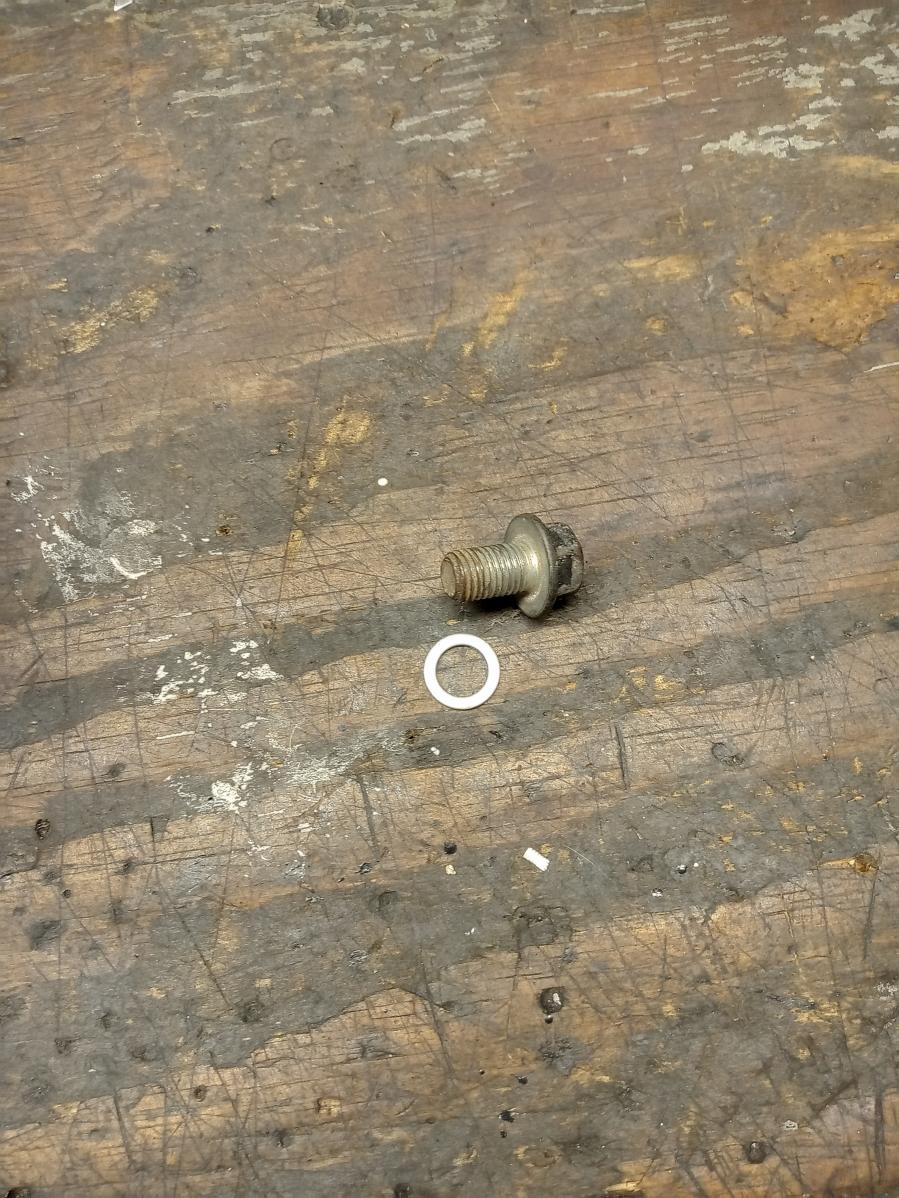

    Another option is to ditch the neutral switch altogether. I put a rear fender bolt (washer head type) with a crush washer in place of the switch. Just need to know where neutral is without a light, the old skool way. One less wire to cause problems dropping cylinders in heavy rain.
    Click image for larger version  Name:	IMG_20231008_210623.jpg Views:	0 Size:	200.1 KB ID:	875659 ​​​​​
