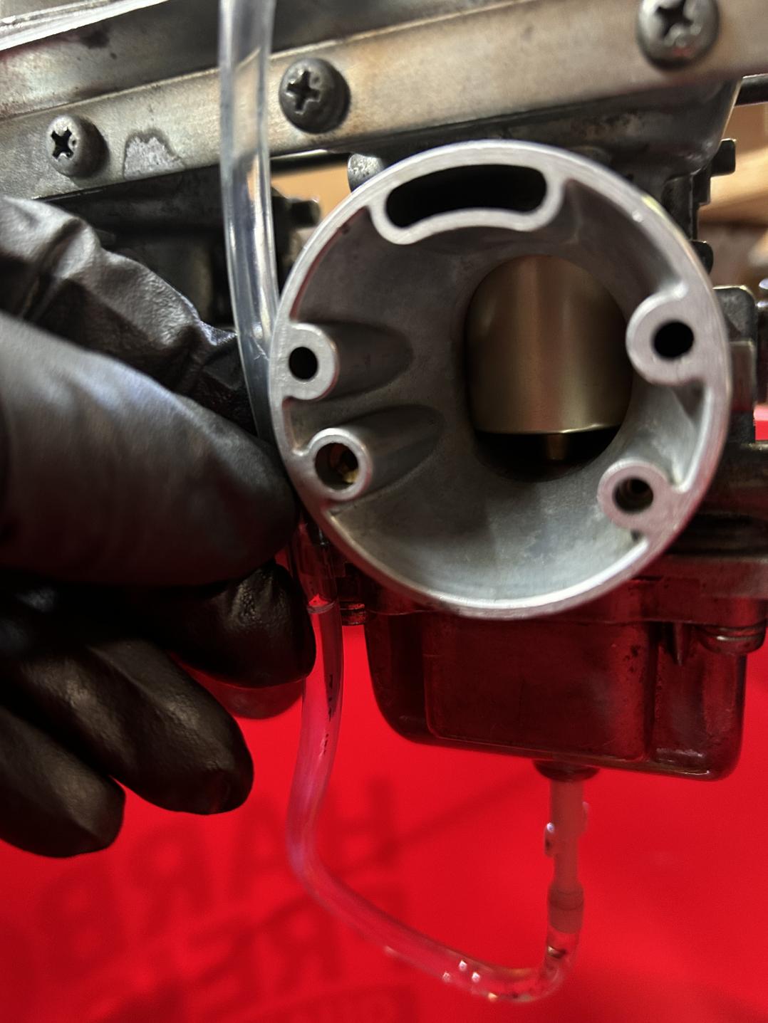

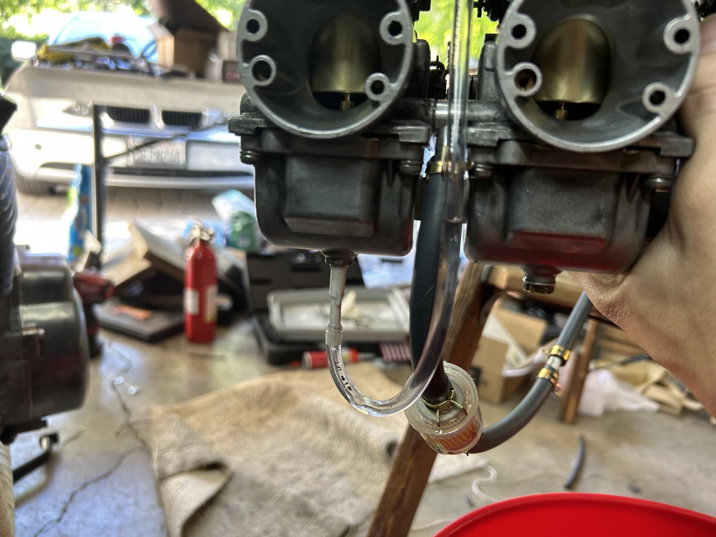

      The issues continue for me. I had it running well today after putting a 2x4 under the front tire. I think that may have been luck because then I started it later and it wouldn’t rev up with a quick throttle turn. So I thought maybe it is float height even tho I’m 99.99% sure I have it at 23mm. And also again I took off the pods and saw that gas was coming up through the emulsion tube and over flowing in the carb tunnel behind the butterfly valve. So I thought maybe I should take off the carbs again and try the clear tube method for checking the bowl level. And now I’m even more confused because it looks like the level is super low. I’ll leave a picture of what the first I had time to look at today appeared. So are the float needles that came in my rebuilt kit maybe the wrong size and the float level is not right for me because the oem float needle is different? And again I don’t know how if my float level is low than why am I getting gas coming out as well. Btw it is hard to see the gas level in the line but it is right in front of the black fuel line if you zoom in you can see where it stops

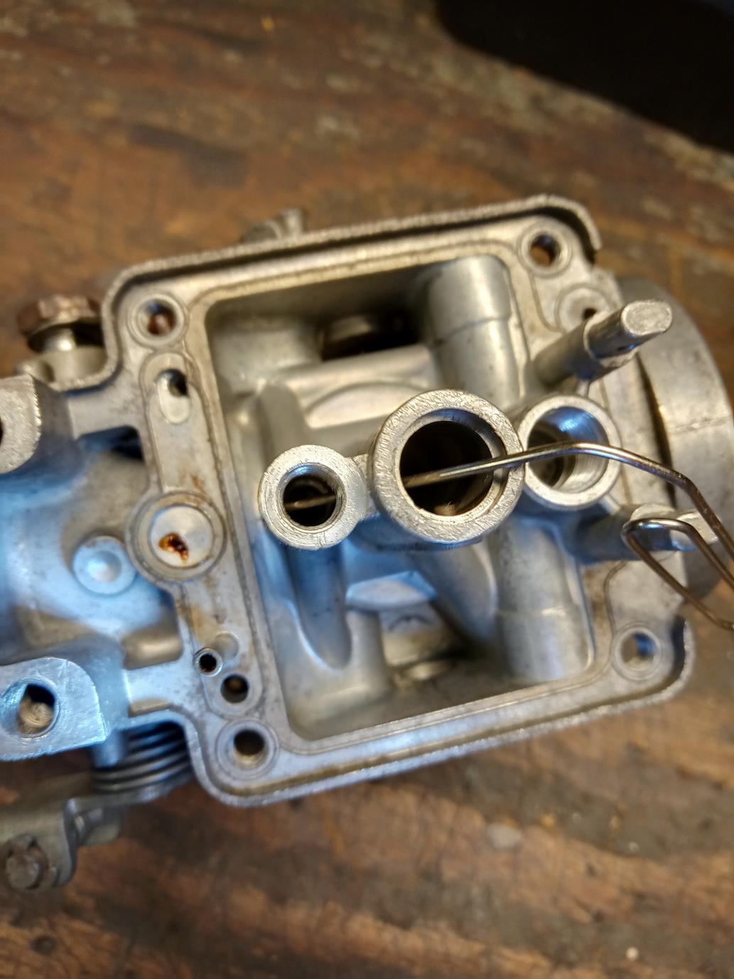

              • 8930
              Would I be able to see with a flash Light or maybe dragging a pick in there to see if there’s a hole through to the emulsion tube/main jet?

                So I went back again to check some things out
                1: I was still confused about my floats so I checked the pressure coming out of my fuel hose to the carb and it was barely any, so I took off the paper in-line filter I had and put in a mesh one I had laying around and then checked the fuel level and it was dead on. On all 4! However it did want to creep up past the correct level on a couple so I need to check the seats and the o ring. Even though they are pretty new.

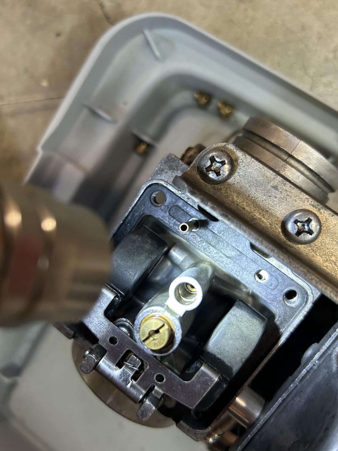

                2: I did go in and check the pilot tower on one of the carbs I was having issues with and it looks like there is no passage.I’ll leave a photo.

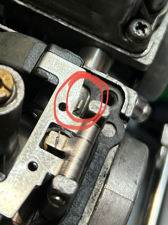

                3: I saw a YouTube video about the little tab on the float that keeps it from dropping too far when empty so I’ll mess with that too and see if that helps anything. I’ll leave photo.

                        An update:
                        When I was blowing through the straw and slowly rotating the carbs till the floats close I noticed 2 and 4 were sealing not completely and then when fully upside down it would finally seal. It turns out the angle of the floats inward and outward from the middle matters quite a bit. It’s a variable I did not think about before. So then I put the float bowls on once I was happy and checked again for leaking after slowly rotating carbs till closed. And then again different ones we’re doing the slow leak then sealing. So a couple were rubbing on the float bowls and I had to go back in and change the angles again very minimally. And then it was good with the bowls back on.
