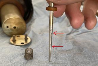

      You are running rich in the low rpm range. Check your slide needles. Might not be seated correctly. A needle that sits too high will show the same symptoms as a too-large pilot jet. They are possible riding high and letting in too much fuel at low rpms. You could also have Chinese jets and that would also cause your issue.

        I have a somewhat similar situation with my '78 but running a stock airbox, '80 carbs, and a 4-1 RC Engineering exhaust. Stock jet sizes except I'm running 110s for mains. My issue ended up being (mostly) rooted in incorrectly shimmed slide needles (thanks to DEEBS11 for setting me on the right path in my troubleshooting), but even now I'm running the idle mixture screw at only .75 turns out (!!), going to 1.0 turns out makes it obviously rich. So no idea, could be my 4-1 exhaust flows worse than a stock 4-2 or something to do with the /80 carbs being installed on a '78 with the slightly smaller intake valve size(?). Who knows, but at this point I'm happy with how the bike runs.

            Hi gtem, that last little bit of richness is caused by the wear on the sides of your needles that I showed in the photos a while back but you have effectively compensated for that issue with the mixture screws.
