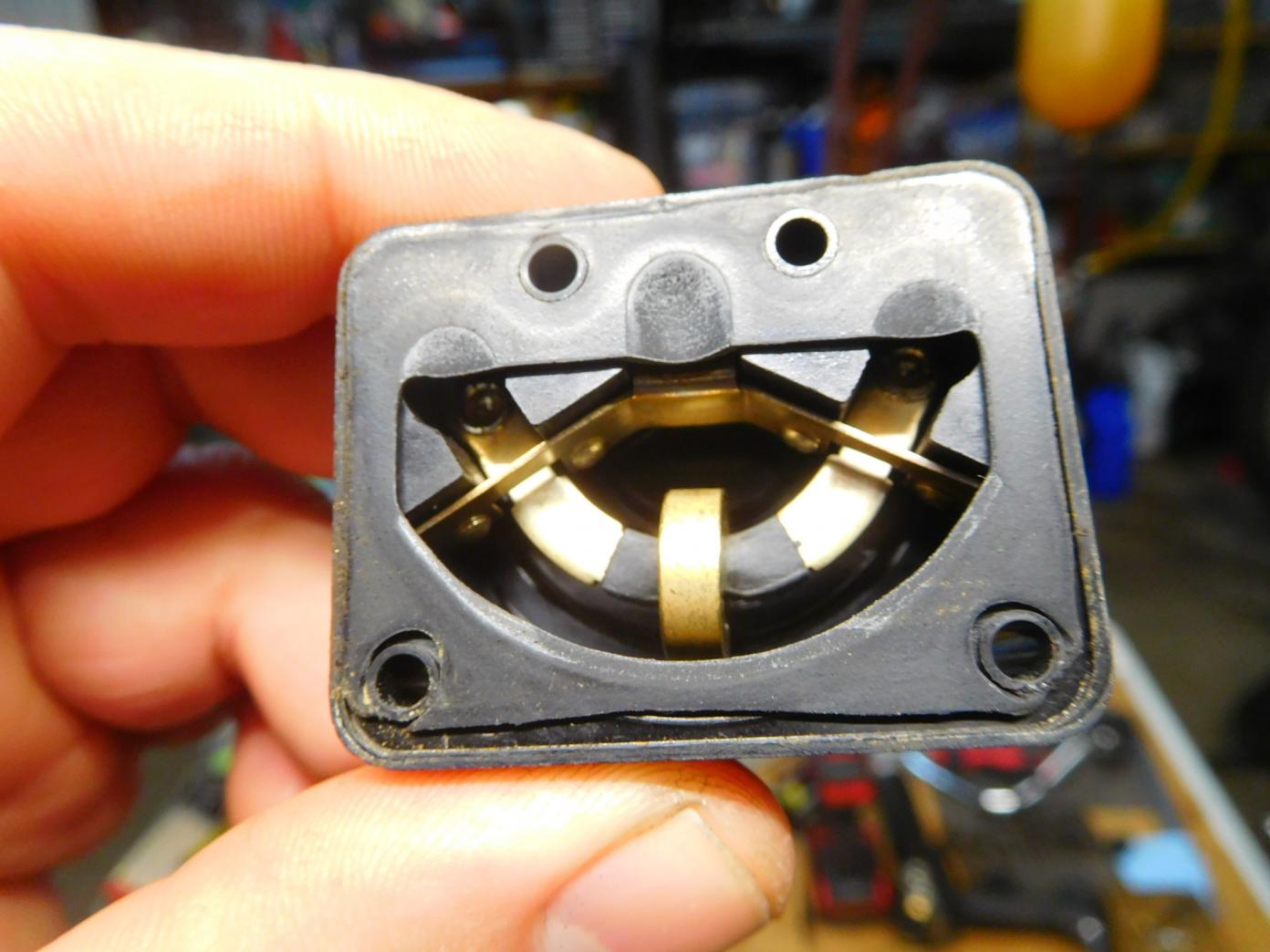

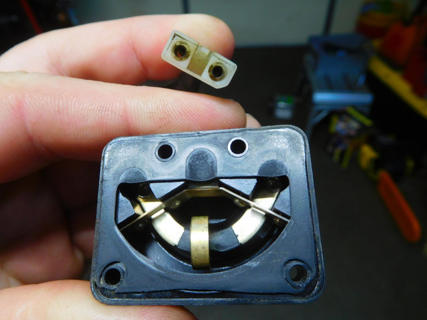

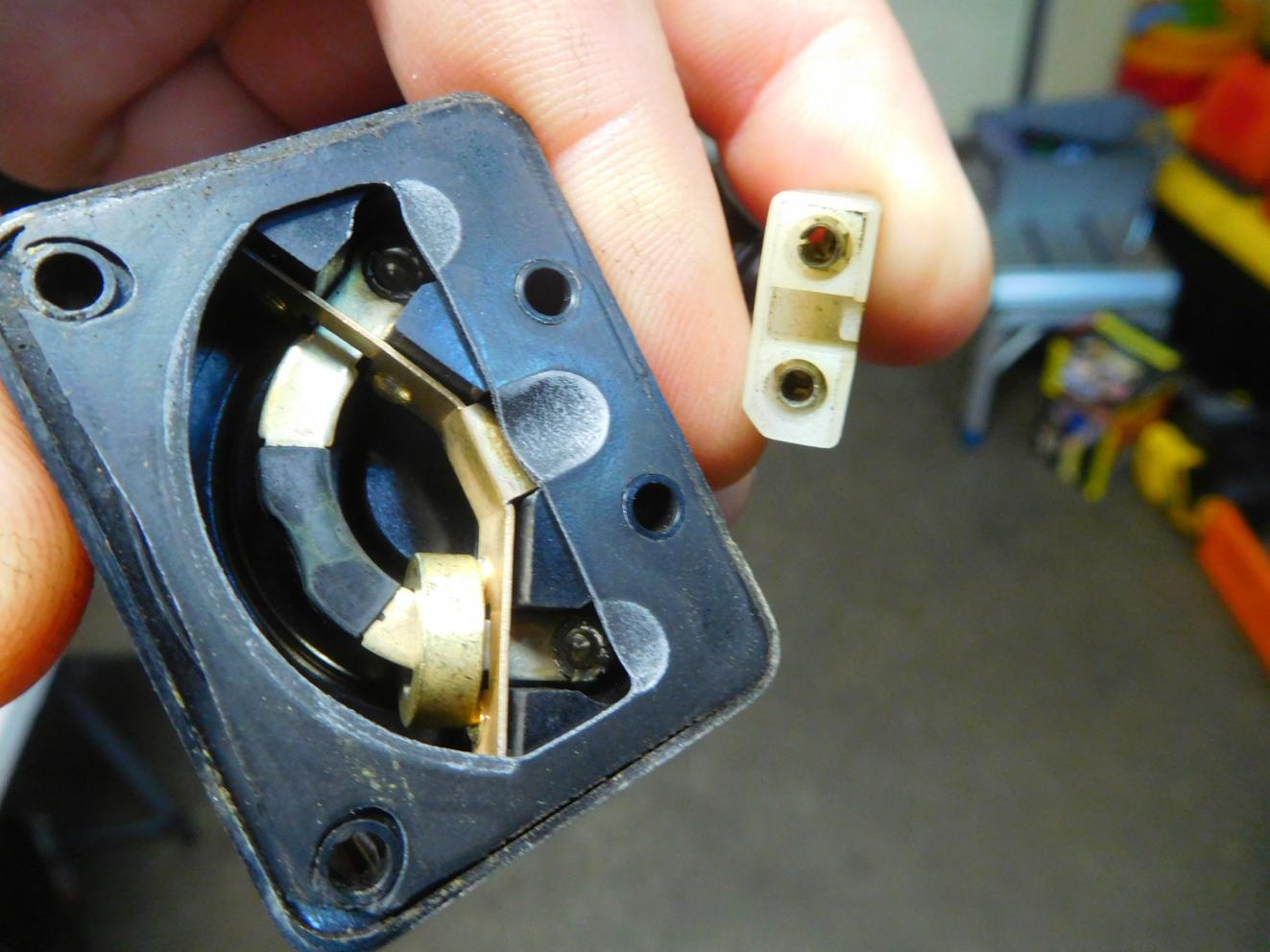

      Big Al, how did you bypass the tilt switch? Its a normally open switch. To bypass it you merely unplug it. If you shorted the wires together you killed the spark. Just make sure there is no connection between the two wires.

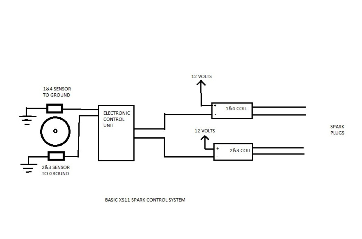

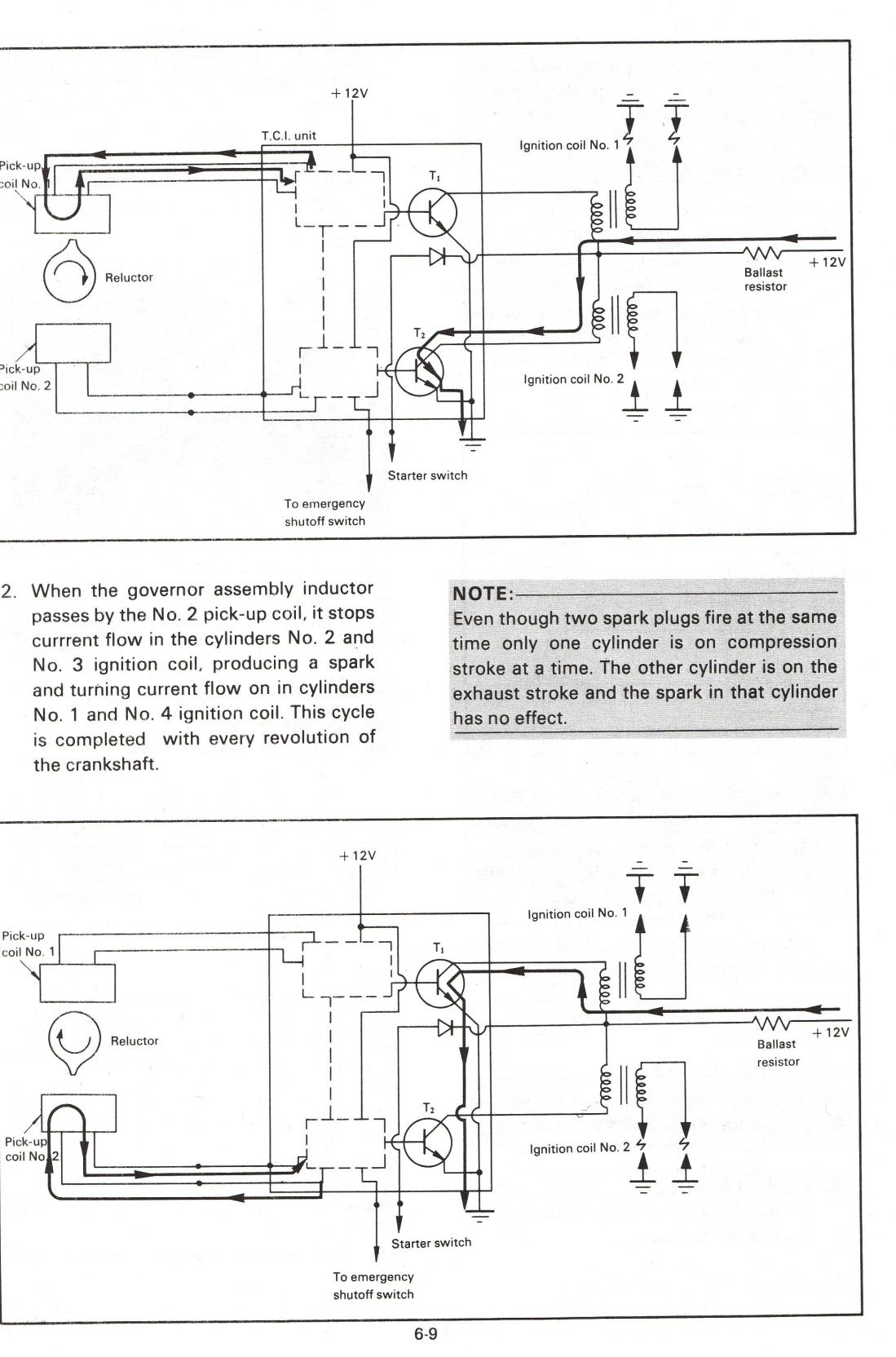

                        Al, if you have positive power to the coils the only way you can have negative to the coils to complete the circuit is through the Electronic Control Unit (ECU). The XS11 ECU takes the grounding signals from the sensors on the left side of the motor and processes the signals through to the coils just like old fashioned points. Ground a coil/complete the circuit - you get a spark. The fact that you have no spark at EITHER coil suggests at this point you either have:
                        1. 2 open coils. Unlikely unless they are counterfeit Dyna coils.
                        2. No path to ground. Sensor wires broken. A very possible common problem with XS11s.
                        3. A bad ECU. Rare but might have bad connections at terminals.
                        4. Bad frame ground. Right on top of voltage regulator.
Name:	XS11 SPARK CONTROL.jpg

                          lots of good suggestions to chase this weekend, thanks, to go back to my kill switch question. When in the run position, starter cranks.... can the switch still cause a no spark "kill" if it is faulty? Meaning the starter cranks but no spark? Thanks again
                            No AL, if the engine is cranking the switch is working 100%.

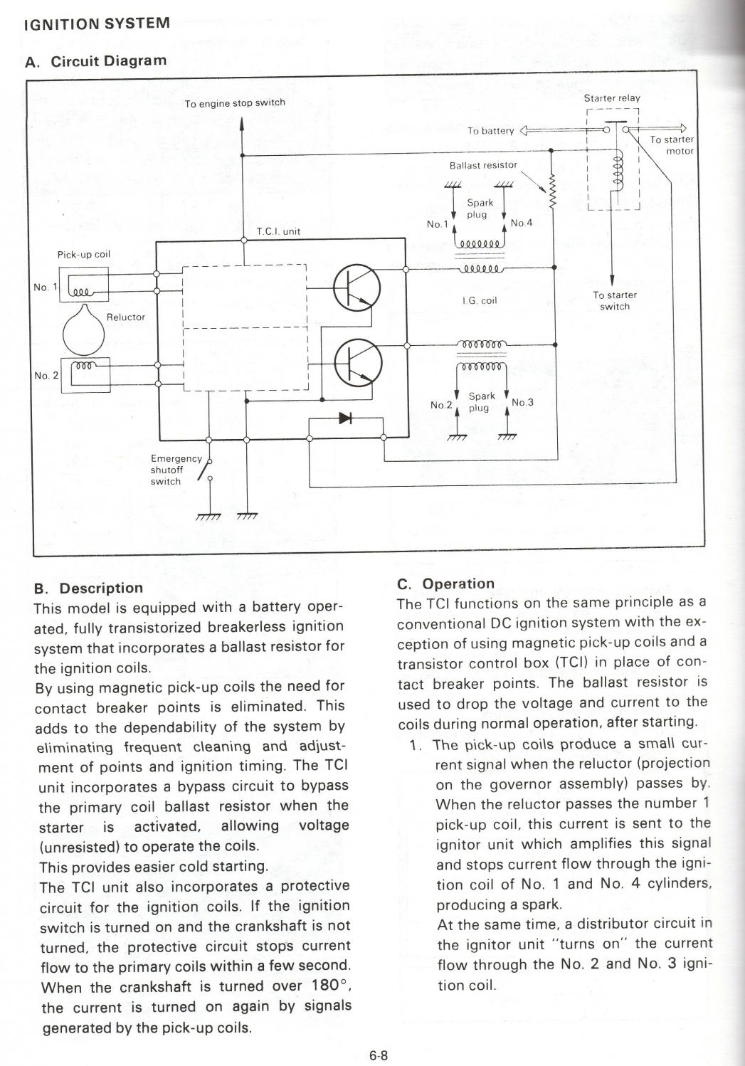

                              Here are a few pages from the manual.

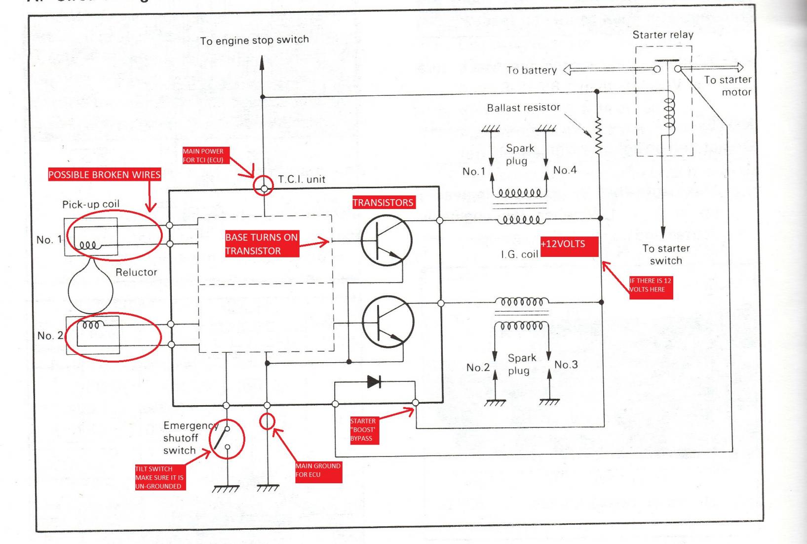

                                Here are a few areas to check that are circled. This only applies if you have no spark at BOTH coils. Bad ground, broken sensor wires, no power at ECU, or tilt switch input grounded.
