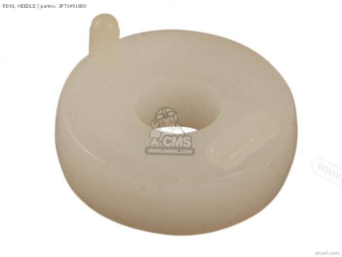

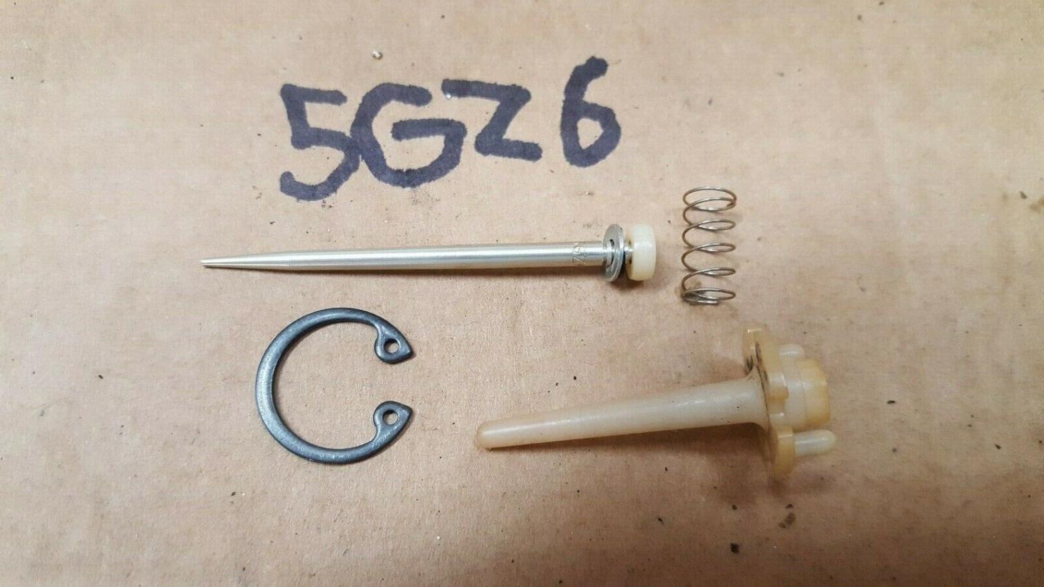

      gtem, another thing to check is jet needle position. There is a plastic washer holding the needle that has a protrusion on it. It must fit into a hole that is provided or it will sit too high and cause a rich condition off idle. Make sure the spring is also in the correct position.

        BTW the last picture does not show the position correctly. Its just to show you what the parts look like (somewhat, its a 78 part). The plastic piece fits down in the slide first. Steel washer on top of plastic. Spring on top of steel washer. Yours has screws holding down everything. Some have a circlip (early). Just make sure that needle is as low in the hole as it's supposed to go. That will prevent a rich condition.

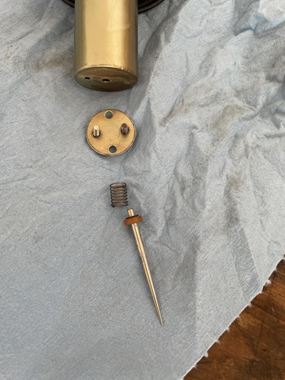

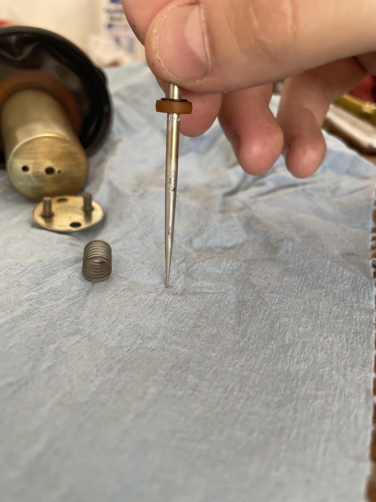

            Ok here are some close-ups of my '80 needle setup.

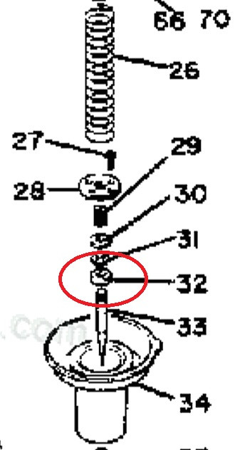

              Well, I've honed in on a *potential* problem: I'm missing the washers (#30 in diagram). Investigating the way things are sized and stacked up, it's concievable that without the washer in place to hold the spring securely against the circlip, the spring could instead by pressing along the outer edges of the plastic "donut" and the needle could conceivably push up relative to the plastic donut (and the slide), causing the low RPM rich condition!

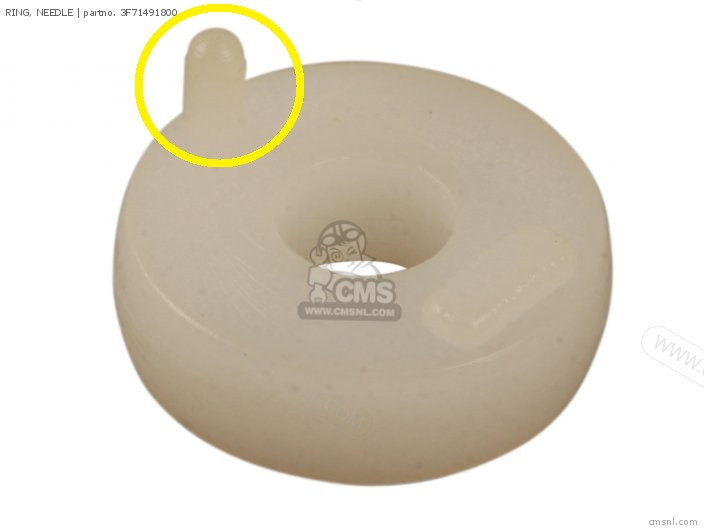

                Is that the protrusion facing up towards the circlip circled in yellow in this picture?

                  The protrusion should face down and it inserts into a small hole in the slide. Spring on top. This orientation would keep the needle as low as possible curing a rich condition just off idle.

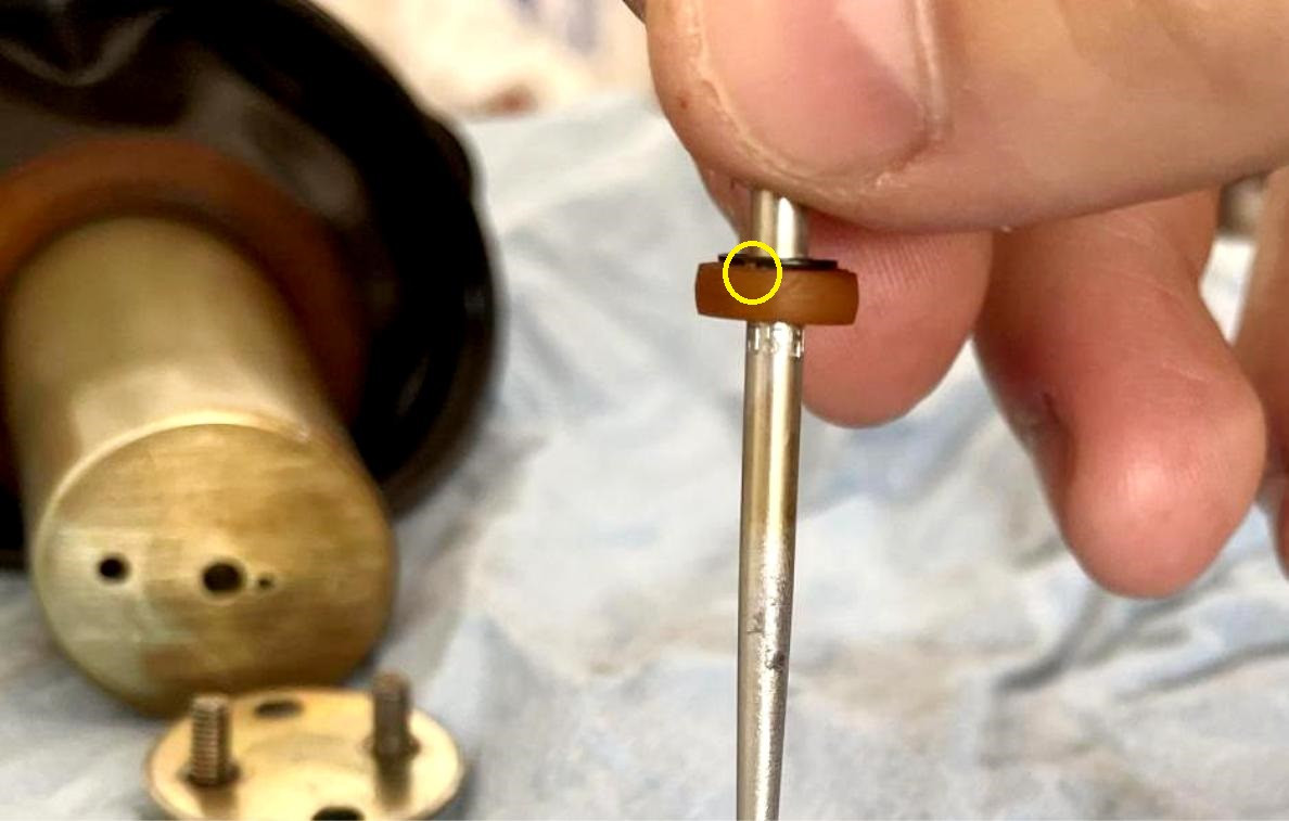

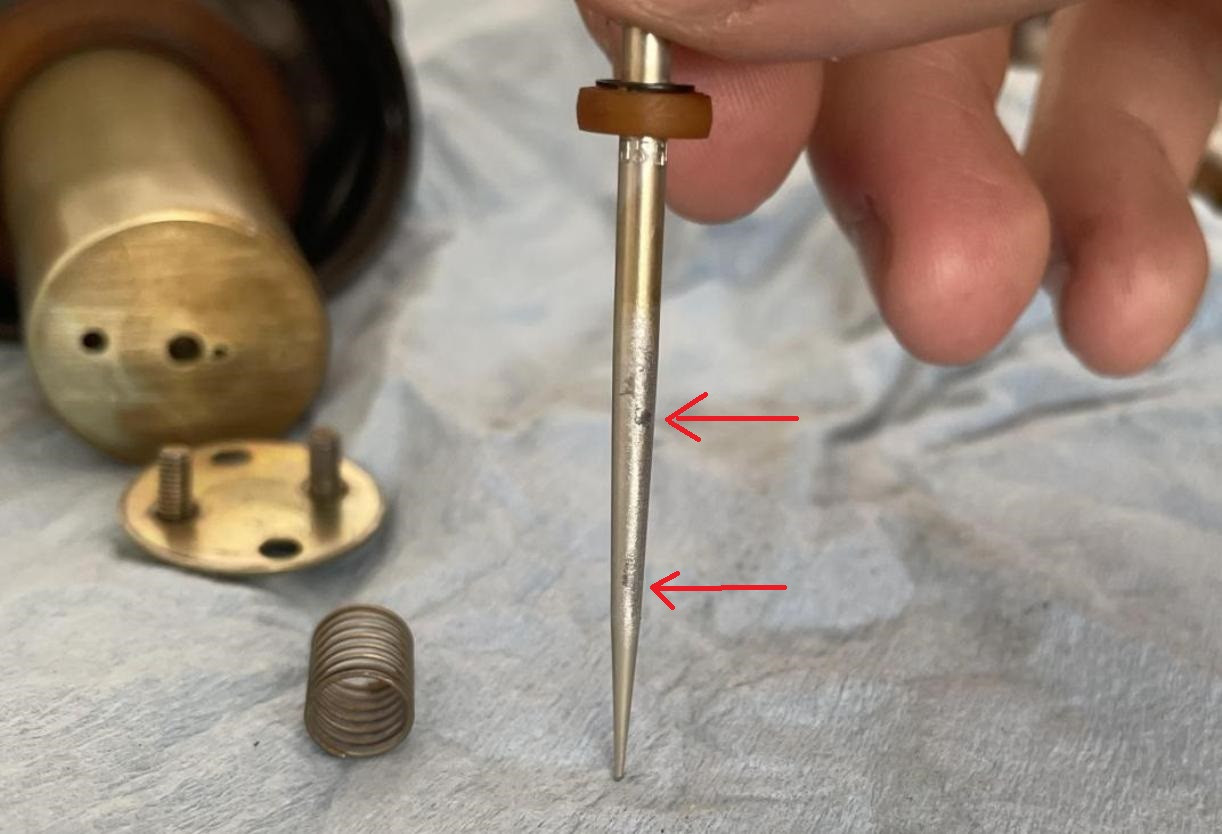

                    Another issue I see is the condition of the needle. Looks rough. Rich. Emulsion tube must be worn as well.

                      Yes I noticed the wear there as well, definitely less than ideal, not sure how tricky/expensive it might be to source a new set of correct emulsion tubes/needles (actually I wouldn't mind finding the more "linear" Venturer/Standard setup). What you have circled in red is actually just looking at an angle where the circlip opening is. My plastic "donuts" don't seem to have these protrusions at all.
