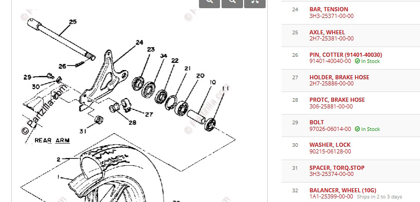

    Has anyone found a replacement for item # 31 pictured below? They are calling it a spacer. I would call it a rubber grommet. This would be for the rear brake tension bar on the specials. Thanks.
    Click image for larger version  Name:	brake bar.jpg Views:	0 Size:	85.5 KB ID:	873258

    can't say i know of one ranger !!! but im sure their will be one somewhere that'll fit.
      I was buying large electrical grommets and drilling out the center to fit, but they didn't fit well and they only lasted about 5k miles. Usually it would take a few tries to drill them successfully.
      Recently, I have been placing a garden hose washer on each side of the plate and it works better. I used the red rubber washers (not the plastic ones) that are rated for hot water.
      I can't take a picture now, but maybe next week.
        Thanks Mike, That sounds like a good option.
