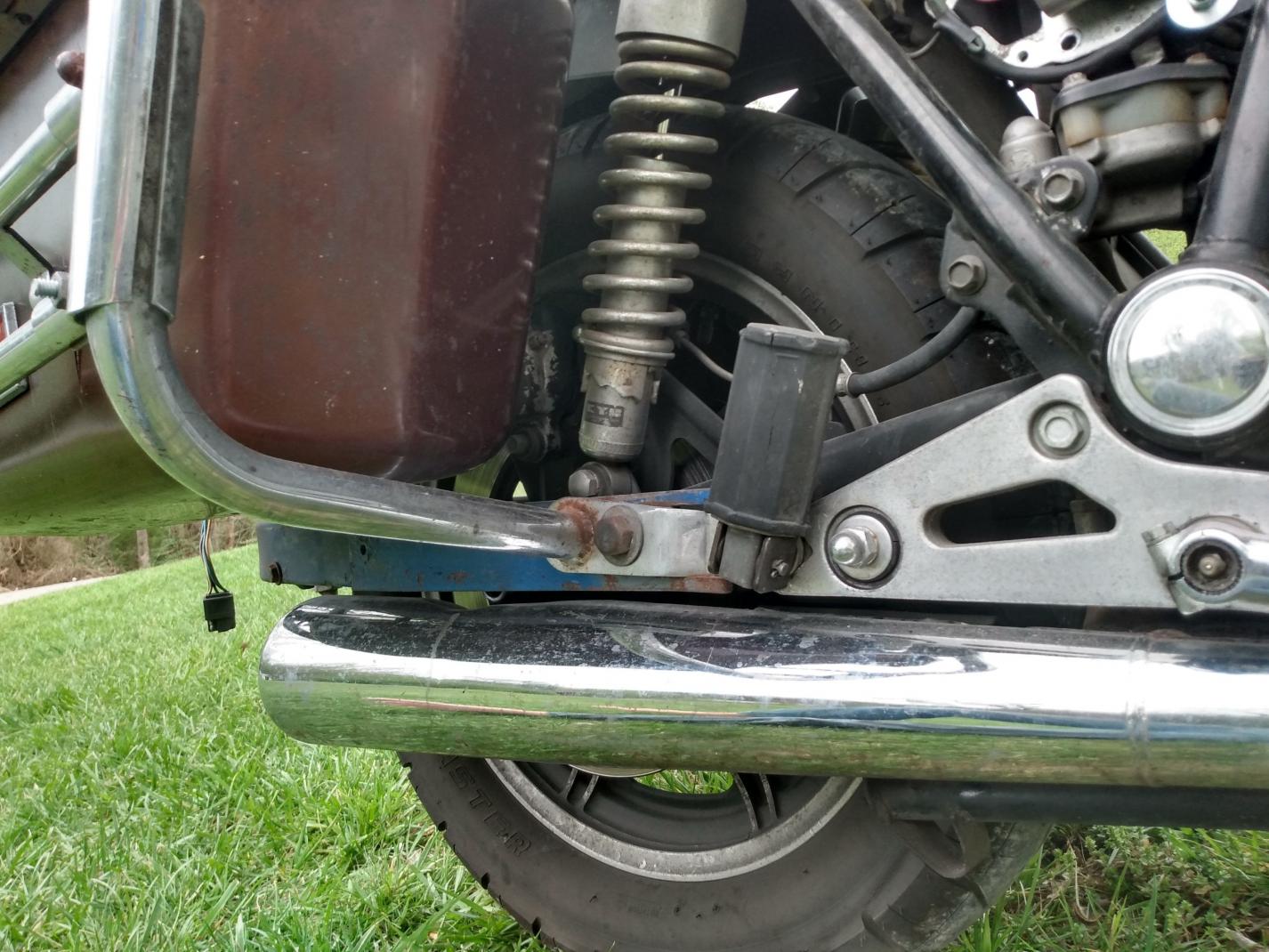

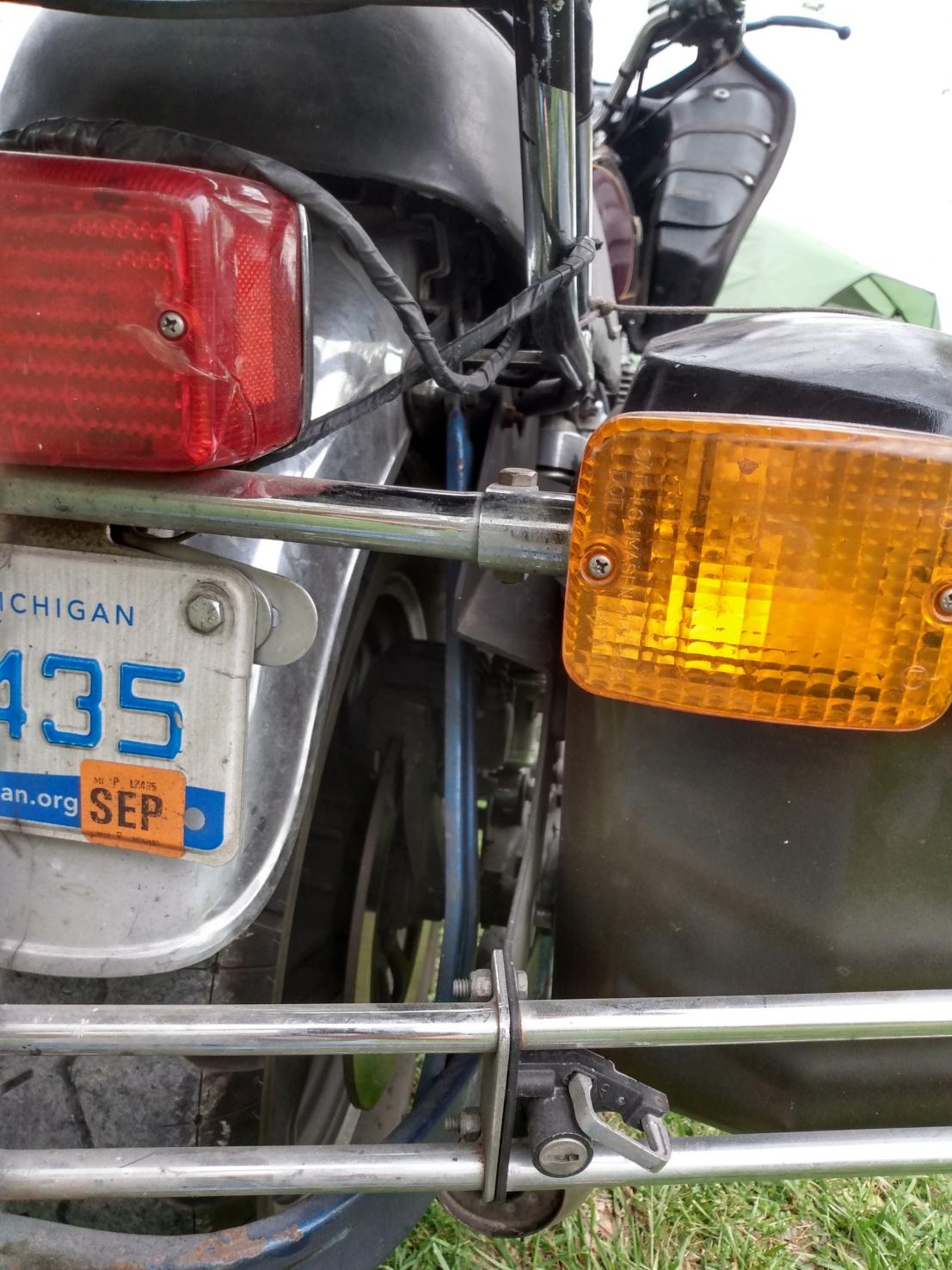

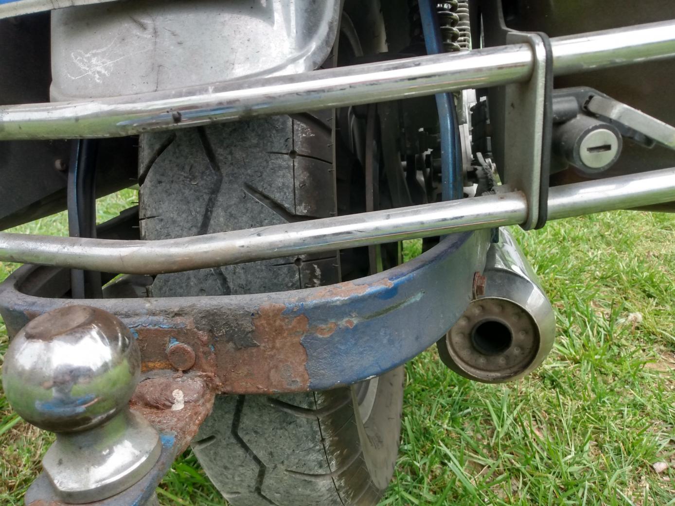

      The one on my XS was made by someone else, got it on eBay, obviously someone's home made project. It's basically a large "U" shaped piece of bent steel which bolts up to a hole drilled into the lower part of the luggage rack with two uprights that connect to the rear of the frame near the back of the seat.
      Don't see much reason why you couldn't use the rear footpeg mounts up front and a similar pair of uprights to hold the back on yours. Yes, my rear tire is almost shot and will be replaced Monday!
