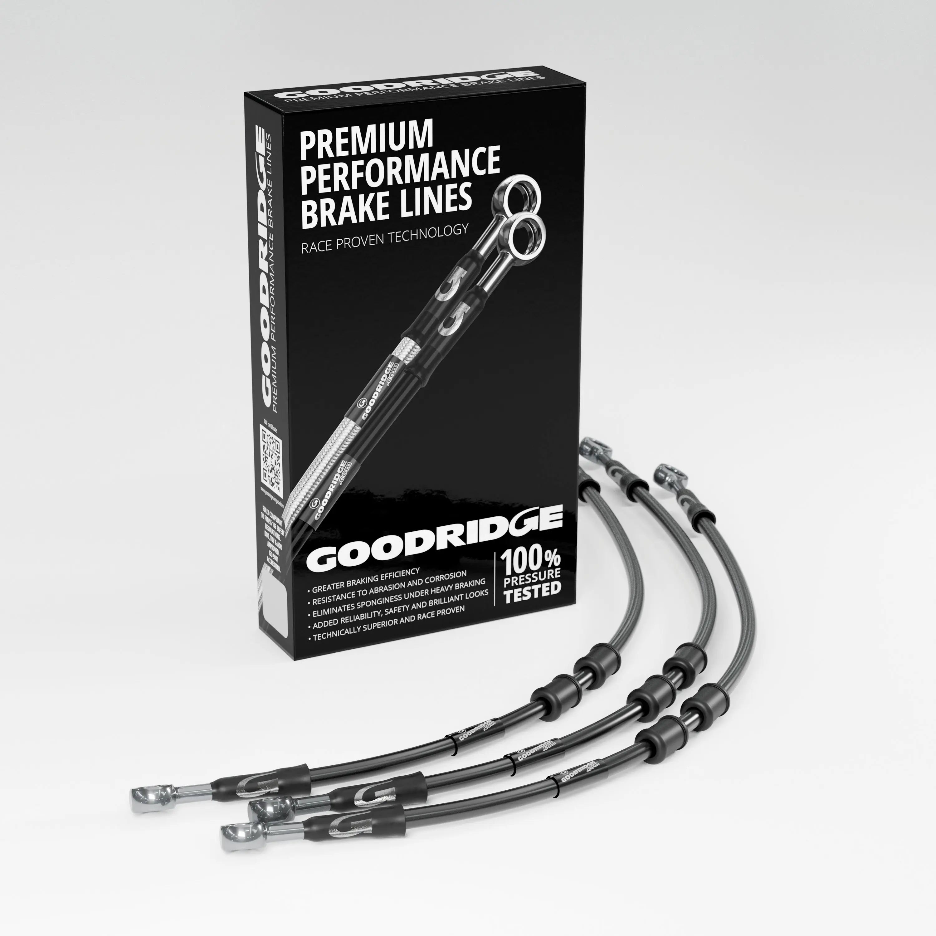

                    These bolt straight on
                    High performance stainless steel brake line kit for Yamaha XS1100 78-80. Goodridge stainless - Goodridge
