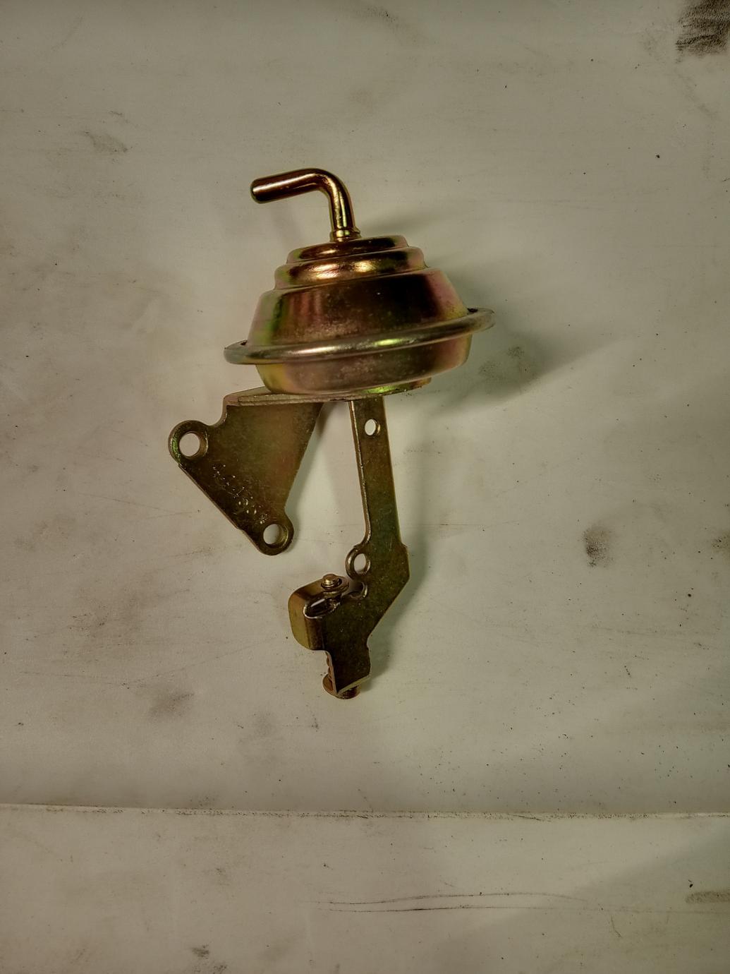

        Hey Jonathan, I've had a project on the back burner for a while now. That is to modify this vacuum break I have here. It's intended for an Olds with Quadrajet carb. It has plenty of travel which would need to be limited. It will just barely will fit under the side cover. Click image for larger version  Name:	IMG_20230306_203752~2.jpg Views:	0 Size:	92.0 KB ID:	872638
        It may not be the best candidate. I did modify one years ago from a Cadillac carburetor which was smaller and got it to work until I found a proper one.

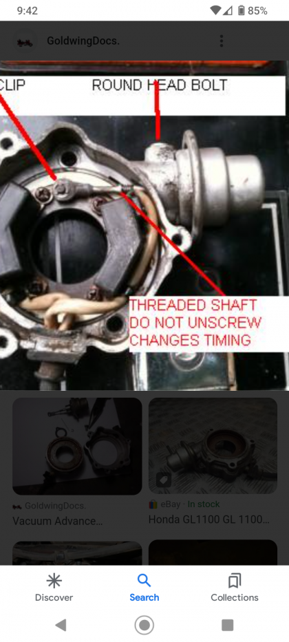

        I may be wrong but I believe the XS11 is the only bike with a mechanical vacuum advance.
          My 1983 Goldwing had one
            That is good to know. Thank you.
