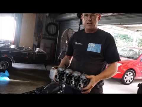

                      Carburetor remove/install, simple.

                          The barefoot aussie helped.

                            I took the bracket off the top of the air filter and the parts fell out. I had to take the whole thing apart to get it right. The Aussie muscled it.
                            Then the throttle cable kinked and wasn't right. Then it got dark.
                            I should get it working good today.
