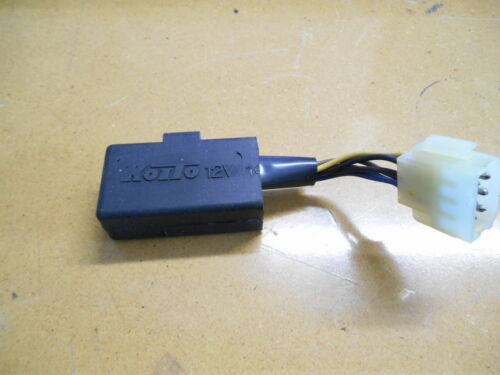

    having an issue with my 1979 SF, finally got the motor running but the oil light is permanently on !!!! I disconnected the wire from the pressure switch but stays on. by the way i checked the switch and its faulty so bought a genuine new one. with the wire disconnected the oil light should go out till its grounded but it doesn't. anyone had the same problem ? ive checked every connection but found nothing.
    • 8891
    The SF has a light checker unit under the left side panel or under the seat. If the plug connections are flaky, it will illuminate the oil light which serves double duty as a warning light for a burnt out tail light bulb. Try wiggling the wires going to it with the key on and see if the oil light flickers. If the unit itself is bad, it can be easily bypassed.
    To bypass, unplug the unit and jump the blue/yellow and the blue wires in the bike's harness.

      thanks Phil i'll give it a go, cheers

        thats fixed it, cheers Phil. now onto the other jobs.
