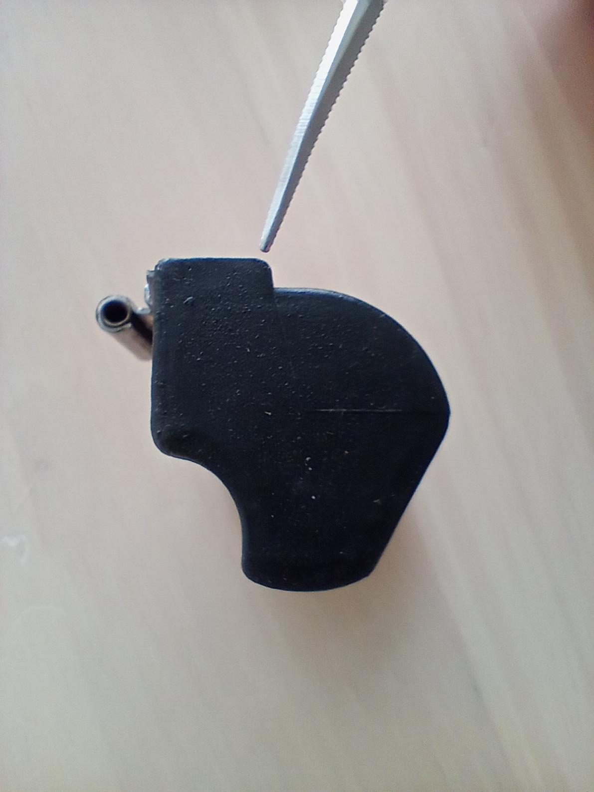

    It's 25 not .25 and I think that is the correct float height. Measure from the top of the float to the gasket surface, no gasket in place. If you suspect electrical you can swap spark plugs 1 & 4. And check the pipes. If no change, swap plug wires 1 & 4. And check the pipes. If you have the original coils you might want to consider replacing them.
    79 SF parts bike.
      The correct float height for the 80 carbs with the plastic floats is 23MM (29/32") measured from the bowl gasket surface, gasket removed. The manual states to use the clear tubing method for the 81-82 models, but I have found that measuring to this area of the float is extremely accurate and totally acceptable.

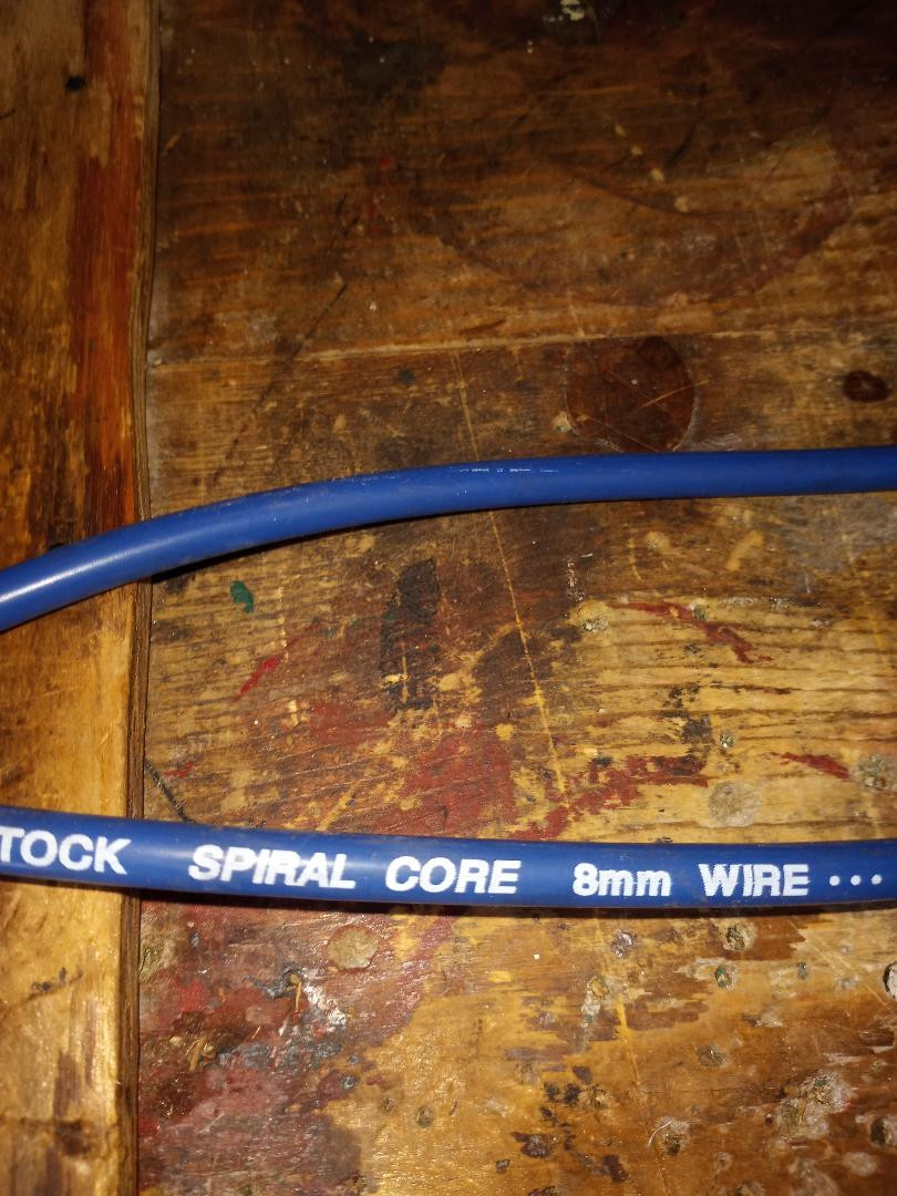

                I put the other coil on today and all 4 pipes are hot now.
                  • 2117
                  Here is the coil
                    • 2117
                    For those who have done this coil mod-you need to have the terminal stud that is on certain NGK sparkplugs which is what I run. I know the stock coils don't need this part attached.
