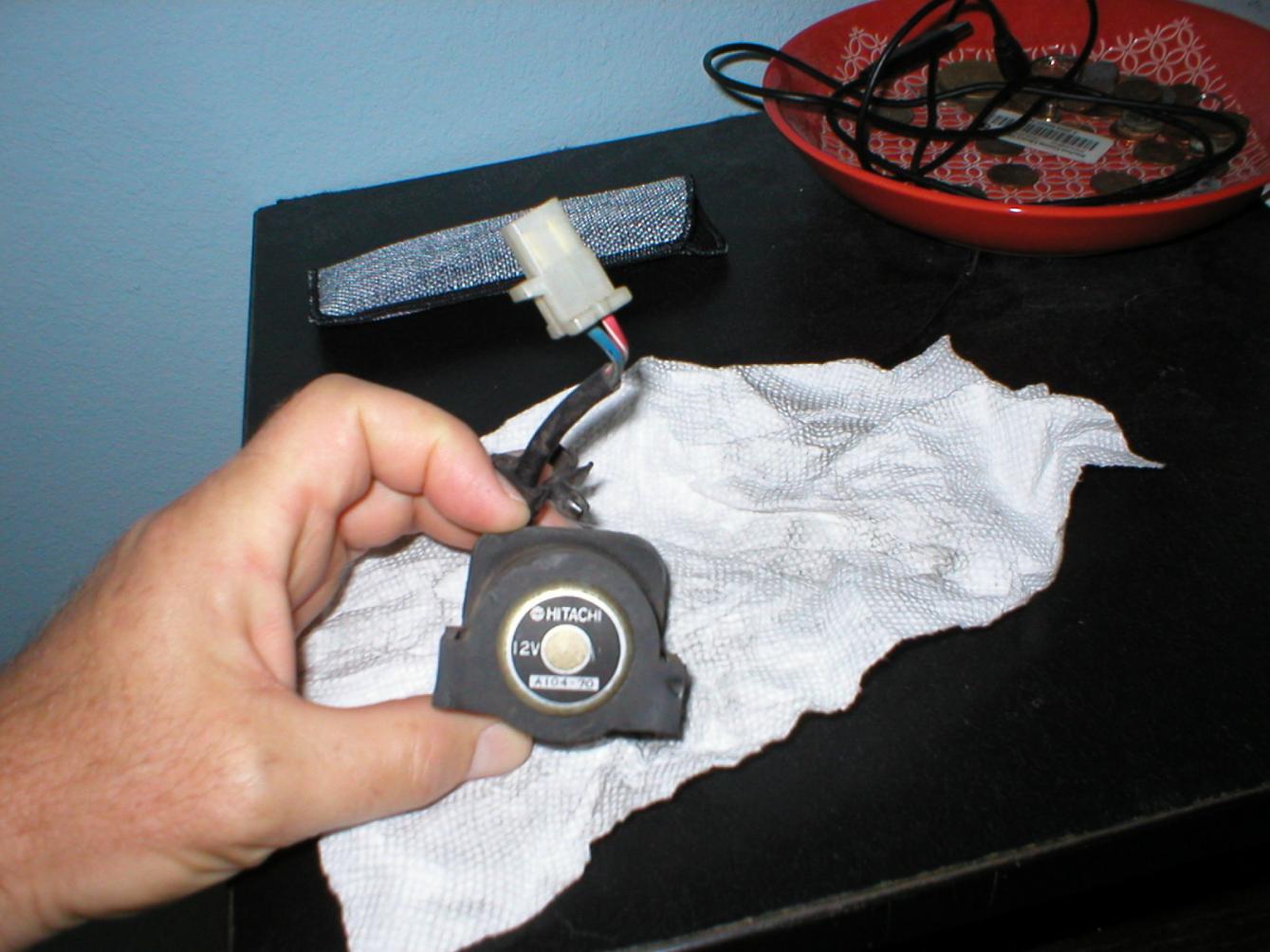

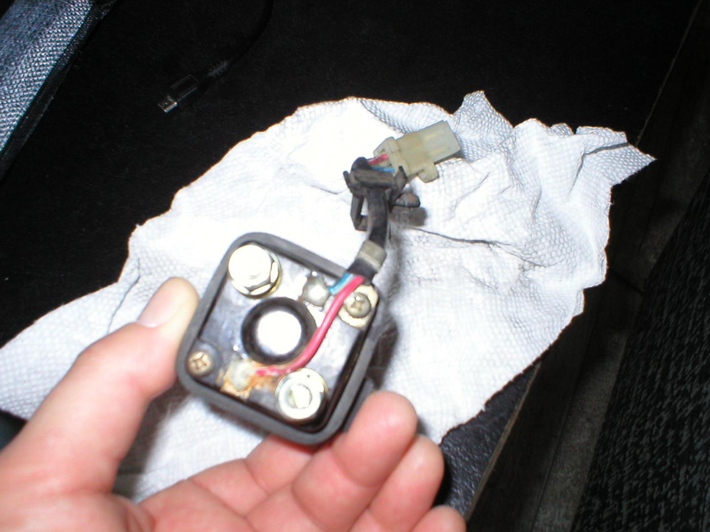

    bike won't start
    This thing clicks. Click image for larger version

        looks like starter relay solenoid

          It’s the starter solenoid. Test by looking for battery on the side not cabled to the battery when you hit the start button. Jeff
          Jeff Korn
          Original Owner 79XS1100 E
            yes, it is the starter relay. When it clicks, it is trying to send battery voltage to the starter. Is the starter cranking the engine? If so, the relay/solenoid is working. A weak or dead battery may supply enough voltage to make the relay click, but not enough to turn the starter.

              It was the starter motor. fixed

                I asked the bike shop to test the solenoid. He said it was probably good and told me to cross the posts after installing. If it sparks the starter is ****ed, if nothing the starter is bad, if it starts the solenoid is bad or a ground wire.
                Mine did nothing. I had another starter put it in and it starts. Good to go.
