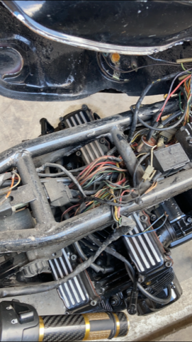

                      A couple of pictures, this is how I bought it like one month ago:
                        OK, you do have a good start. Real brakes on the front, and I see any wire harness will work, as it will need a lot of mods to get things working. Don't worry about what year/model the harness is from. Plan on pulling the cover off the harness, except for the engine section, so you can put required parts in locations you want them. Pickup coil wires from left side, Alt wires from right side of engine. Alt is two large connectors that go to the right sidecover of bike, pickup coils join with neutral switch wire from left side, and end up behind right side cover as well. Hope this gives you a start!

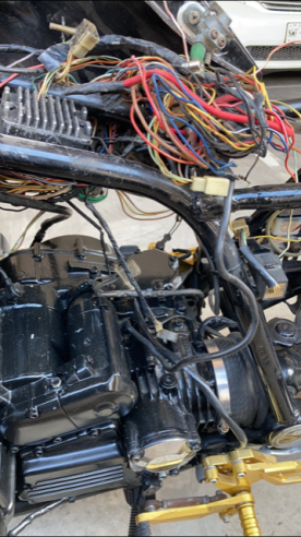

                          Hi, this is the CDI (plus some extra parts) I bought, now I don't have more pitures but it says 2H7, I'm thinking about buying the harness at spanish link, do you think there will be a way to put them togther working?
                          PS: I also attached some pictures of the disastrous situation under the tank
                            It looks like the PO already has all the wire harness open. You may be able to use what is there, and get the bike running. Download the wire diagram for the bike and start matching wire colors to function. Label each wire so you know how they did go, and you should then be able to connect what you need to make sure it runs. The ballast resistor, silver metal thing with two red/white wires, will need to be installed as you have the stock coils. If you install 3 Ohm aftermarket coils you can bypass the resistor. That will be later, though. Main thing you want to do is connect power to key switch, kill switch, and pickup coils/TCI box. Let me know if you have questions with it, and I'll try to see if I still have some documents that may help you.
