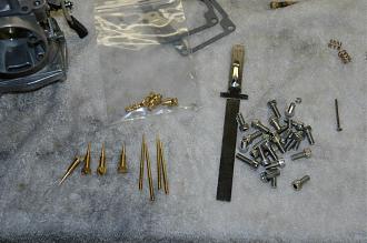

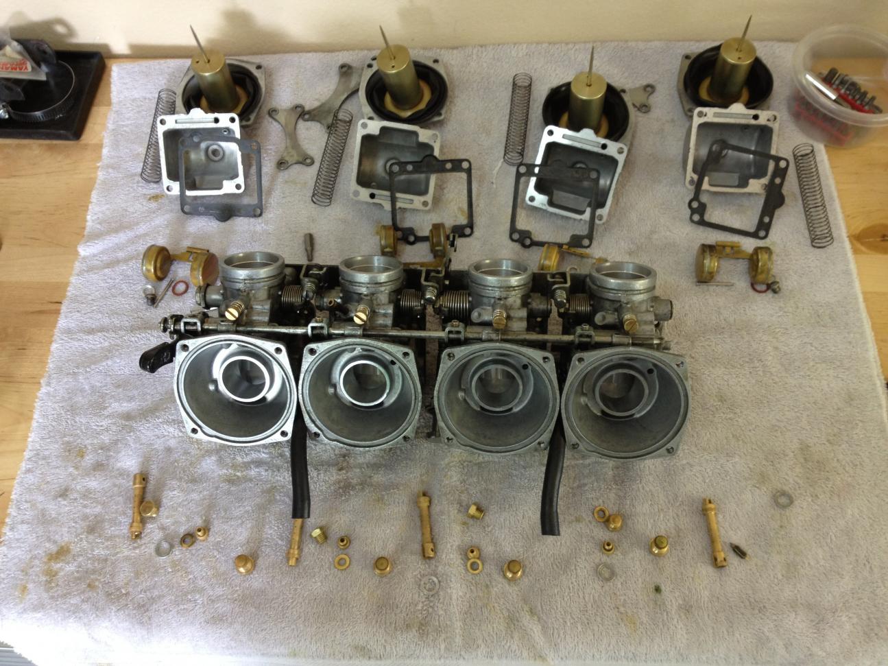

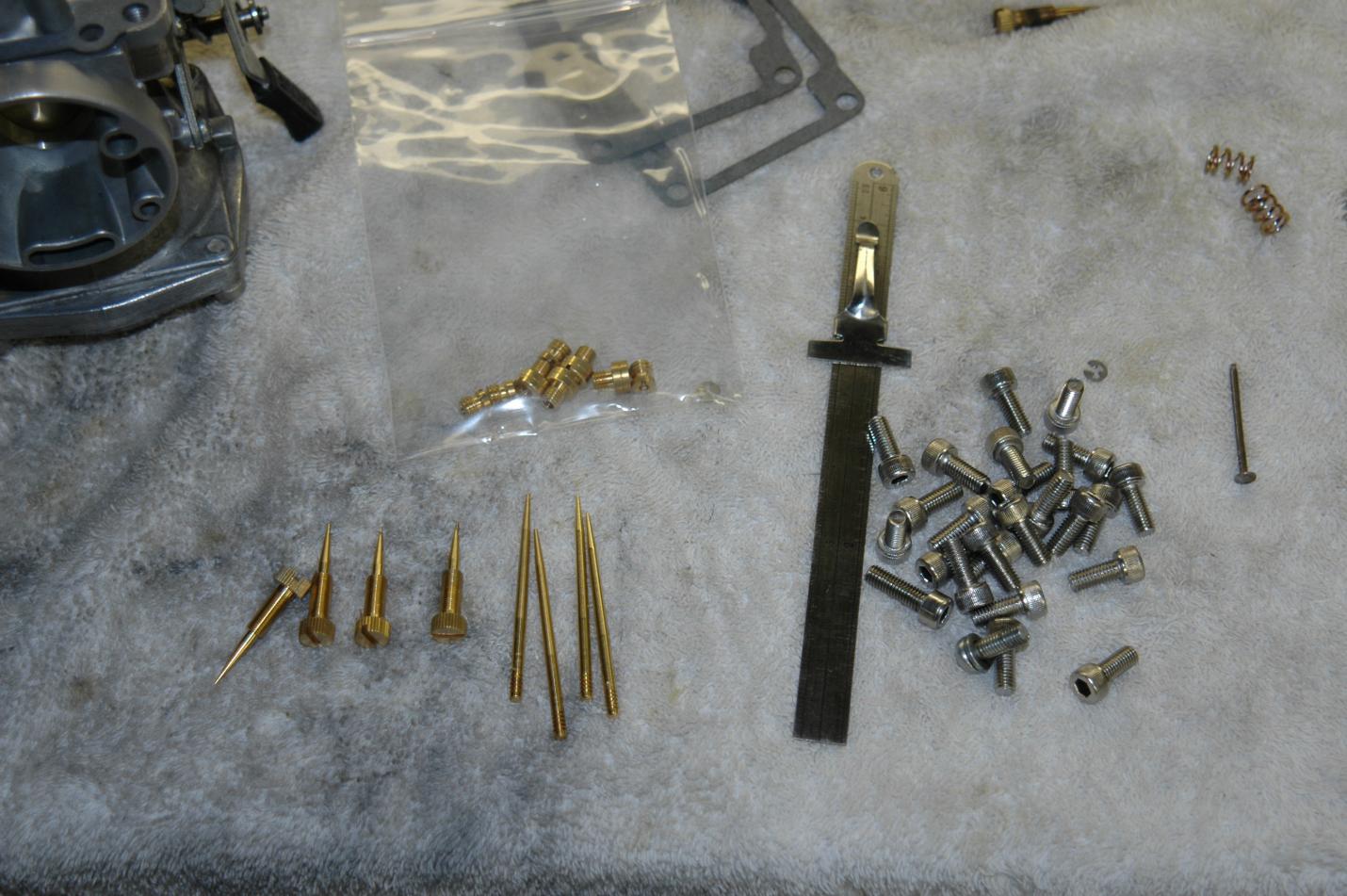

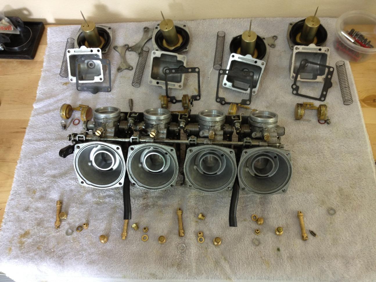

    I would start with a complete carb rebuild. there are several places where you can get kits for that. Lay everything out and do not mix parts from one carb to another. Stock main jets are 137.5 I replaced the with 140. Make sure float height is correct. Verify which notch the main needles are set al. Clean the hell our of all the really small passages inside the carbs. Finally synch them. Jeff.. Click image for larger version
ID:	867213 Click image for larger version
    Jeff Korn
    Original Owner 79XS1100 E
      That bike is an SF, not an F. The Vin should start with 3H3, not 2H7.
        And you are running lean, by the header pipes changing colors. Jeff gave you a good starting point on the carbs, and I would go to brakes next. Running is great, but stopping is better!
            Is it best to contact Mikuni for this? I have already rebuilt and cleaned the hell out of everything, but I did not swap the emulsion or diaphragm (all the rubber was in great shape). Probably could use another run through now from sitting, but even when all was fresh I had the same issues.

                    so... you have a 79 standard frame and a 79 special engine. Do your carbs look like those that Jeff posted? By the way I agree with Jeff on cleaning the carbs regardless of what year you have. An ultrasonic cleaner would help. From the symptoms you described on how the bike ran I would suspect carbs. When you rebuilt them what kind of kits did you use and did you replace all the jets with the kits? If you did then you would be better off with Mikuni jets which are available from JetsRus. If you can post pictures of the carbs. When you went through the brakes did you completely disassemble the master cylinders and verify all the seals were good?
                    • jdub89
                      • Dec 2020
                      • 21
                      I will look into the carbs again. Don't remember the kits, but i do seem to remember jets being replaced. Only items not replaced were floats, emulsion tubes and diaphragms. I will try to get some pics of the carbs within the next few days. Not only did I disassemble and clean the front and rear MC, but i replaced all the seals. I also rebuilt front and rear calipers.
                        Did you keep the "old parts" when you rebuilt the carbs? If so, clean them up and put those back in to start. The needle and seat should be OK, but I have had problems with some K&L kits with them not sealing properly. The K&L Jets ARE sized wrong, and make trying to tune the bike a nightmare!
                        • jdub89
                          • Dec 2020
                          • 21
                          I believe I do have the old parts stored away but they mixed now and I've always read to keep the parts in the same carb. Is there a source to buy new Mikuni kits? I would hate to put those back in only to start over for a 3rd or 4th time. I'd like to just get this done right so I can enjoy it.
                            You should get new Mikuni needle/seats for the carbs. The old jets can be cleaned and re-used, and it does not matter what carb they came out of. Check the main jet size, and go up one with Mikuni only jets, for pipes you have. The stock pilot jets should work. Be SURE and put in the factory needle in the slide!! Aftermarket ones are almost impossible to tune correctly.
