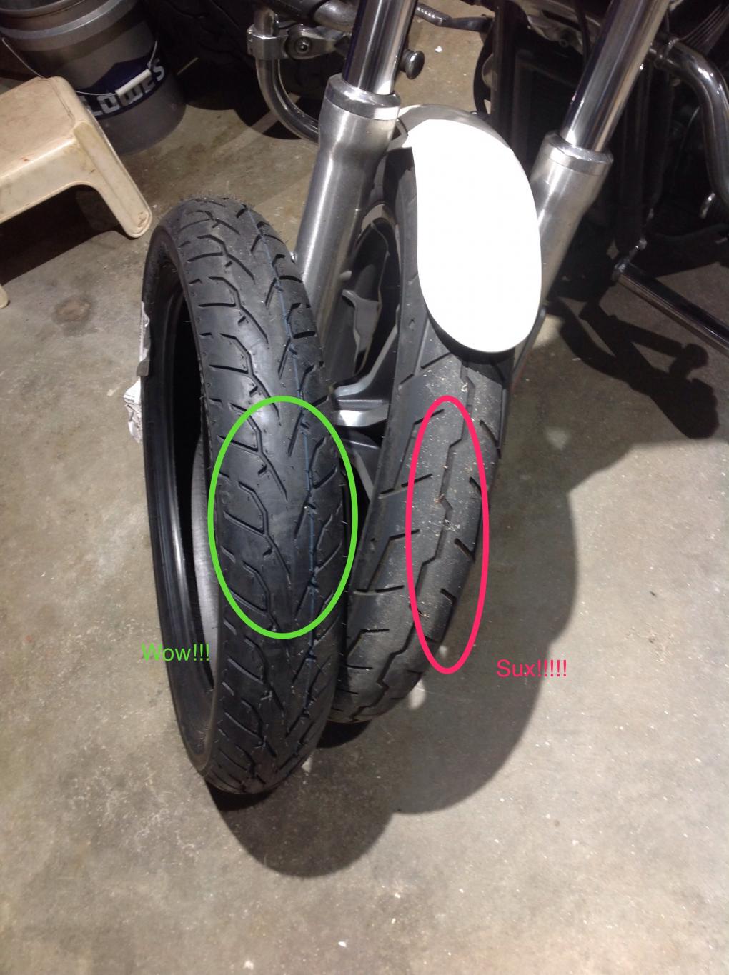

      Unable to tell for sure with your described symptoms being 3K miles away but any motorcycle front tire with a center line groove will feedback road surface issues to the bars, even heavy bikes. Front tires with a herringbone pattern eliminate/minimize this effect. This is why I buy Pirelli Night Dragons........
      Bax
      • Bax
        • 344
        • Merrimack, NH
        Pic. I know, I know, it's for the FXLR on the XS site but it was too convienient as I had both tread type tires sitting there.......
        ---Bax
