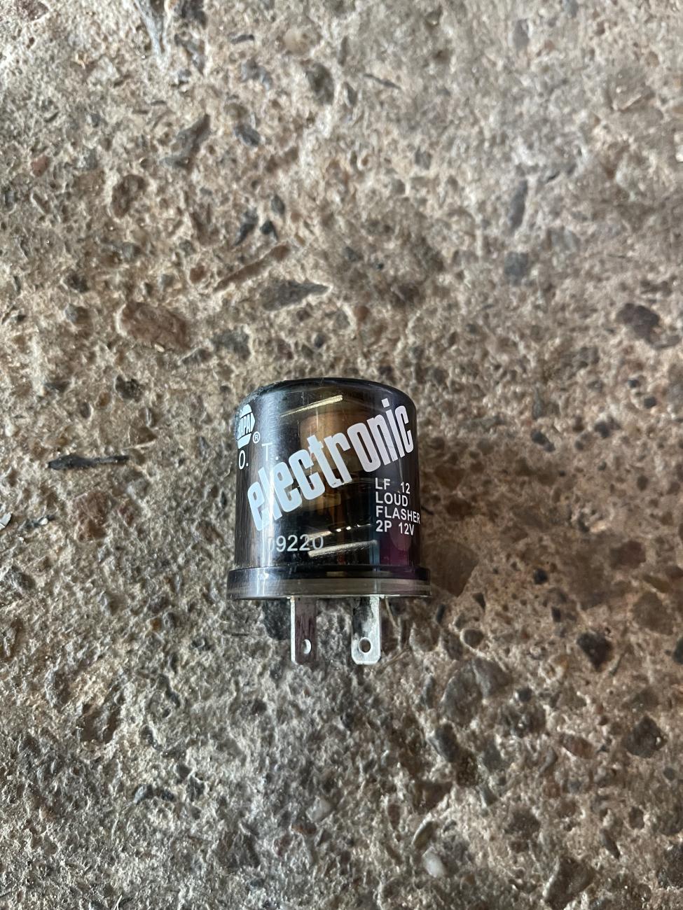

                  Update: hooked the new rear LED’s up. They flash, just as weak as the other bulbs did. But now, the fronts don’t work at all. They’ll flash quickly once, then die. The left indicator in the speedo comes on regardless of which direction I push. I’m going to end up wasting a rare 4 days in a row off just trying to get these to work, when I planned on riding. WHY WILL THESE NOT WORK.
                  Again - I’m using new led signals from revival cycles in the rear, stock flashers with led bulbs in the front.
                  here’s the flasher I’m using…would this have anything to do with it??
